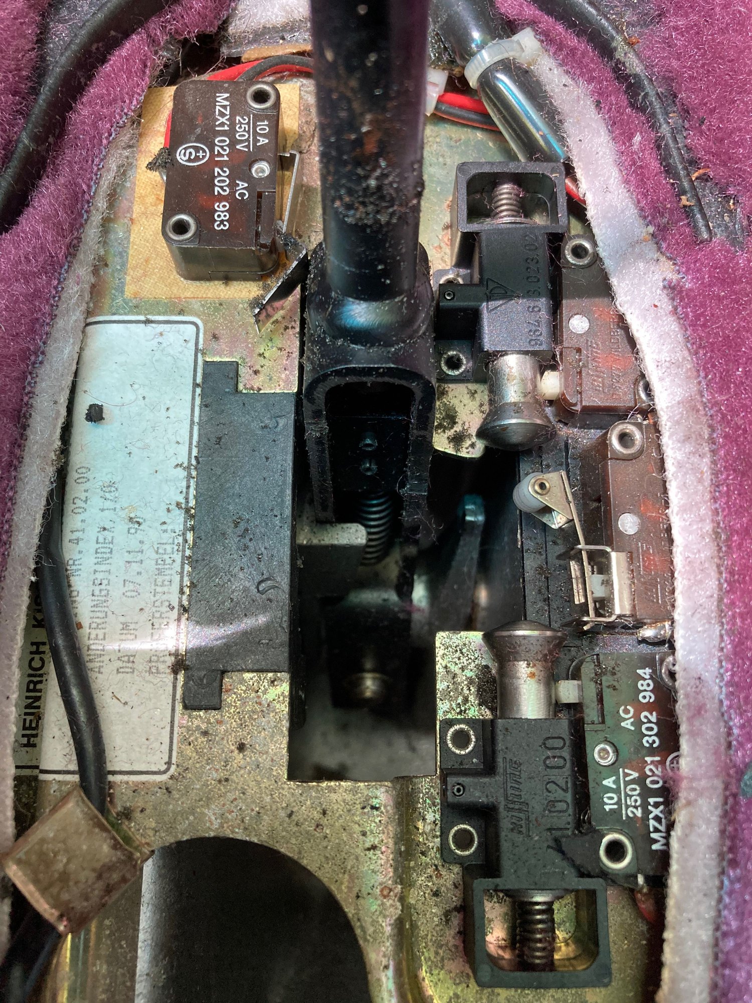

If it's good in auto mode...........but not manual.........maybe check the micro-switches under the selector cover. Three micro-switches for manual mode. One to switch to manual one each for changing up or down a gear.
Old May 7, 2021 | 10:42 AM
cjoenck's Avatar
cjoenck
Joined: Dec 2007
Posts: 978
Likes: 182
From: Chicago, IL
Mine had a lot of dust / dirt / crud on them. They just needed a bit of cleaning. Agree, this sounds like an electrical issue if oil is fresh...

ok, So I picked up the car last night and drove it across Florida today. Tiptronic function did not work properly at all. I'm not sure what my mechanic was referring to, or this is completely intermittent or yesterday was the last time it worked like it should. I can get it to shift manually through the gears using the 1-2-3-D positions, so I think this has to be a switching or control function. I'm thinking TCU module is toast. It seems to shift properly if left in D, but I am not yet sure. I didn't give it much time in D. Mostly tried manual function.
I still need to have the fluid changed. So that will be next. Would be nice if the TCU could be tested.

The "TCU" will throw error codes that can be read with your scanner of choice. Since it is working in D mode, I don't think it is the control unit. You should check the micro switches first. Btw, you can unscrew the push button on the shift **** and then pull the know off. If memory serves me right, it's just friction holding it. Next, take the center console off and the whole mechanism is exposed. Easy. A good cleaning will be in order since all kinds of crud will have accumulated.

I have removed the console and found it has been done before and slightly broken. Not terrible. Here are the switches for tiptronic. They look to be operating properly, but a little dirty. Without specific electrical contact cleaner what would you recommend for cleaning? Also, the switch in the neutral position, appears to place the car in manual mode, is mounted at a slight angle. Is this normal?
