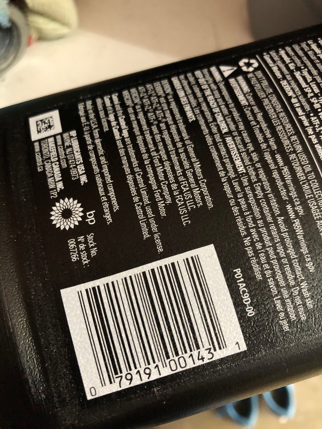

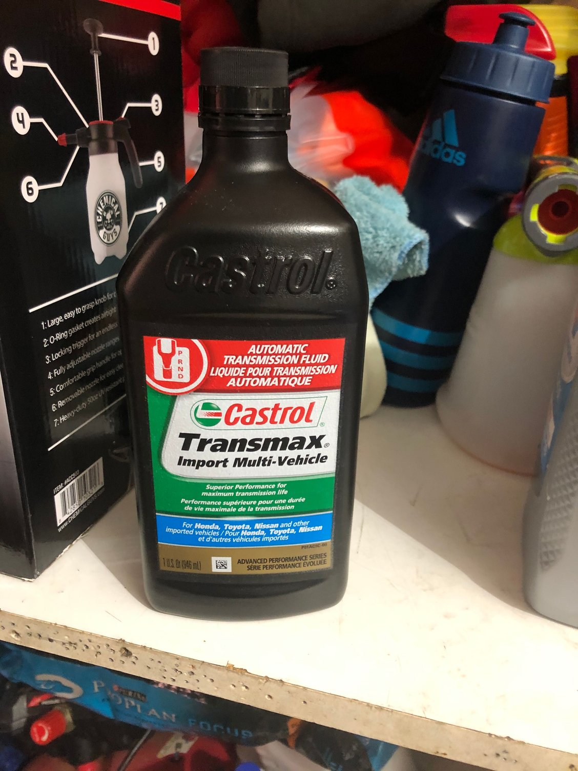

Couldn’t find the exact bottle John mentioned, but the store clerk said this is what I need. Dex III, but can’t find it on the bottle... so I’m hesitant. Should I go for it. Thanks in advance

The product sheet for the Transmax Import Multi Vehicle shows Dexron IIIH specs:
https://msdspds.castrol.com/bpglis/F...PXE-AFE8UE.pdf
If the UPC matches that should be good to go.

Thanks Chris,
UPC matches, big sigh of relief.
Many, many thanks!
