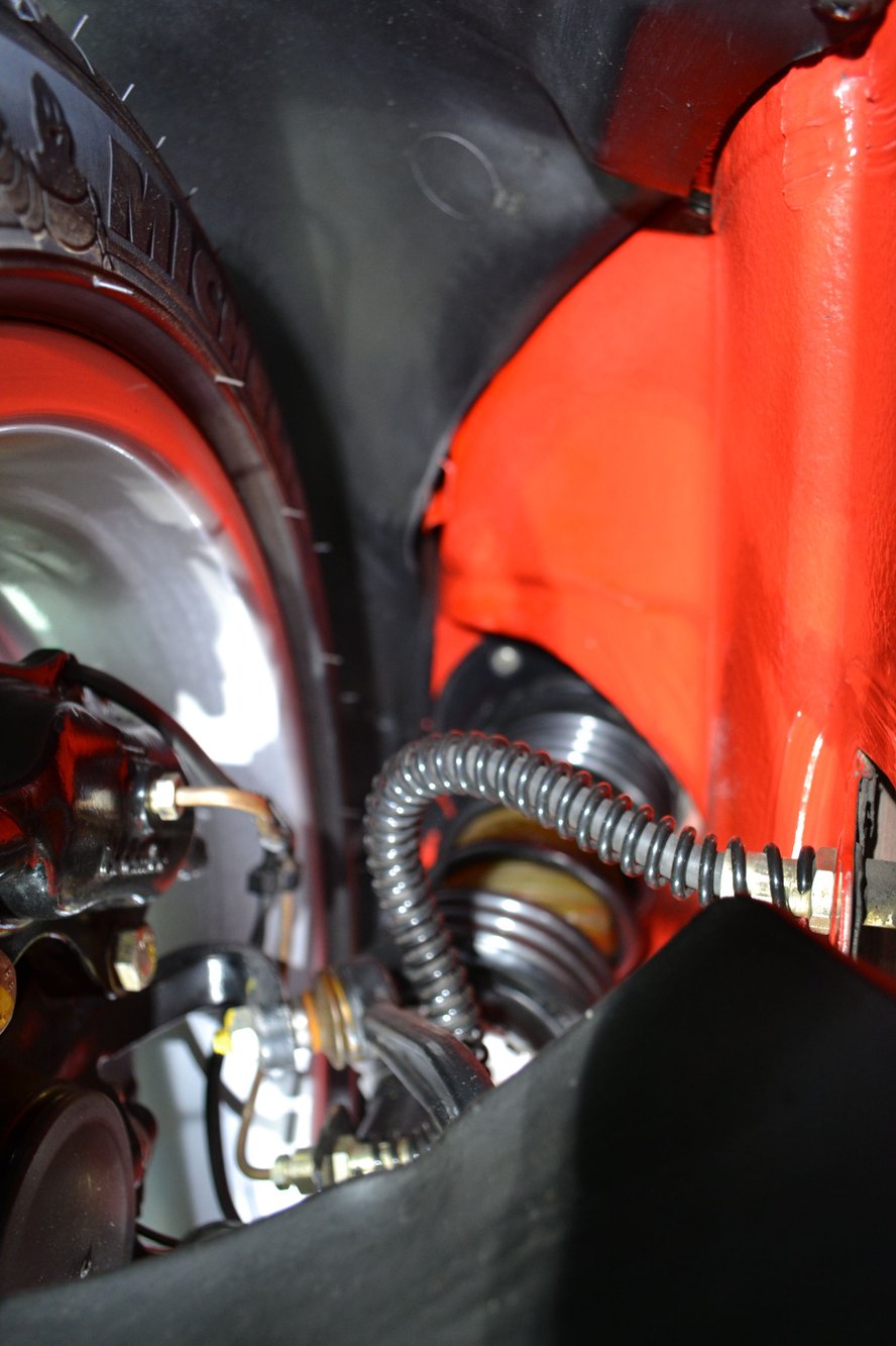

Everyone is hoping that there is some magic chemical, tool or technique which produces world class results with minimal effort. There is a reason you rarely see absolutely pristine engine bays on these cars, simply that while there are certainly some tricks of the trade, the bulk of it comes down to straight time and manual, tedious labor. Generally you can make it 80% better without doing too much, but if you want it surgically clean nothing but work does it. Mine I pulled the motor and did all the cleaning and detailing of the engine with it on a stand. Nearly impossible to do it well otherwise (not to mention getting the actual engine bay clean before reinstalling everything.

Originally Posted by Paolo1
wow what did you use on that fan that didn't also take off the original finish?
I use various things, start with gentle as possible and move up if I'm not getting the results I want: Xenit, Mineral Spirits, Gasoline, Wurth Brake Clean. Always try a small section you can't see before you try it on anything super important.

I have had 6 or 7 of my cars done with dry ice and it probably gets them 80% clean with 5% the work vs the old do it all by hand method, BUT if you really want it perfect there is still a bunch of hand work required. Trust me, there is no shortcut if you want perfect.... This is all done by hand!

Nathan that is insane levels of detailing! I debate getting mine dry iced too, would love to see the cosmoline gone.
Here’s mine, not nearly as clean as the Nathan’s red one above but pretty good for a 30 yo 75k mile car.
