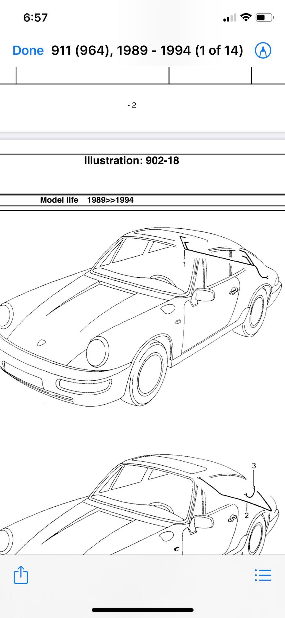

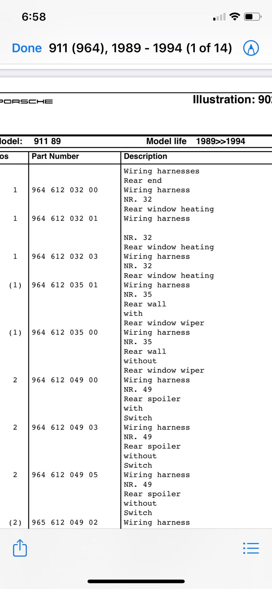

I have no advice on installation but here are the part numbers for the seal, rear windshield and wire harness for rear defroster. I just finished my car so just went through this recently.
