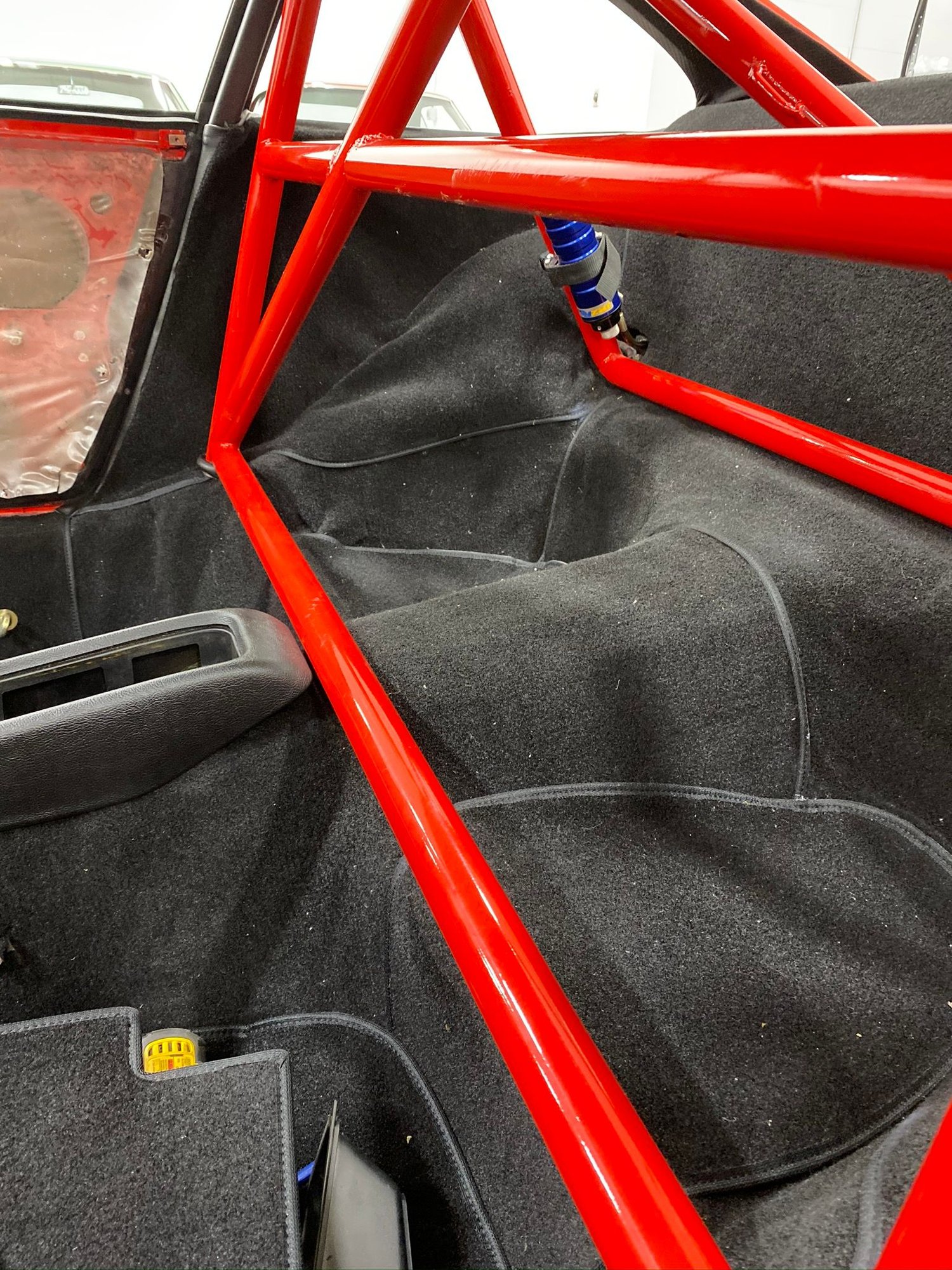

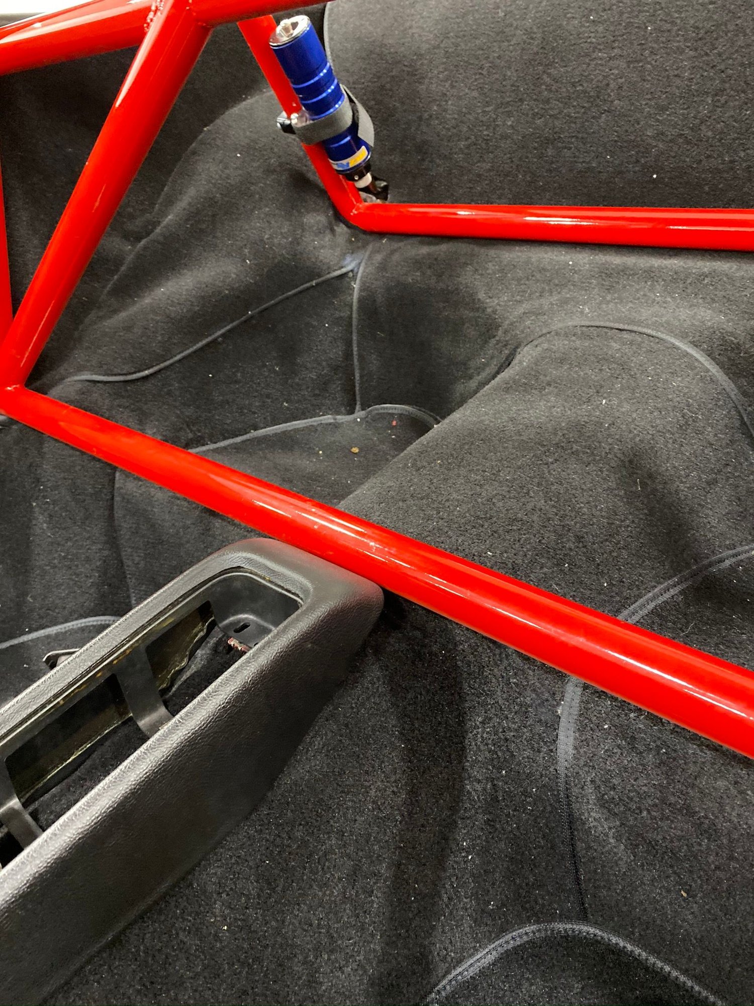

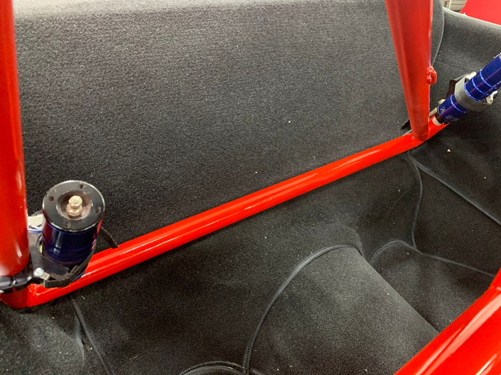

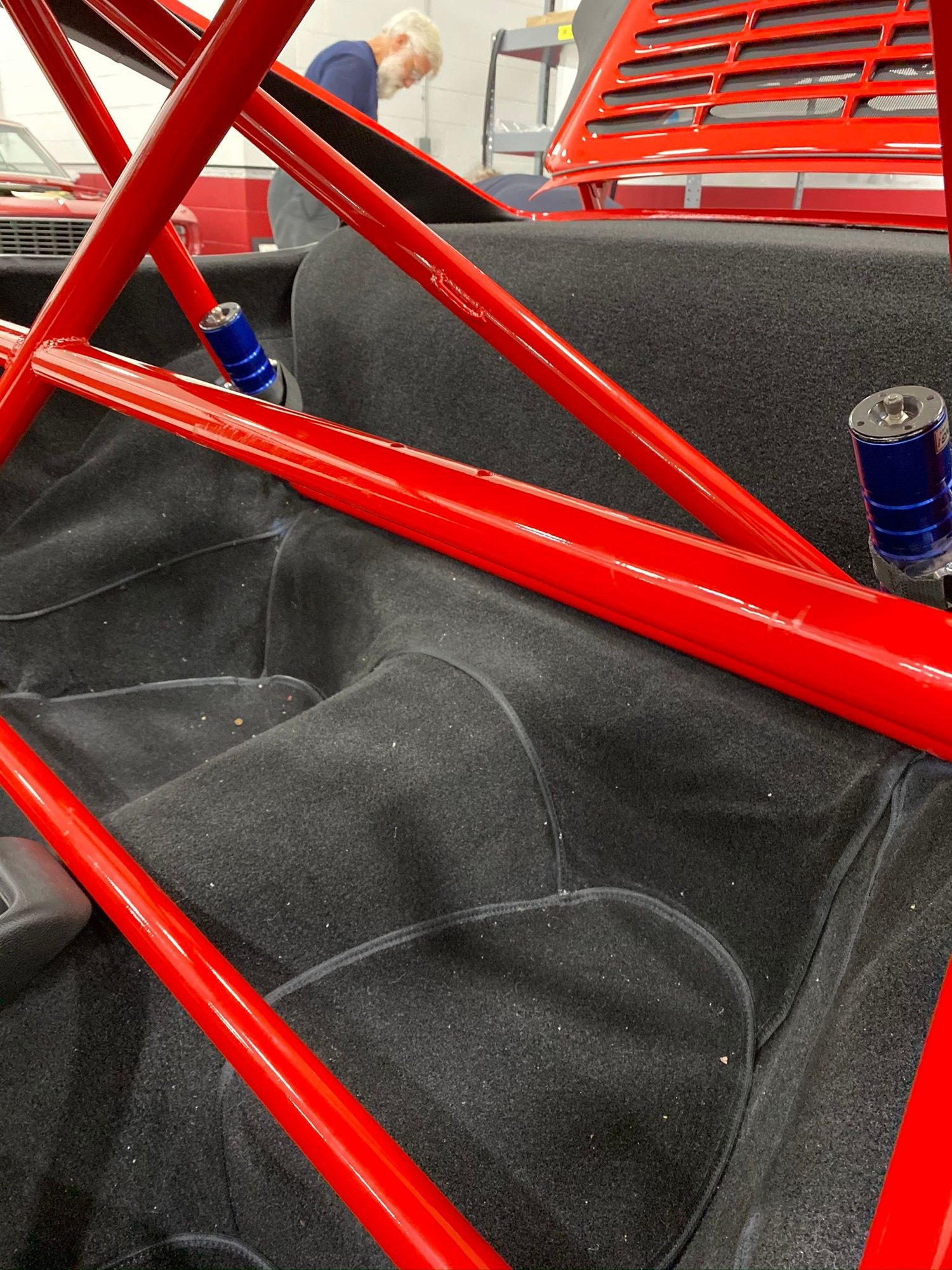

Your picture looks pretty good... My pictures were taken as it was coming together so it’s not the final finish. The RS America didn’t have rear seat and hence seat belts. They had to modify the fit with the roll cage, the lines for the JRZ canisters, and the wiring that runs under the carpet. This isn’t the finished product but it’s coming together nicely.
The canisters will be moved to the lower bar..
They’re smoothing out the bumps on the sides.

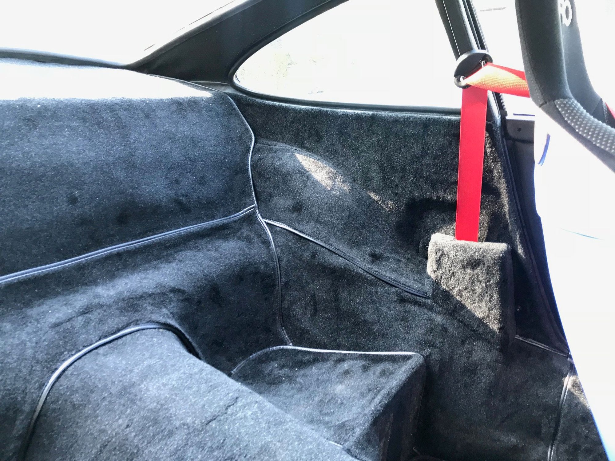

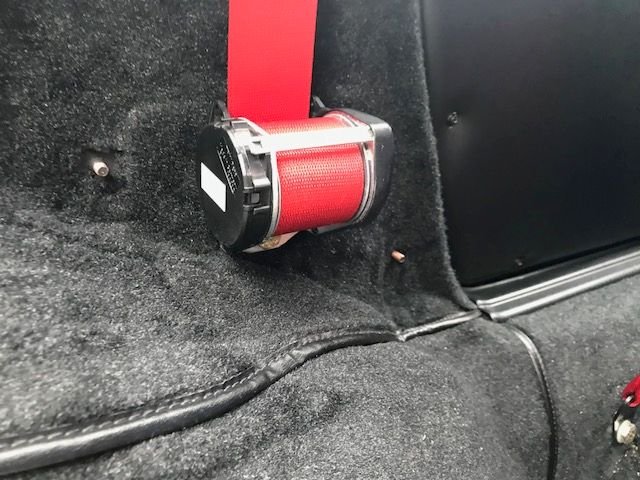

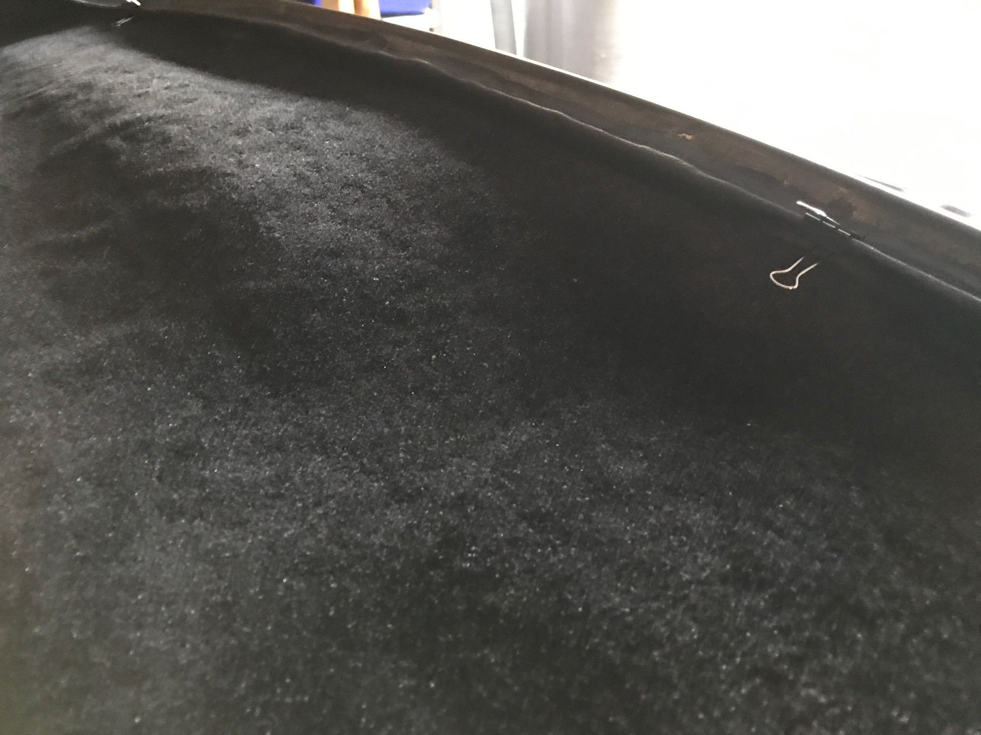

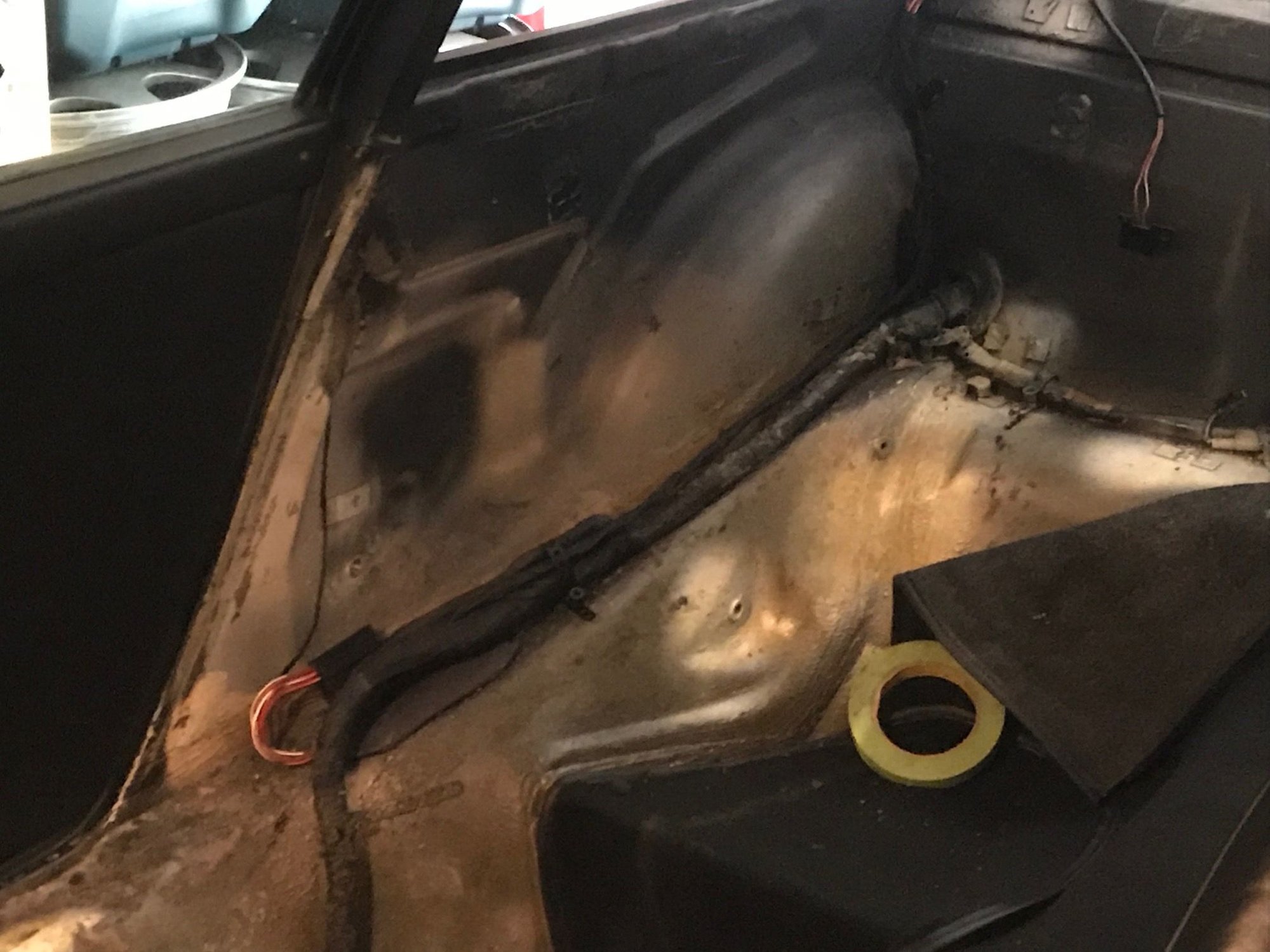

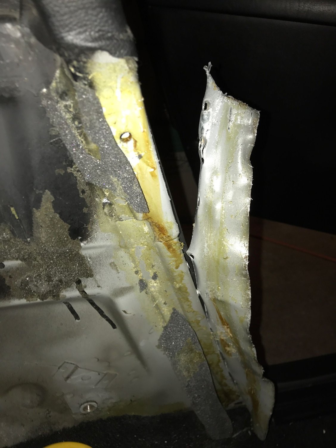

I had a Lakewell "RS" kit in my car, then stripped it out and re-did with a Southbound RS kit (no affiliation). I used the same 3.8 RS as one of my reference pictures. The second time around I did windows out and removed most brackets: lockpost, quarter window upper trim brackets, etc. The quarter and rear sections are mounted with reverse sewn vinyl pull strips and glued to the window flange (pinch welds) like headliner. I ordered my rear parcel shelf with their thick backing which helps the carpet "float" over the bumps a bit better otherwise the carpet is pulled tight before gluing. My quarter section is a bit low; the edging of the three sections should converge. Southbound has the individual rear sections if you're not looking to do the whole interior.
These are some of the few pictures I have.

Where did you get and/or how did you make those seat belt retractor covers?
I got my belt covers from Southbound as well; untrimmed fiberglass replicas. I think Porsche still sells these as a 993 part. For the mounting studs (M5 I think), there's factory measurements in the RS handbook which you'd ideally do before installing the carpet, but I had my studs welded in after. I just lined up my covers, Dremel-ed through the carpet to bare metal and drove to my local 'Capacitive Discharge Stud Welding' shop (with passenger seat removed and I unbolted my seatbelt cassette, on site, just in case). It's a very quick, low heat, no worry about fringing, in and out in a couple minutes - I'm surprised my local body shops didn't have such stud welding. Anyhow. ... I'll send a PM with a couple more reference pictures.
