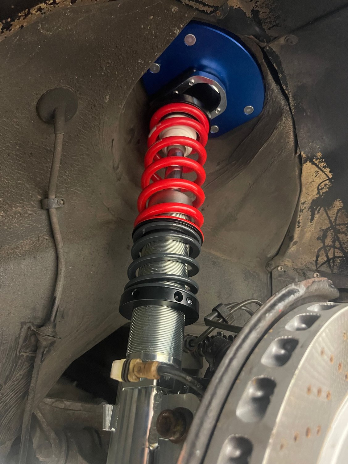

I did a full suspension and handling refresh last year.
• Ohlins DFV coilovers with solid top mounts.
• Elephant Racing billet RS hub carriers.
• Elephant Racing drop links front and rear.
• Rothsport steering rack brace with poly bushes.
• 993 RSR style (solid) track rod ends.
• 993 front wishbone ball joints.
• Powerflex front wishbone poly bushes, Black series.
• Powerflex rear trailing arm poly bushes, Black series.
• H&R uprated sway bars front and rear.
• DRS adjustable rose jointed rear spring plates.
• Rennline tubular engine carrier.
• WEVO engine mounts.
My Indy thought I'd ruin the ride, due to all the stiffer components...
But after the installation, agreed that it transformed the car!
The Ohlins are currently set half way and are very compliant.
I think the solid track rod ends were the biggest bang for buck, really makes the steering so precise.
