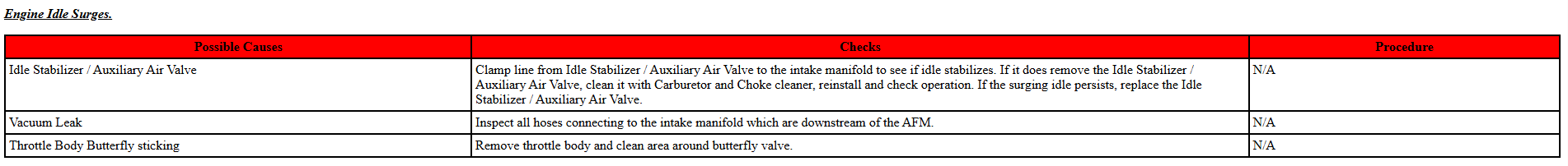

https://www.clarks-garage.com/shop-manual/ts-01.htm
