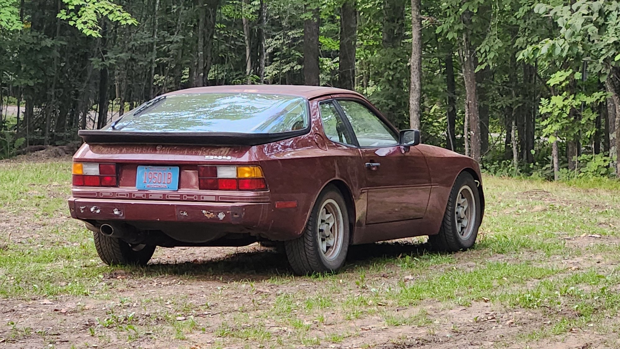

Here's some pics of it
While it looks a little rough, it runs like a top.
Its about as much of a 25 ft car as is physically possible.
