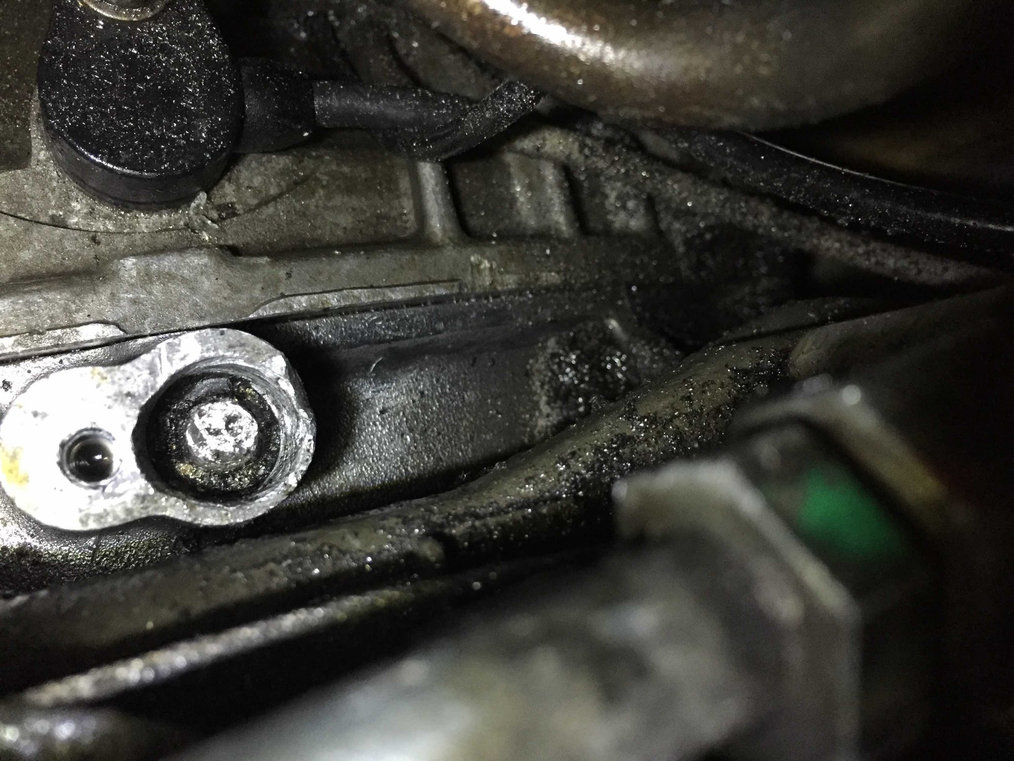

Default CPS mess
This is where i'm am right now. tried dremel cutting bit to expose magnet but i can't pull it out, just won't budge.
Old May 9, 2016 | 08:18 PM
MFranke's Avatar
MFranke
Joined: Jul 2012
Posts: 500
Likes: 6
From: Powder Springs, GA
The magnet is too hard to drill. I had luck doing the following:
I used a soldering iron to melt the plastic around the magnet and scope bits of plastic out. Once I got enough of the plastic out you can grip the magnet with some pliers and the magnet will pull out easy. The trick is to melt/dig enough plastic out. After removing the magnet I sunk a wall hook into the remaining CPS body and pulled the rest out.
i think you're right. my problem has been there is no power in the carpark i'm stuck in. so only been able to use cordless tools. i have the cordless Dremel with snake attachment and cutting bit, works well but i scared of damaging the bell housing. i had tried with my gas soldering iron briefly but was worried about fuel lines.
i'll have another dig today with the dremel and maybe try get some power for my iron somehow.
Thanks for your help
