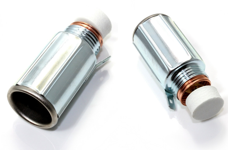

Took matters into my own hands... here's my solution. Works perfectly!
Autozone Universal Cigarette Lighter
This is the autozone receptacle with the outer half unscrewed from the inner half.

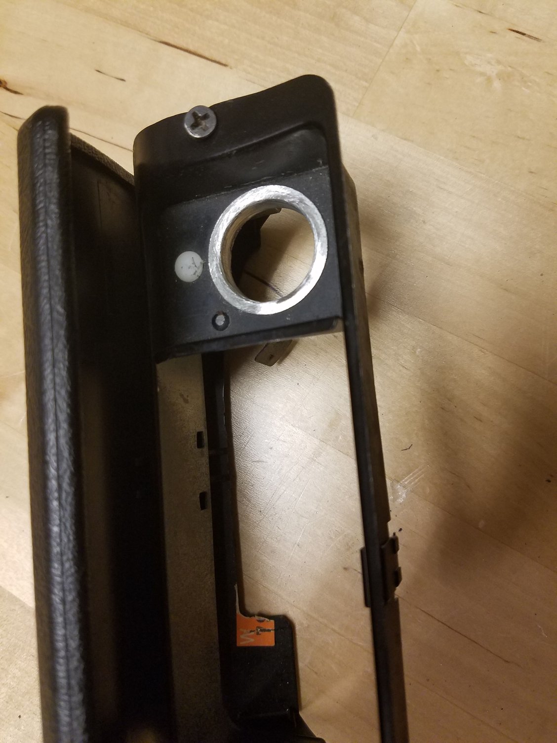

The old receptacle is cut out with a dremel.
The new receptacle slides into the old without issue... really illustrates the size difference between a 'cigar' lighter and true 12V outlet.

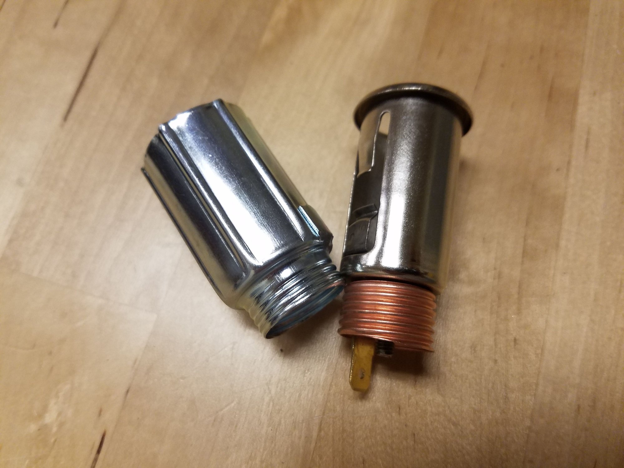

The outer sleeve of the new receptacle is modified to have a cutout where the positive prongs are, and the negative spade is removed (redundant, so not needed). Without these cutouts, the positive prongs contact the metal sleeve and short out (ask me how I know).
The sleeve is threaded onto the inner portion to secure it in place.
Here you can see that there's no way for the new receptacle to short out. The spade connector is then bent at a 45 degree angle (not shown). If the positive spade connector is not covered in heat shrink, do it now to prevent it from shorting out anywhere.
