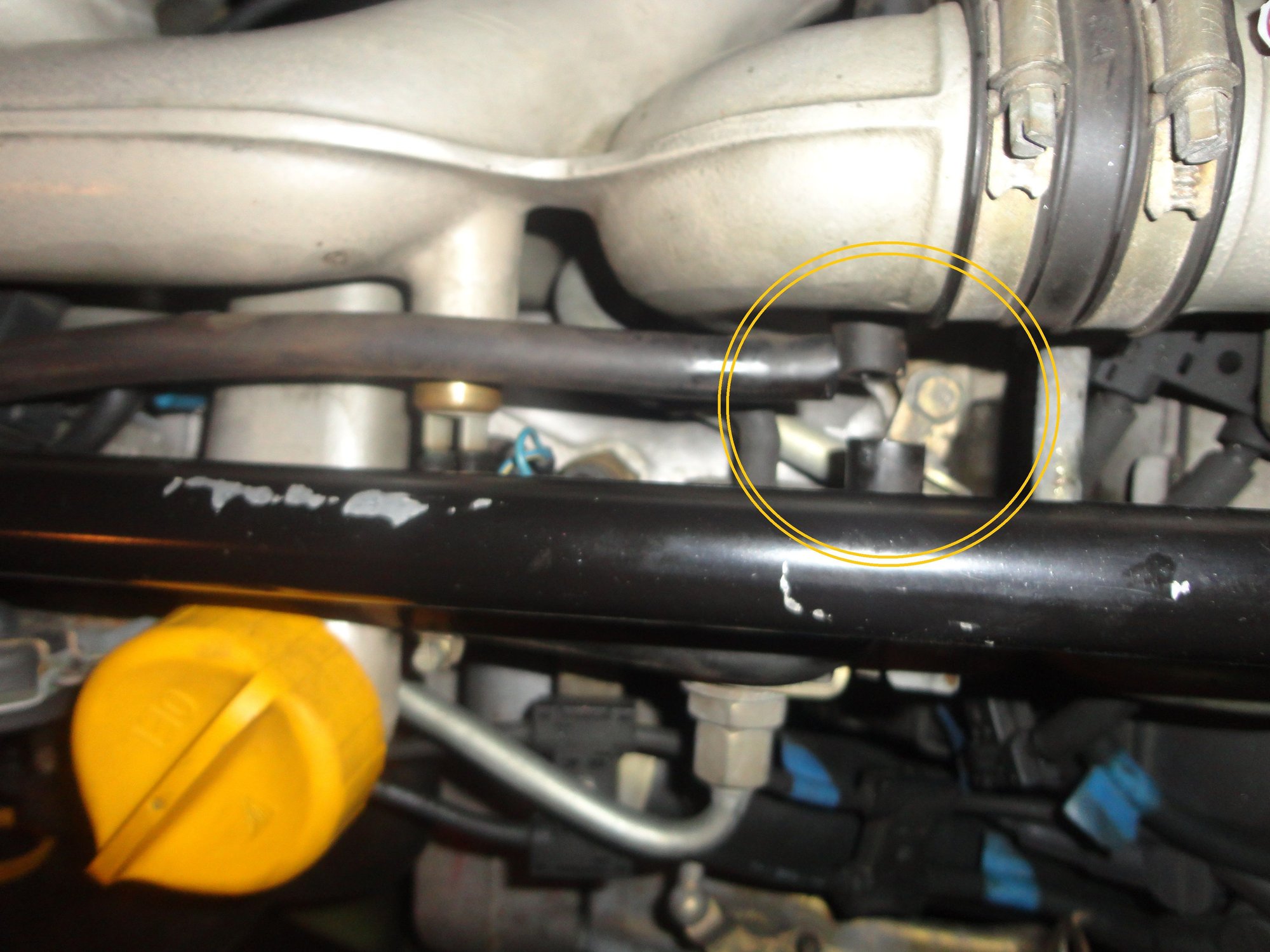

I was poking around the engine, and I broke this 'T'
Which belongs here
The question is this: why is one passage so restricted? What would happen if it were the larger size?

It's the gas tank recovery line..that's why...if it's the one I think.

stick a brass one in there.

well make sure the restriction port is included in the part you swap in

Brass is no good as you need the restriction.
Part is only $3 - 999 137 044 40 and we stock them 8>)

Thanks Roger, I will be calling tomorrow about another issue (oil sensor). but why the restriction I figured it MUST be for a reason.
