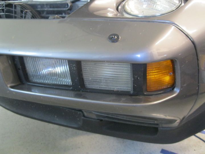

Now trying to decide if it's worth it just to fix the lights.
What else should be done while the cover is off?
Replace the bumper beading, use 1/4 inch staples that are stainless so they dont rust.
Get 2 new HL squirters and the plastic nuts that hold them in.
Make sure your horns work . now is easy to work on them.
