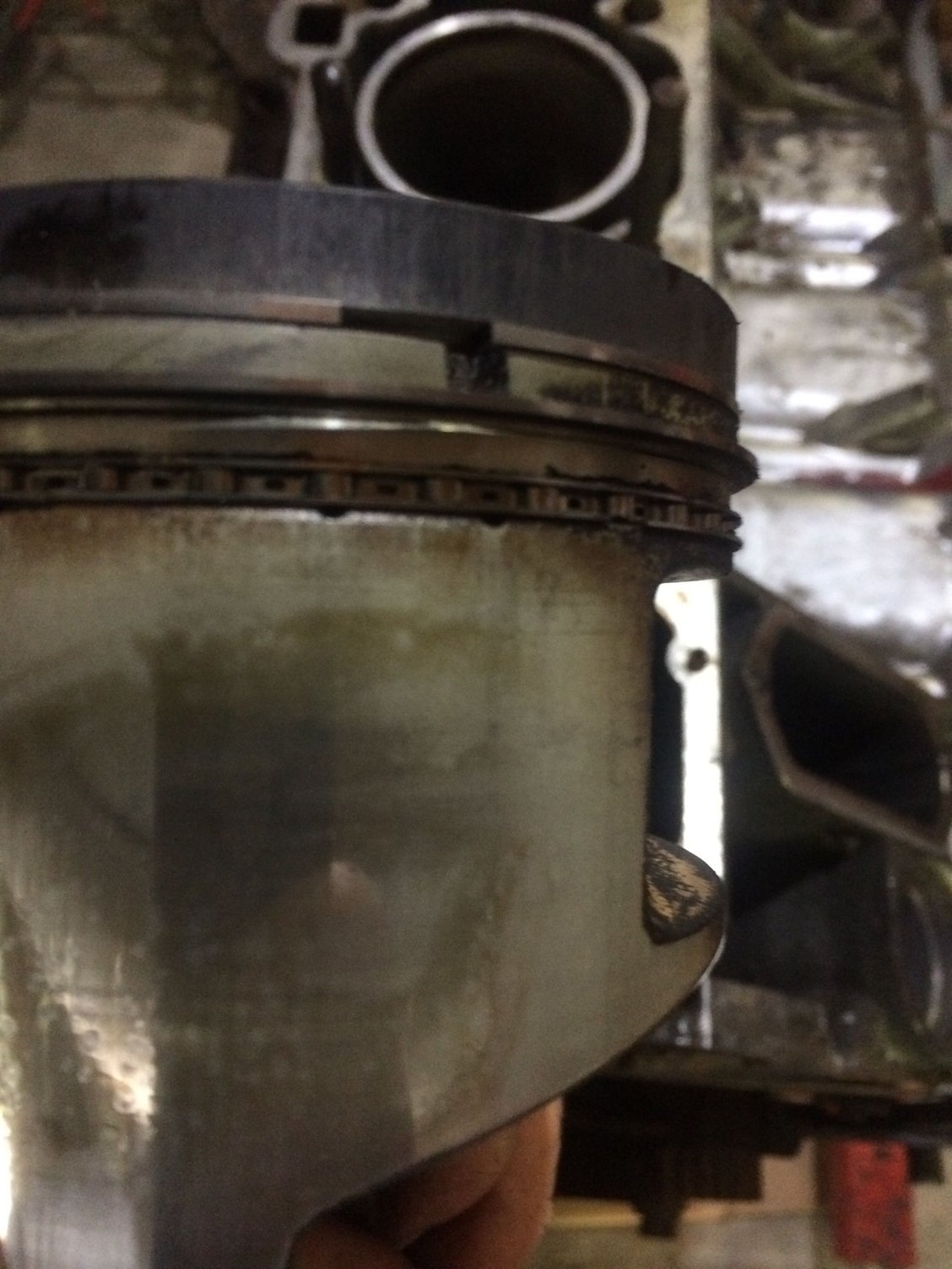

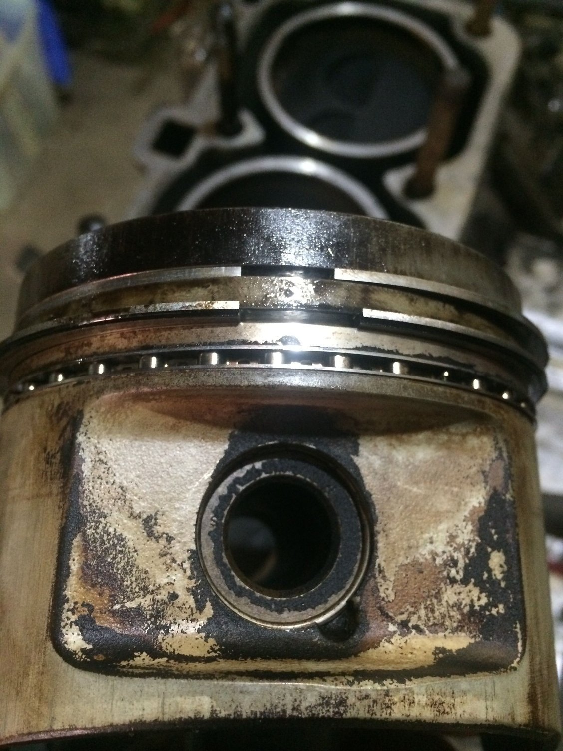

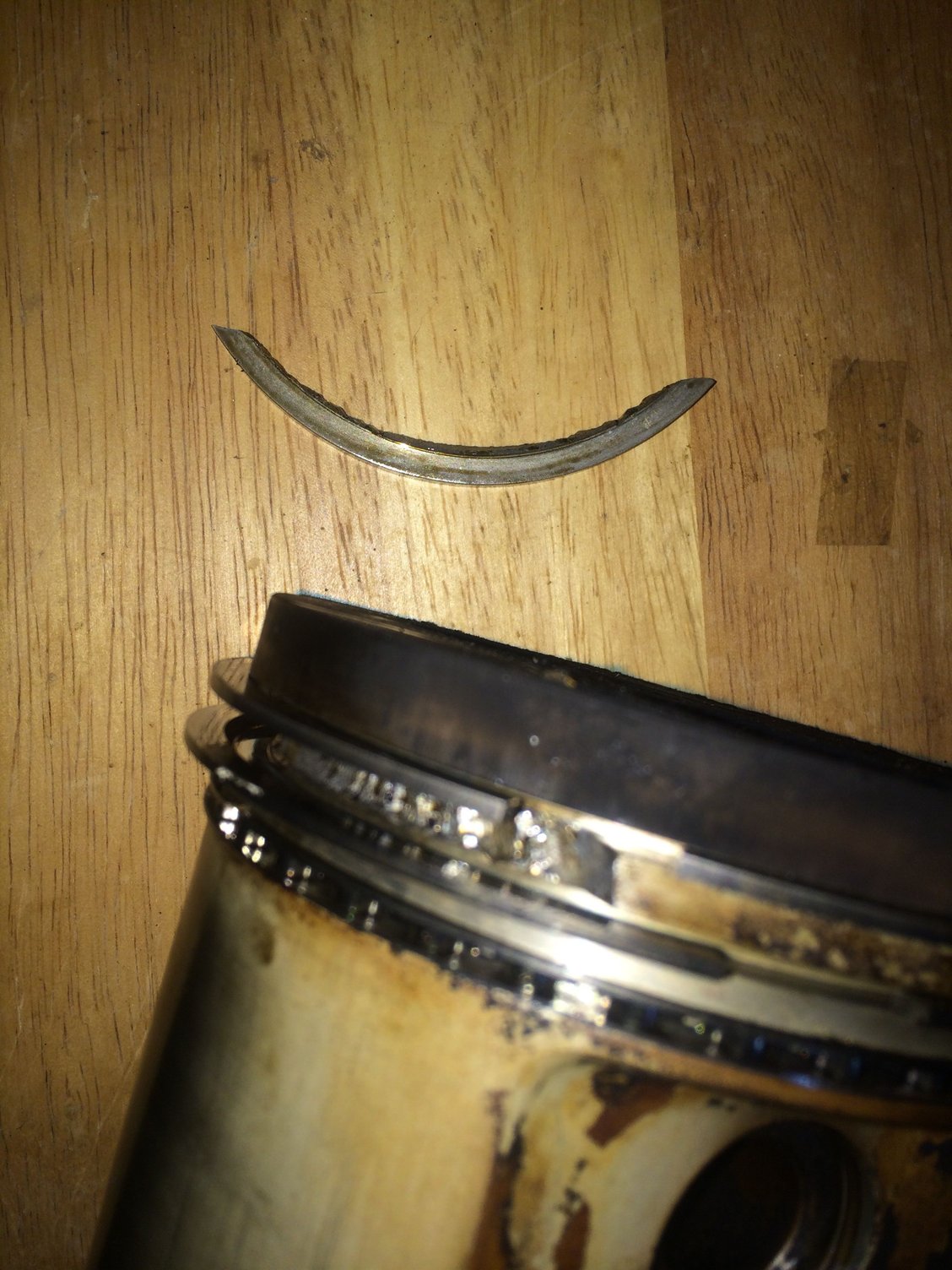

That escalated quickly. Glad I decided to just redo everything.... Pistons broken between first and second rings.

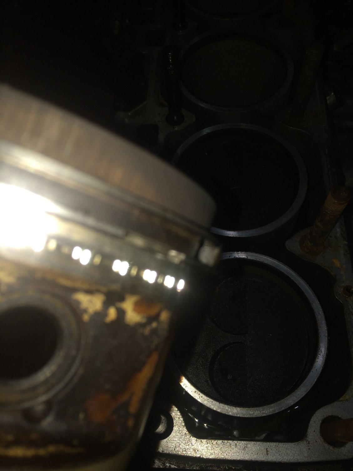

Someone re-ringed this engine already. And did it wrong. Notice something funny here? ( pulled it straight out, no twisting, this is how the rings were)
That's pretty ugly, for a bunch of reasons, but in terms of ring alignment, couldn't that be chance? Unpinned rings do rotate, I think.

Just buy a good used engine. Ringland breakage is not common unless it was detonating badly for a long time.

If it was my engine, and with my experience, I'd replace the broken pistons and get the stronger top rings.
