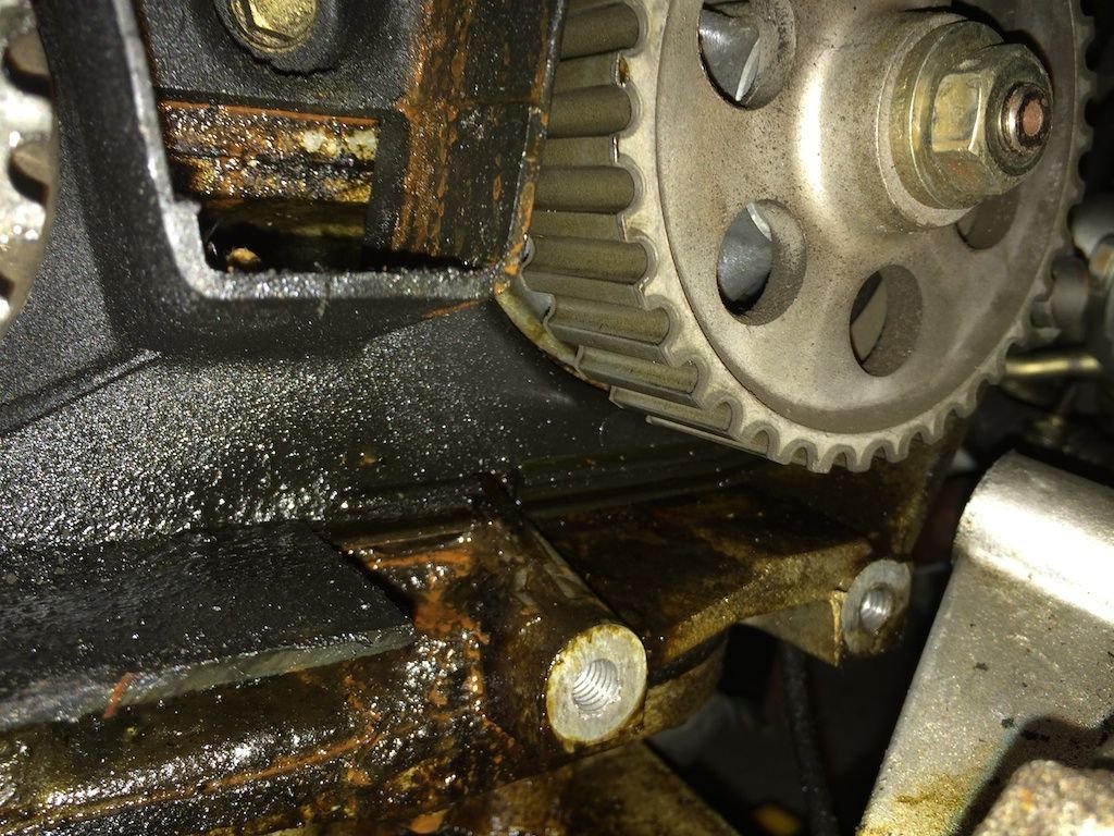

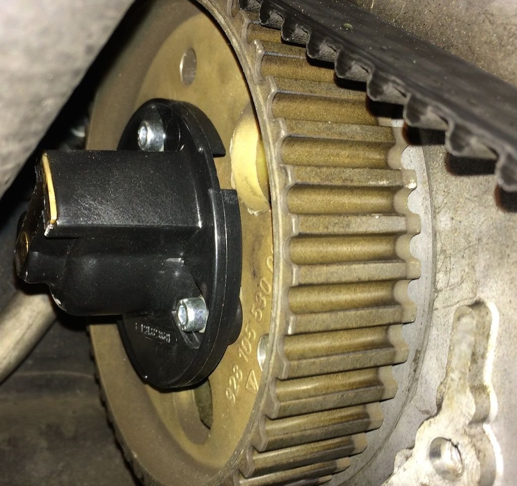

1. The timing belt looks good, tension seems reasonable to my fingers, cam gears look good (correct? see photo). I will continue, of course.
2. The starboard cam gear cover has been in contact with an AC tube, causing some serious wear (see photo). I suppose collapsing motor mounts might be involved - I'm not sure what they would look like - see photo. I'm inclined to put two sheets of teflon at the point of rubbing to prevent further fretting, and monitor their condition.

All looking good and those cam gears look like new - did you buy a lottery ticket today?

You'll love it when it's all clean and shiny aluminum! Take a look at the low areas on either side of the block below the oil filler neck. Mine were full of oil and when that happens, the oil spills forward and runs down behind the cam covers, adding to the mess in there. To say nothing of bathing the alternator and other stuff in oil!
One other gratuitous piece of advice, consider getting Porken's 32VR tool and set your timing with it. Over time it can get pretty far off and the car runs wonderfully better when you put it back where it belongs.

I'd be less inclined to mess with the oil pump o-ring than the oil filler neck gasket (as Bilal suggests)- lots of that oil slick is coming from something farther north than the top of the oil pump.
WYAIT, while the coolant is drained, you might tempt fate and pop the coolant crossover off and R&R its gaskets and the rear thermostat seal. They are good every 25-year maintenance items. Just be sure to Kroil the heck out of the 6mm socket head cap screws that hold the coolant crossover to the heads- they can corrode, proceed with caution.

Those cam gears look good - low mileage early 87? (They look like the part number ends in 00 - possibly take-offs from an early 32V).
The oil mess on the front could be the tensioner - but changing the oil pump seal and o-rings is easy to do while you're in there. Just make sure you torque it up properly (with clean threads) as there've been a few cases of people failing at that and having the gear come off, leading to many ugly, expensive, metal noises.

Your cam gears do look good, but it might be worth having them re-coated now so that will still look good the next time you need to do a timing belt job. I have seen it posted that re-coating is $40 or so. Seems like a good insurance policy to me.

96,000 miles. I don't recall the service record for the belt change (20 years ago at 60K) mentioning the cam gears. The last digits of the part number are actually "01". Despite all the filth elsewhere on the front of the engine, the area where the belt runs is clean as a whistle. I wonder if cam gear wear is mostly from abrasive dust.
