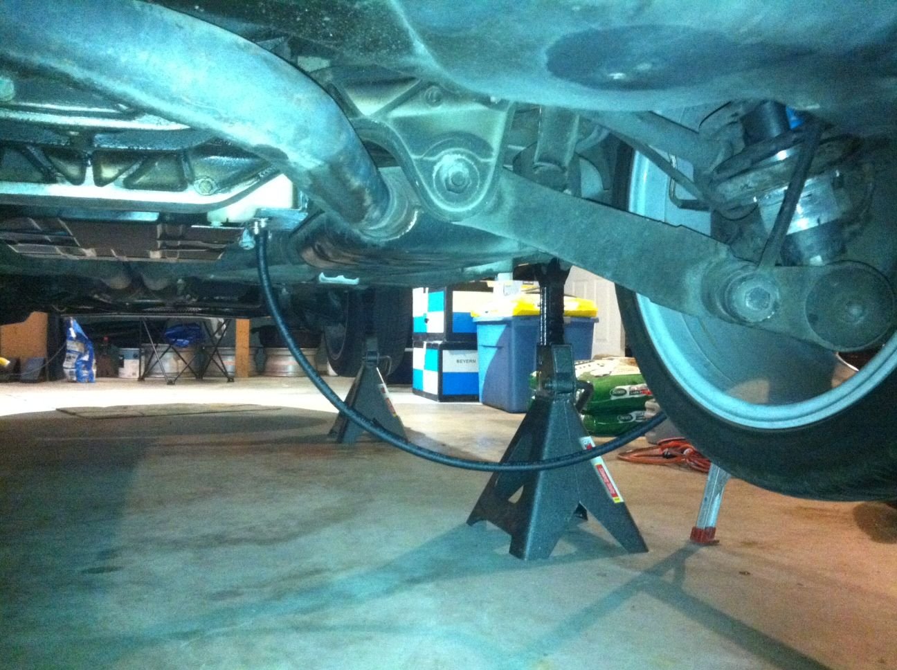

First I set up a step ladder and suspended a clean funnel with a about 18 inches of clear hose attached to almost 4 feet of fuel hose I had. I suspended the funnel with a bungee cord. Note the fluid level in the tube is the same level as in the transmission.
View of hose under the car.
Above the hose loops upward on the left toward the ATF reservoir. Below the hose is shown wedged between the fitting on the transmission and the exhaust heat shield. This holds the hose securely. The hose loops up and reaches its apex where "Made in USA" is stamped. The hose then loops down, with mouth of hose held securely in the reservoir lightly against the plastic screen.
The way the hose is held perfectly in place for filling was an accidental discovery while fiddling with it. Turns out the fluid transfer is slow due to the fluid friction in the hose and perhaps a bit more resistance due to the mouth of the hose pressed against the screen filter in the reservoir. The slow fill rate is perfect to avoid suddenly overfilling the small reservoir.

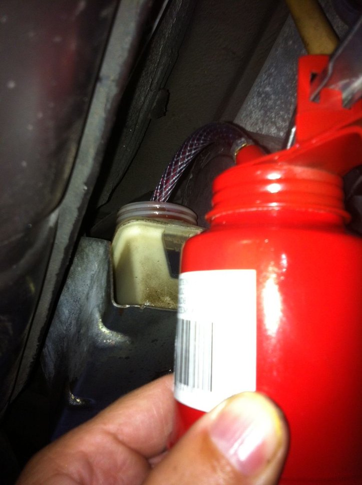

To top off the reservoir I used this nifty oil can from Harbor Freight. The hose has a wire guide that can be bent to fix the hose in an appropriate position. Pump the lever and it pumps small amounts of ATF into the reservoir.
This photo is actually from a previous top off...now the reservoir is clean!
