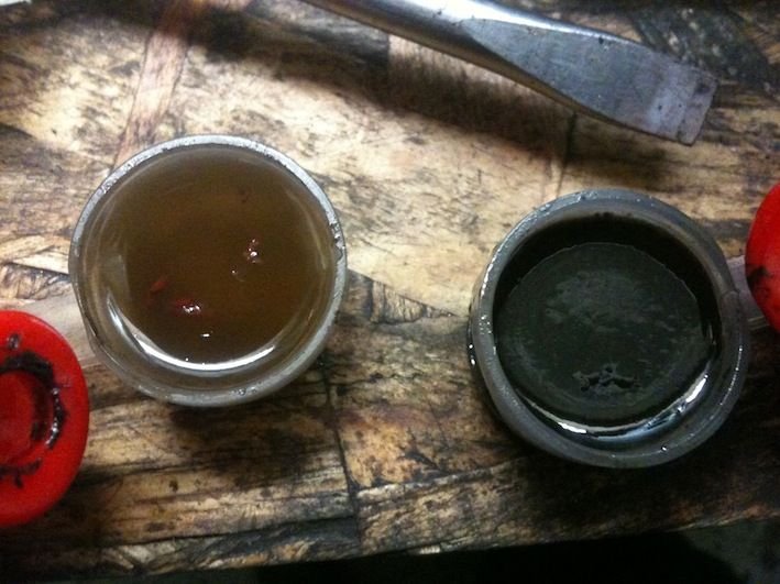

At first the clutch was still engaging but the pedal would only come back up halfway, a few days later it wouldn't work when cold but no problems at all with the engine at temperature.
Today I decided to bleed the clutch but as soon as it was pumped once and the bleeder opened, it floored and now it doesn't travel back up at all anymore. We' ve tried a couple of times but there's no more pressure to bring the pedal back up again. The oil that came out was black and watery.
Last year I did a brake job and bled the brake system with fresh dot3. Today I've checked the oil in the brake system and although not entirely fresh it still has the original colour. (see pic:brake oil on the left, clutch oil on the right)
The clutch and brake use the same oil I think, so should I have bled the clutch along with the brakes when I did that job last year? Somehow I was thinking the oil from the brake and clutch would look similar.

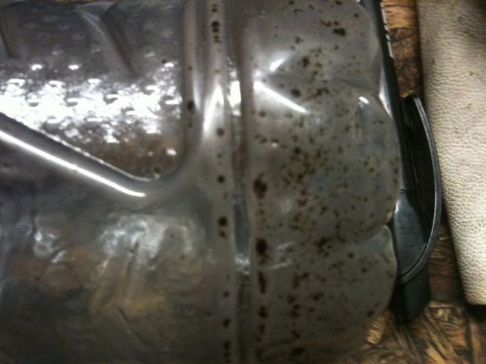

There's also some residue in the bottle that captured the clutch oil. Rebuild or replace the clutch slave cilinder before trying anything else?

If you have an oil pump can put the brake fluid into the slave and pump it in reverse otherwise use the RF caliper and put the hose on the bleeder then to the slave this operation requires 2 people.
Then you may have to open the master by removing the snap ring and letting out the remaining air then put it back together

Thanx for the info! I'll try the reverse methode first,if that doesn't do the trick, I'll try the "Another way to save time on the clutch Hydraulics" method. Great writeup btw. Mr.Merlin

Reverse bleeding did the trick.
