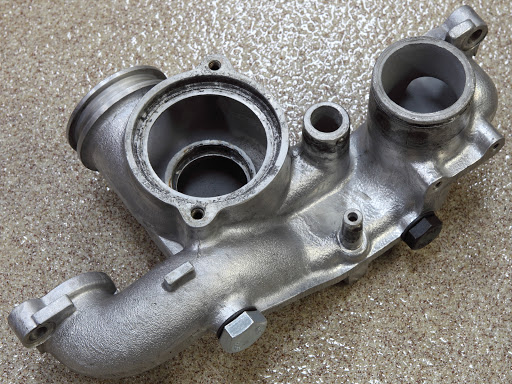

I believe it's M14×1.5 (at least it was on my '90, and I don't think the size has changed over the MYs, although the sender changed from 928.606.201.01 to 928.606.201.03 in '89; the water bridge didn't change in that year, though, so... tapped hole size must be the same ).
Temp II sender (the other, smaller hole) appears to be M12×1.5.
I got these from measuring (with a digital caliper) a couple of bolts that I used when I was temporarily plugging those holes a few months ago; the silver bolt is the M14, the black one is the M12:
