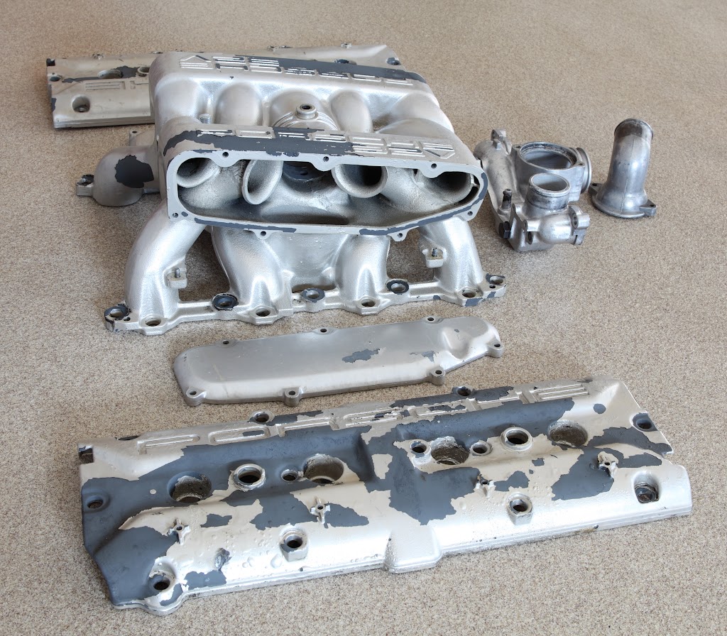

FWIW, my parts were dark gray (under the peeling paint) on the outside before any prep work was done (other than power washing all the loose crap off):

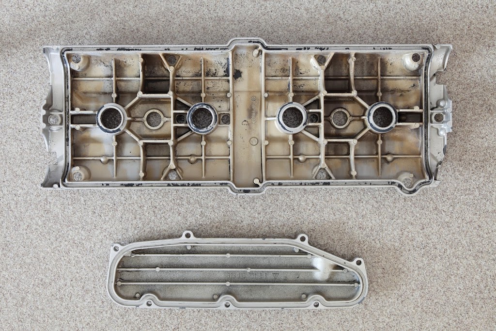

and like this on this inside:
and after blasting and baking (and powder coating, actually), they looked like this (I left the insides bare metal; outside and inside should look like something like the insides here before powder coating). Pretty light (not quite white, but a lot lighter than their original color under the paint). I actually never got to see (or photograph) mine after blasting/baking but before powder coating, as the powder coating guys did all of this and they weren't close enough for me to drop in at regular intervals.
