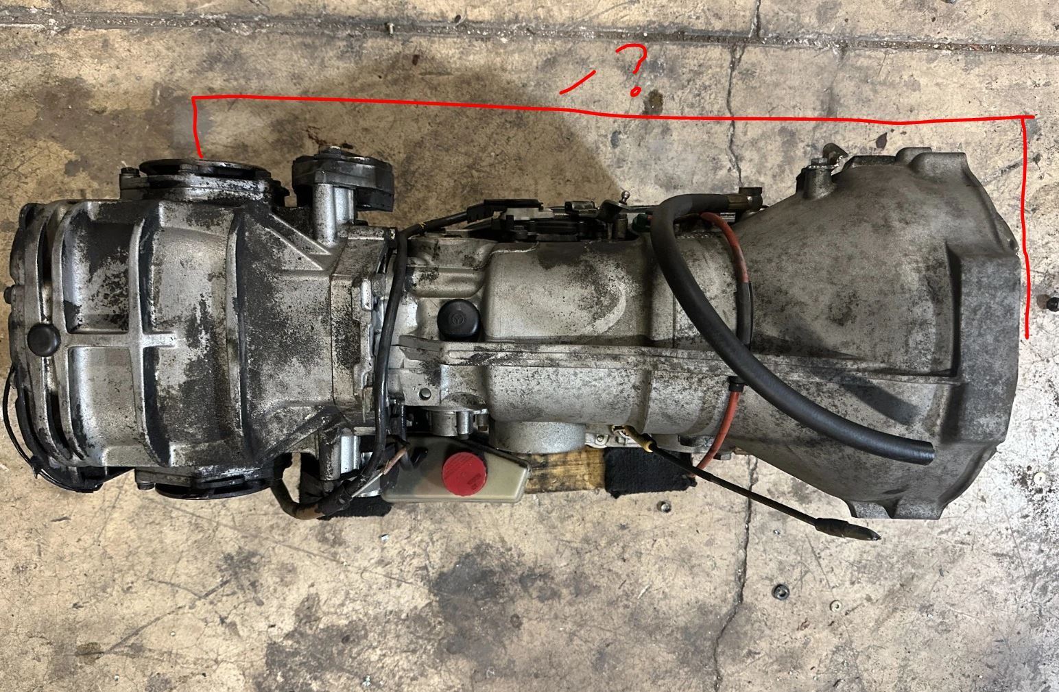

Question 928 Transaxle Dimensions help
Hello. I have a pretty specific question and you all seem to really have a handle on stuff.
Nice to see forums still alive and kicking
Im hoping someone may just happen to have this laying around but was wondering if someone could please take a look and provide this dimension here.
Its from an auto transaxle of a 928. Im needing from the mounting face to the CL of the axle. I know this may vary based on year but it would be a big help.

Just to be clear,
your picture appears to show the torque converter flex plate and housing not installed,
is that correct?
IF so then you need the measurement from the trans housing not including the TC and flex plate housing,
to the CL of the CV output shafts.
NOTE it appears that you have a 4 speed transmission .
I have an 84 early 4 speed up on jacks I can check it tomorrow.

Originally Posted by Mrmerlin
Just to be clear,
is that correct?
Yes that is correct
That is exactly what I need.

OK it looks like 27 and 1/2 inches or 698.5 MM
