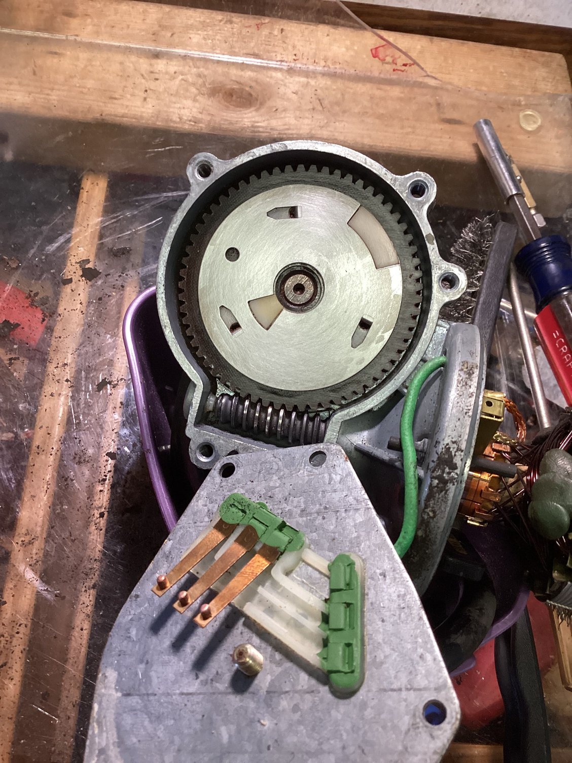

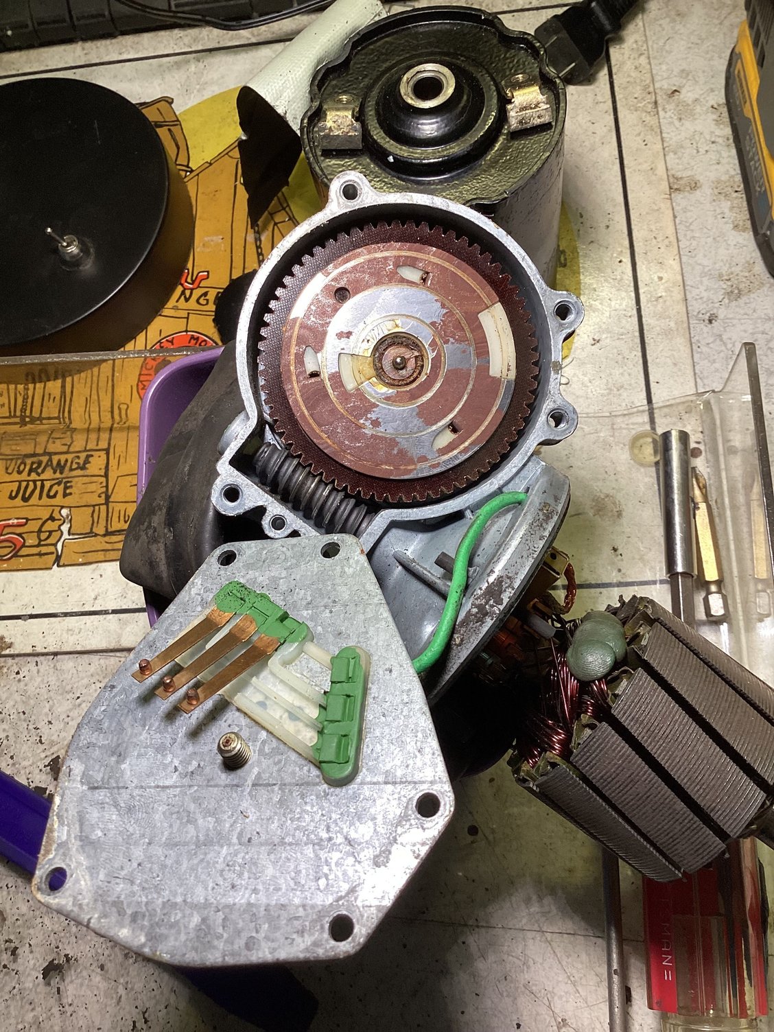

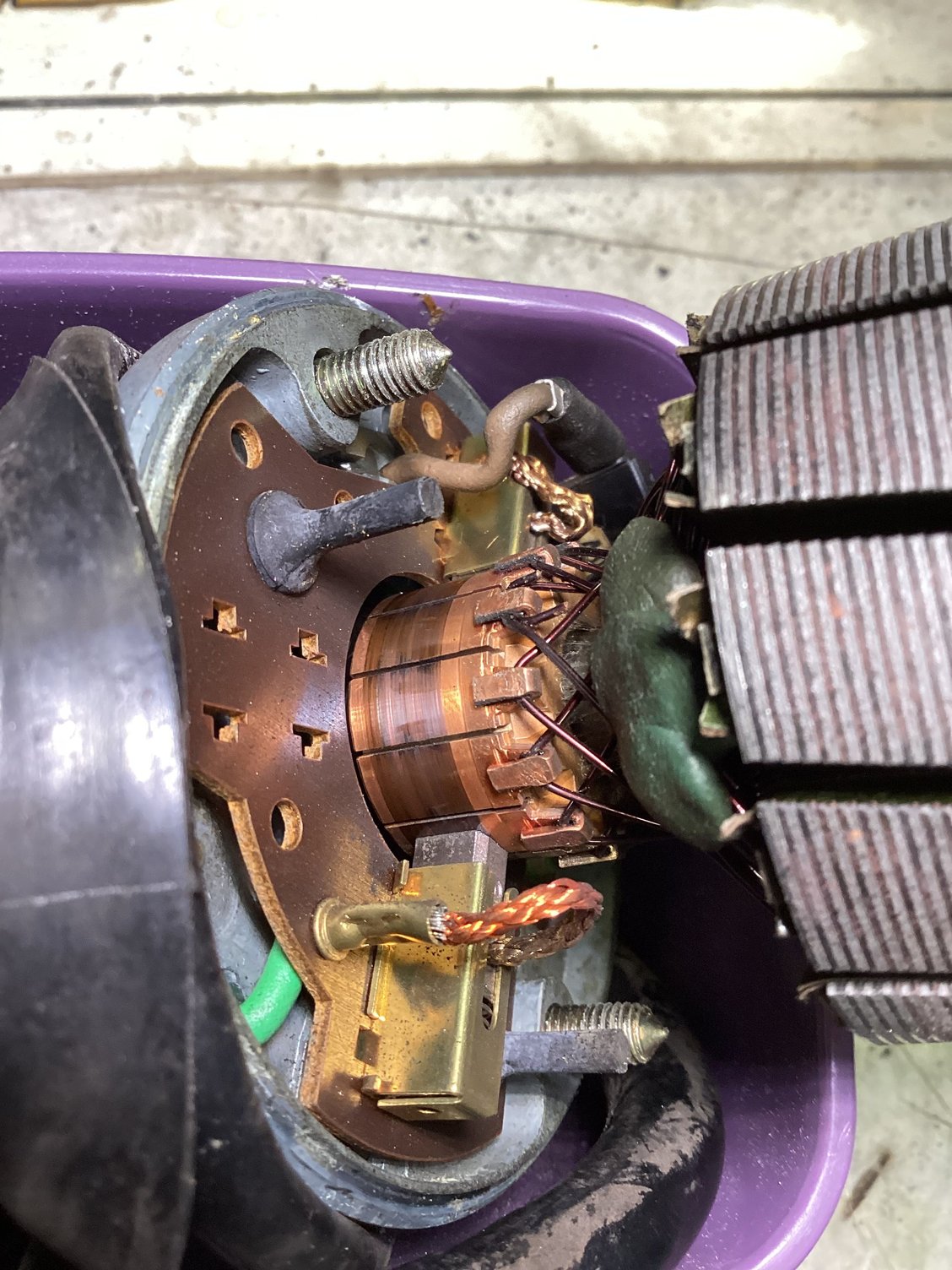

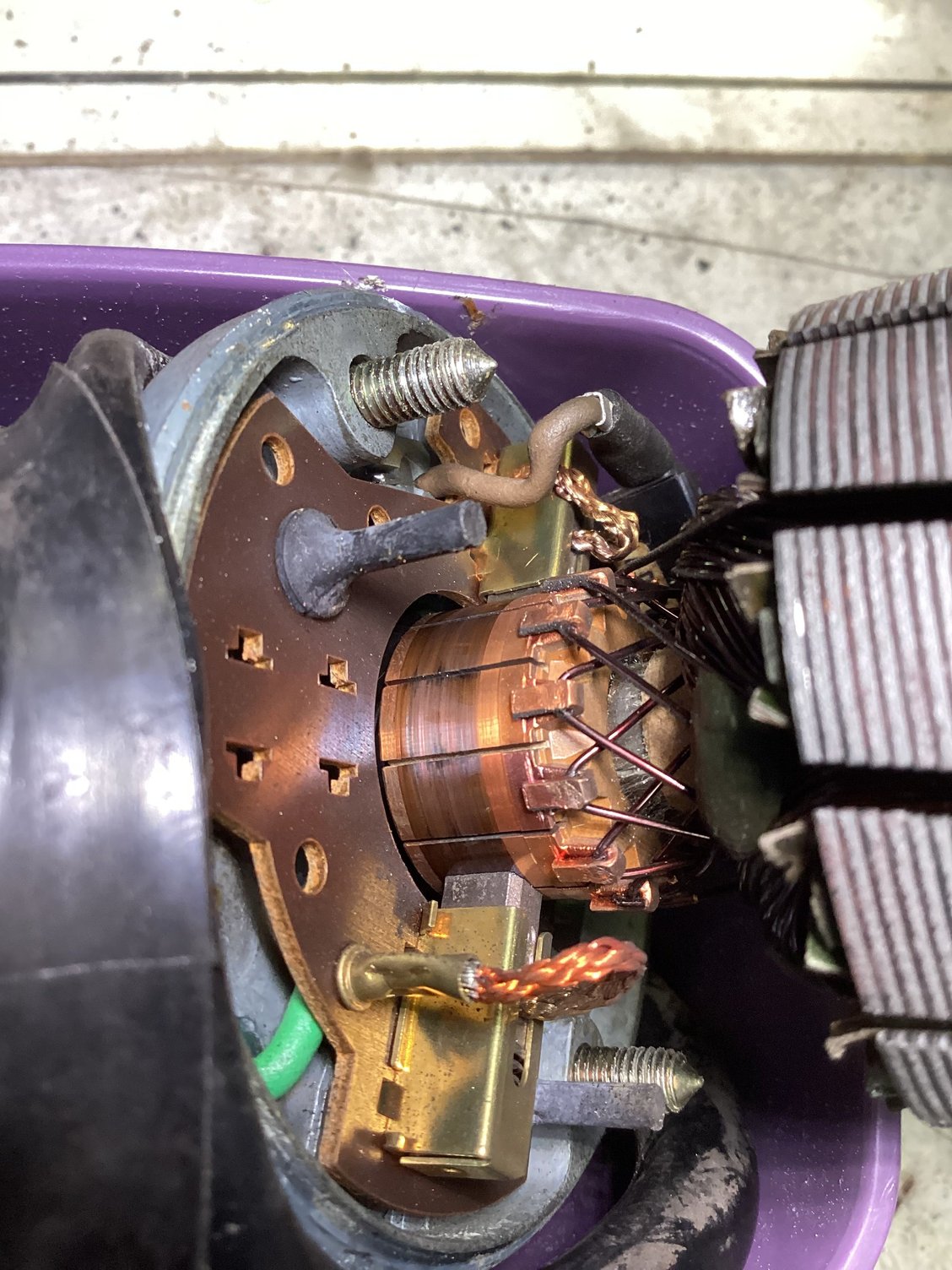

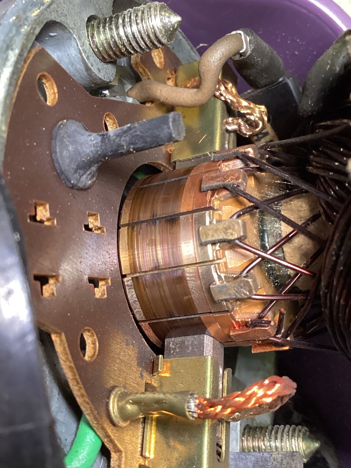

Taking pics of removal and will do a separate on removal/install.
Motor pics below.
Pic 1 of rotation
Pic 1 of rotation
Pic 2 of rotation
Pic 2 of rotation
Pic 3 of rotation
Pic 3 of rotation
Given the color difference of these two contacts, are they the “stop point” for the rotation up/down?
Thoughts on condition or what I need to look at? Clearly, I can clean the contacts point noted above, just a bit dirty, but are those mild burn marks in the last pic?

Mrmerlin's Avatar
Mrmerlin
Team Owner
Joined: May 2004
Posts: 31,159
Likes: 4,156
From: Philly PA
your looking at the brushes and the armature .
NOTE the wiper pad is on the other end of the motor assembly,
inside the gearcase.
watch this.

Wiper pad
The pad clearly is an issue, best to clean with wire brush or lightly sand?

Old Jul 11, 2025 | 05:51 PM
  #26
chakka's Avatar
chakka
Joined: Dec 2009
Posts: 752
Likes: 127
From: Eastern Shore, MD
Back together after cleaning
Cleaned and de-oxit
Cleaned and de-oxit
Reconnected wires to test. Nothing. Lights don’t come on, motor does nothing

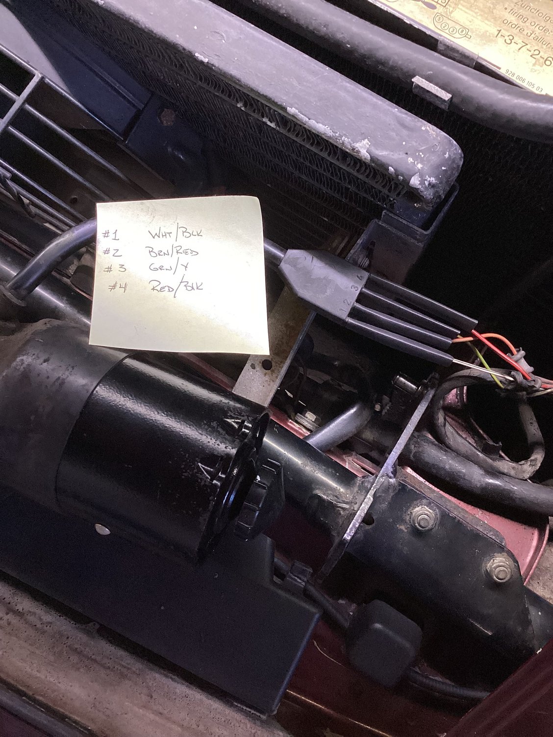

-getting 11.4 volts at pin 1 with key on(ground to chassis)
-getting 10.6 volts at pin 3 with key on(ground to chassis)

Old Jul 11, 2025 | 06:59 PM
  #28
76FJ55's Avatar
76FJ55
Joined: Nov 2008
Posts: 2,110
Likes: 293
From: Grapevine, TX
Have you recounted the motor to the chassis? It grounds through the housing, so if it isn't mounted it won't have a ground and therefore won't run.
if it has a good ground, try supplying 12v directly to pin 4. That should power the motor, to verify it still works after reassembly, irrespective of the wire assembly condition.
Old Jul 11, 2025 | 08:09 PM
  #29
chakka's Avatar
chakka
Joined: Dec 2009
Posts: 752
Likes: 127
Did not know that, will do so. This has me optimistic, 🙏
Hooked up as noted and motor is working! Will report back-install, tomorrow and see if issue is fixed. Thank you!
