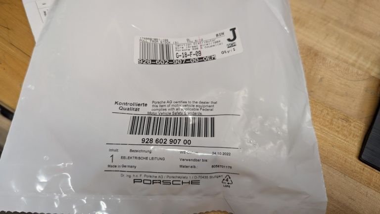

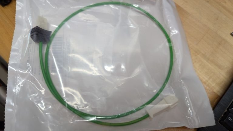

Old Jun 16, 2025 | 06:25 PM
Runbaken's Avatar
Runbaken
8th Gear
Joined: Jun 2025
Posts: 8
Originally Posted by Mrmerlin
NOTE Only use the Bosch green wire,
the less expensive URO brand has been demonstrated to have been poorly MFGd,
and will usually cause the engine to stop running
New question, how do I identify the Bosch versus URO? I bought a wire from Pelican a while back
but it only says Porsche OEM, not Bosch.
Old Jun 16, 2025 | 08:08 PM
Mrmerlin's Avatar
Mrmerlin
Team Owner
Joined: May 2004
Posts: 31,161
Likes: 4,158
From: Philly PA
the way to ID it as Bosch will be that it slides easily into the distributor and the lock plate does not have to be forced to hold the connector into the body of the dizzy.
NOTE you will have to carefully trim off the black spacer on the dizzy connector
Old Jun 17, 2025 | 12:25 PM
Runbaken's Avatar
Runbaken
8th Gear
Joined: Jun 2025
Posts: 8
No way to tell without removing it from the packaging and installing it?
