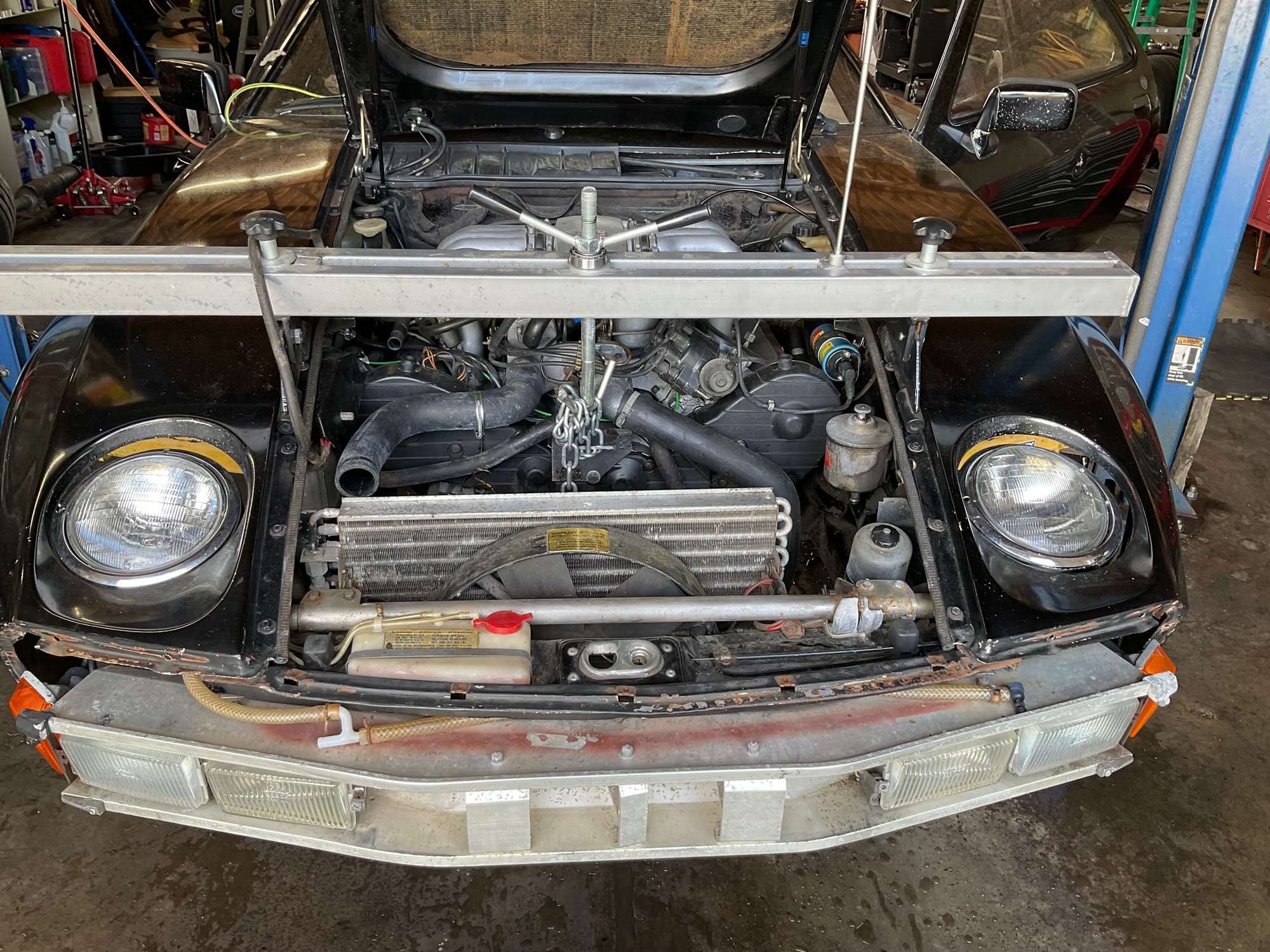

Ready to start
Ready to start

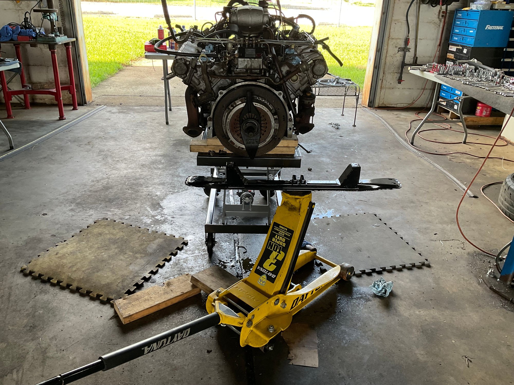

Checking from below, jack for the TT.

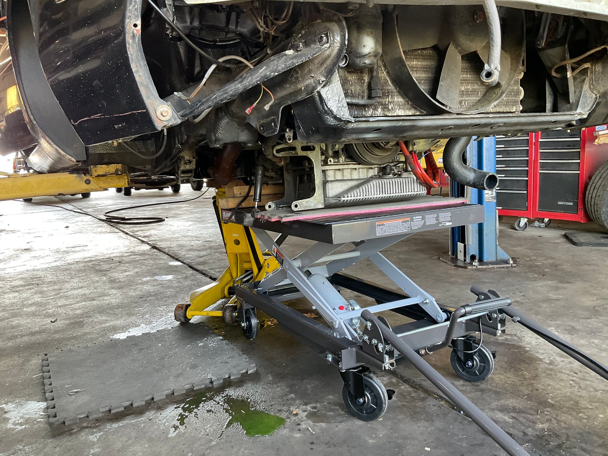

First few inches, looking for  hang ups
Free at last, free at last!

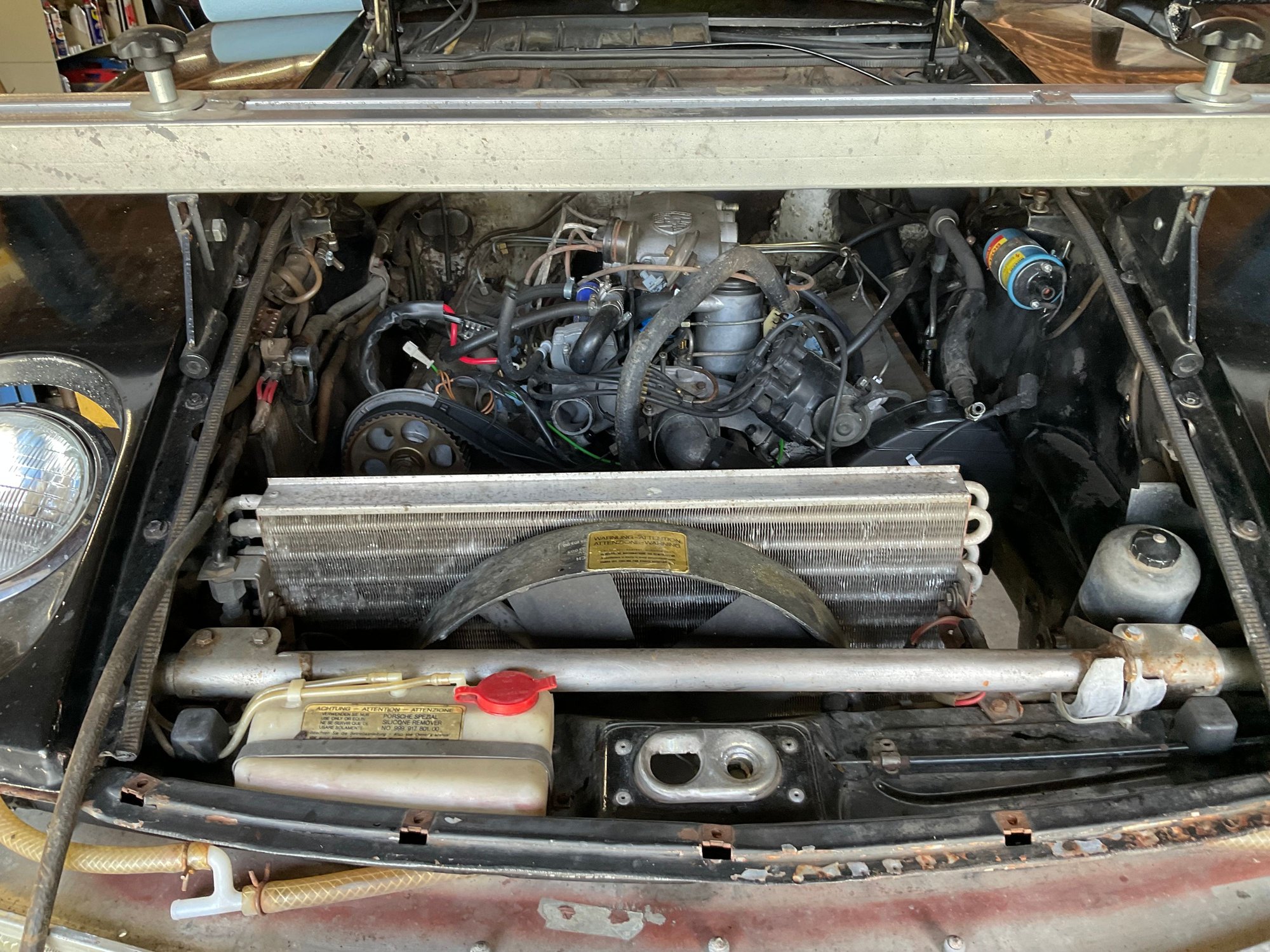

Issues with the cross bar hitting the splined shaft,  removed cross bar.

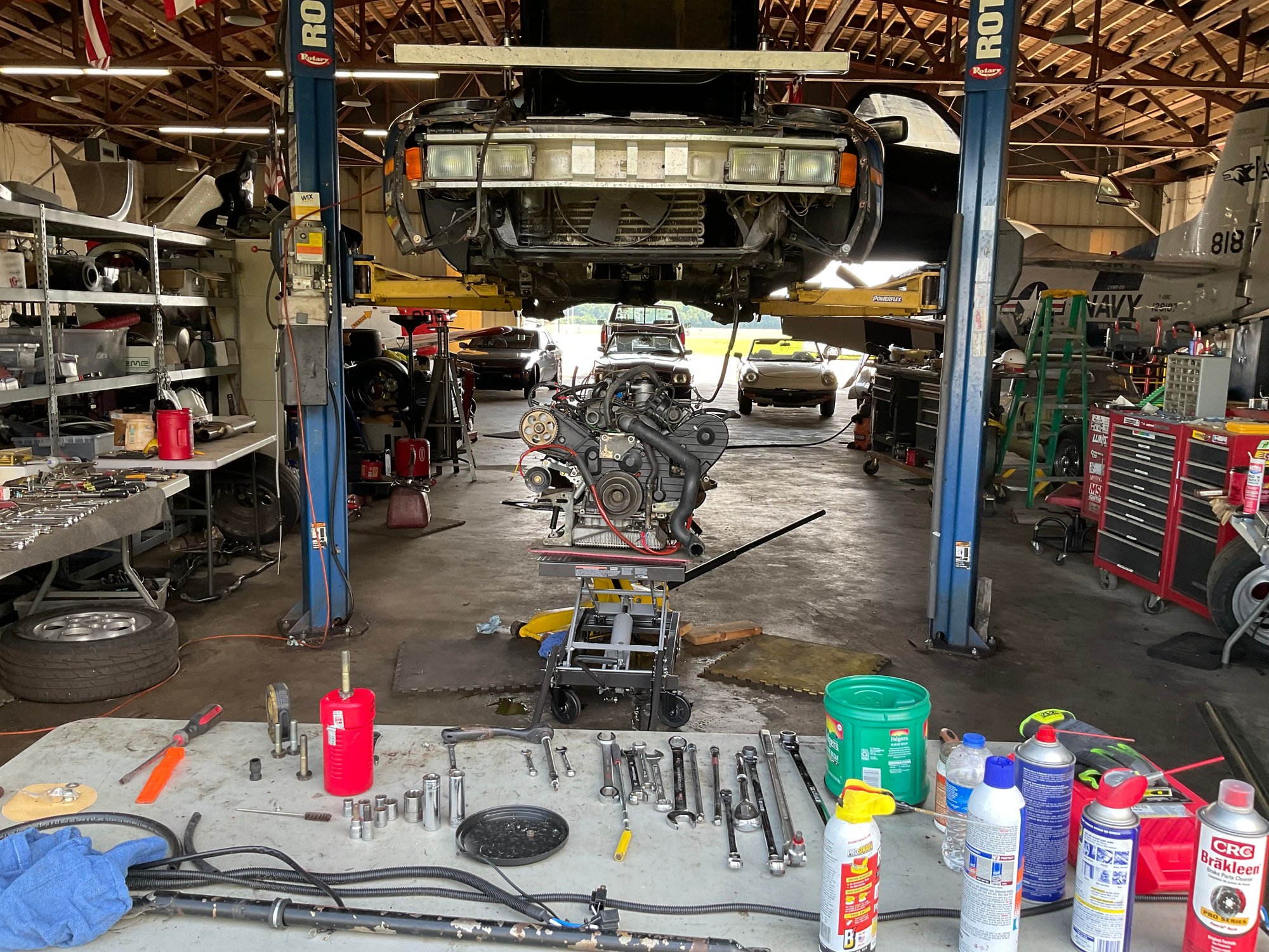

Back of engine, TT rest on the rear support piece for the heat shields.
so the engine is out a lot of little things, most of the hoses are original and in bad shape. Clutch job? TT to Constiantin? Got the WUR and a Fuel Director out for over haul.
