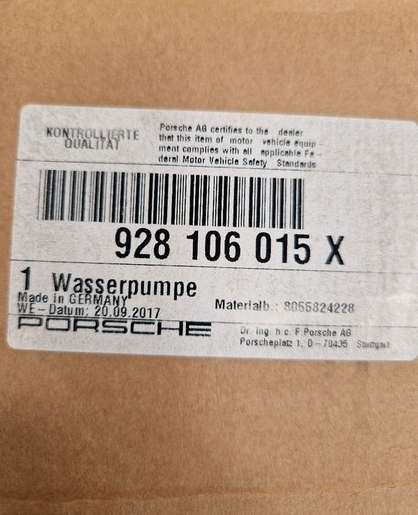

Preparing a belt and water pump replacement service I found this new and original water pump for sale for $600 but not sure about the reference.The seller says it is a S4/GT/GTS pump. The box says it was built in 2017.
Local dealer in Luxembourg quoted >$1200 for the water pump(!!) so is this one suddenly worth it? Otherwise what about GEBA water pumps?

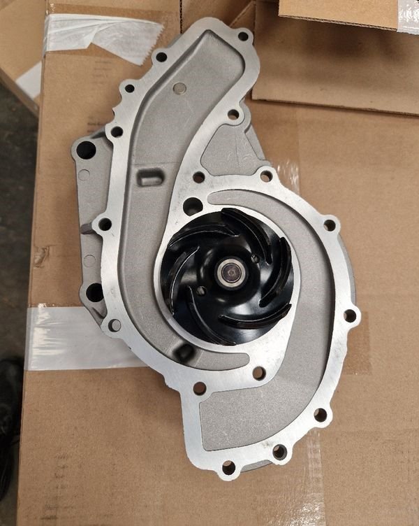

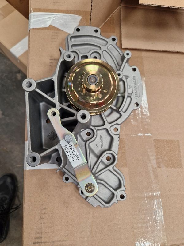

Hello, the coolant pump with the best track record is IMO the Laso pump. The one you show in the picture is not a Laso I think, but OEM Porsche. A good thing is that it has the plastic impeller (not cast iron). Check this out as reference:
http://jenniskens.livedsl.nl/Technical/Tips/Pics/Laso%20waterpump%2002.jpg
600$ is really a lot...
regards Theo
