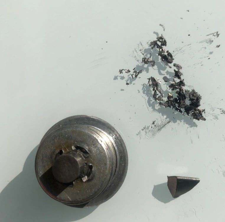

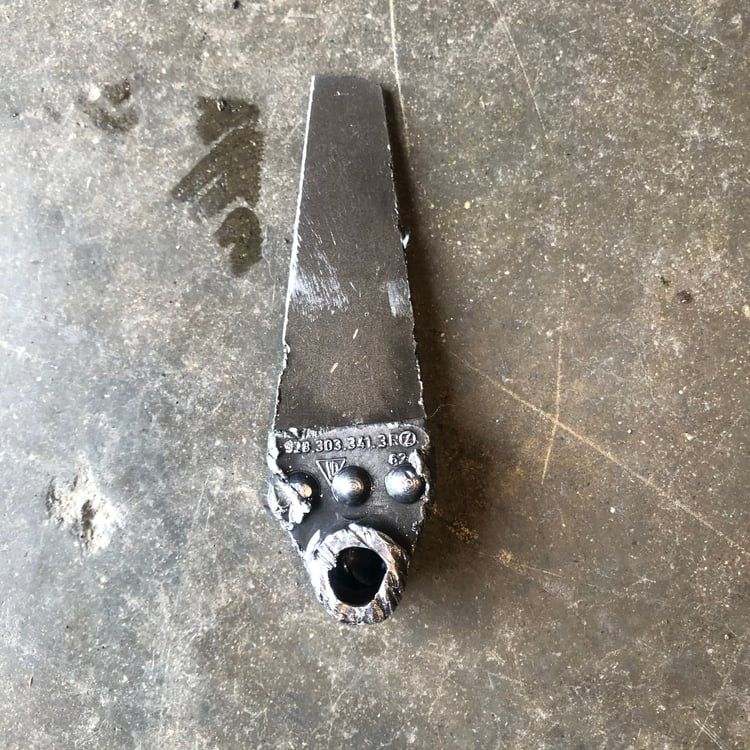

This is what happens when a piece of the centering spring drops into the transmission.
Amazingly none of the other gears seem to been damaged of course the part that was damaged is NLA.

Yikes!
been there done that before my heart goes out to you

But what I'd like to know is how that middle part of the first second gear was damaged. Obviously there's an issue with heat. But I don't understand the wear. I hope somebody can explain it to me.

Somewhat embarrassing. Took a ride to the shop in search of the centering spring to confirm my assessment. It's all there.
But, the new mystery is what the heck is the metal remnant we found on the bottom of the case. Keep forgetting to take a picture.
It does not appear to be a part of the transaxle. Howard is sure the reverse gear is new so somebody has been in there more than once. Once to swap the R&P.

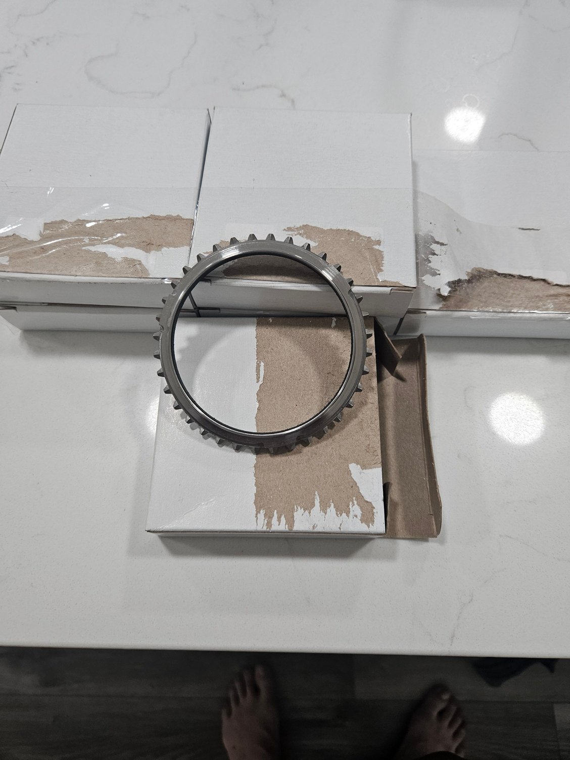

Just received six carbon fiber synchros for my GTS transmission along with a transmission gasket kit from Greg.

Nice! When Greg rebuilt the transmission in my 90, I probably should have had him put the carbon fibre syncros in just for the hell of it and upgrade the PSD discs to the 91+, but alas I cheaped out and left it stock. Not that I am unhappy at all with the results though. Shifts great.
