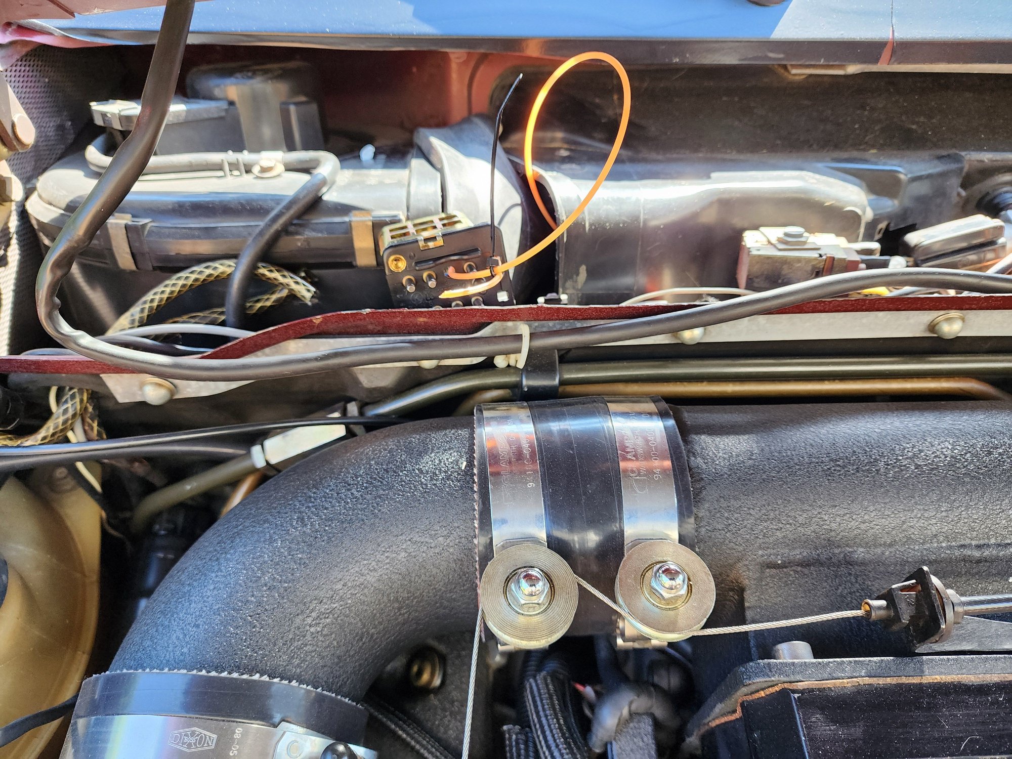

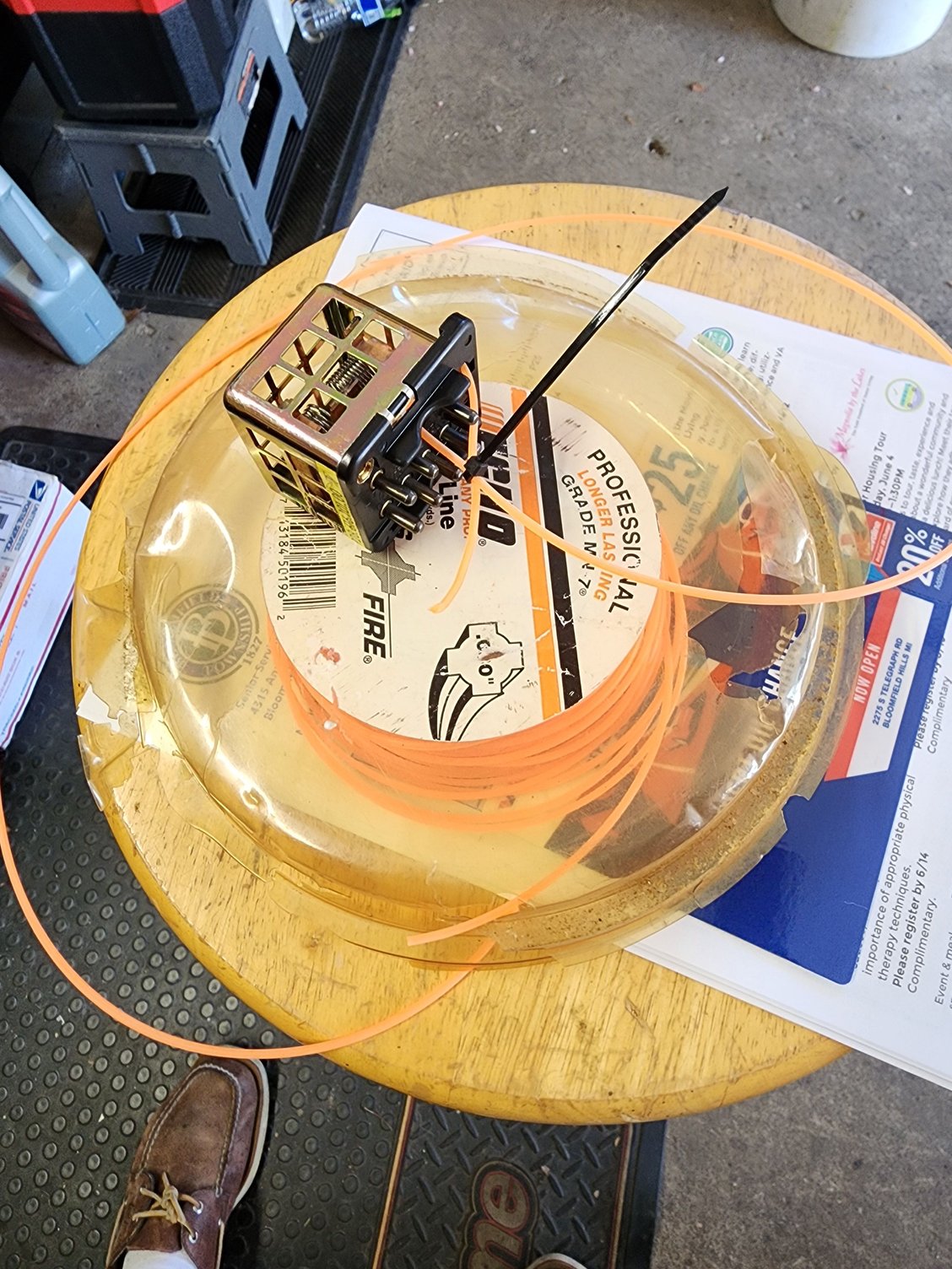

I changed mine out a few days ago on my 1986.5, the blower was only working on High or Defrost.
So I pulled the connector and plugged in a new one, all speeds now worked! So I went ahead with the installation (I did not move any pins around).
Using some weed wacker string it took about 15 minuets. Note: with this method get the top screw started then remove the string as the new unit won't fit in the hole with string attached.
Note: same part number as you have shown.

Thats a great idea Dave,
FWIW I put a shop towel under the work area,
so if I drop one of the resistor screws,
it wont go all the way to Germany.
Yes you can find it,
but it might require hood removal,
or a fishing expedition with a long magnet
