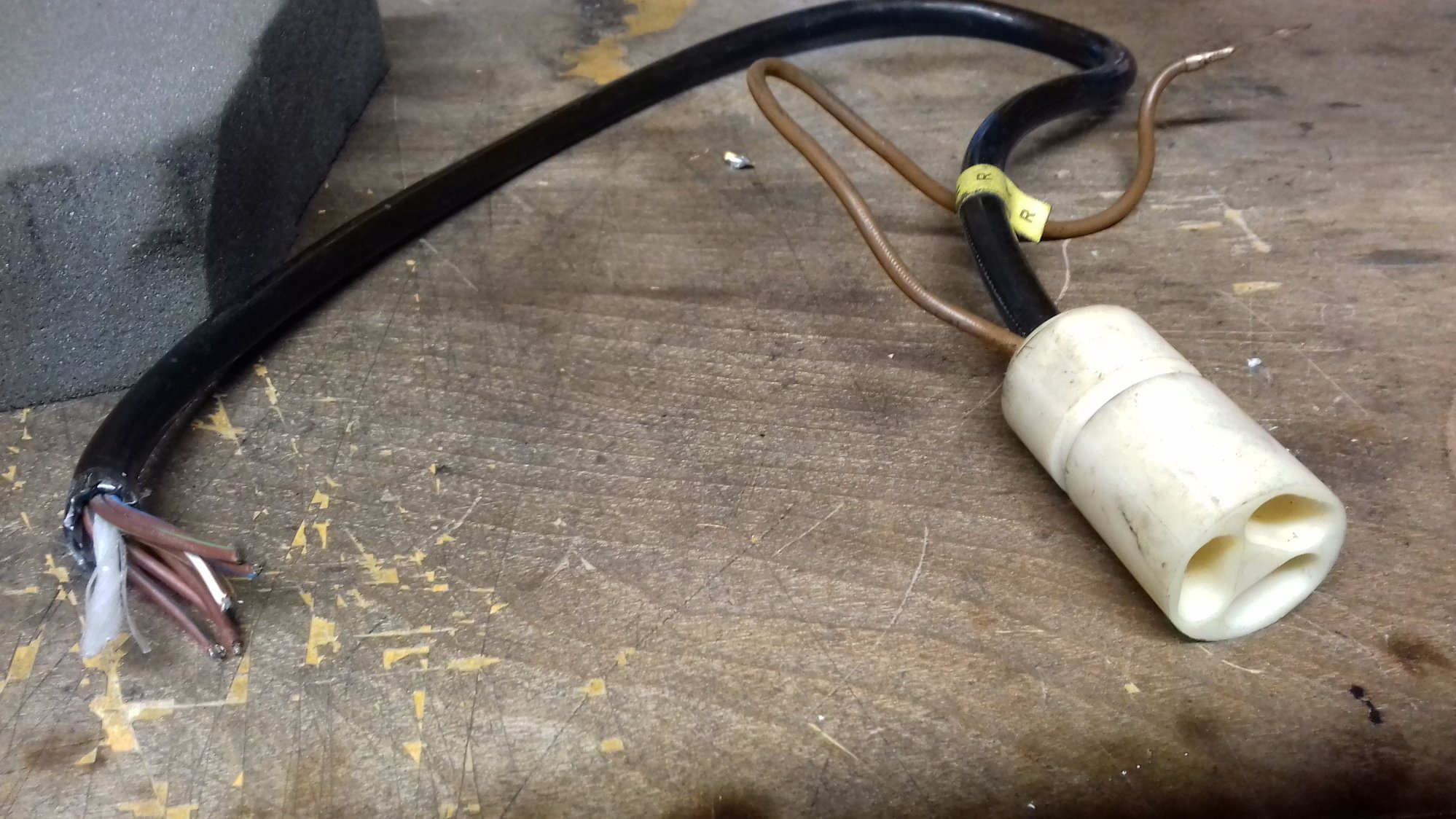

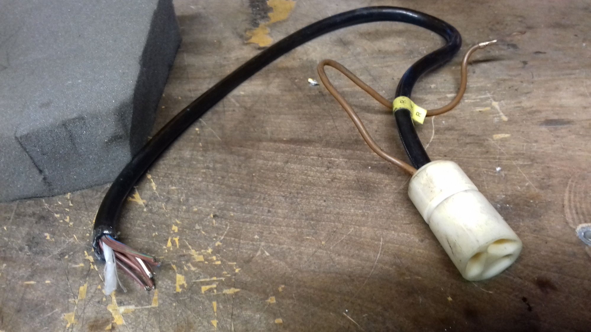

This is what the cable looks like.

as pictured the connector has 3x 2pin connectors in it and when i stripped the black sheath back there are 7 wires.
checked continuity and none of the terminals of the connectors go to the earth.
i guess its just a sort of shield earth cable to try to stop any interference between the other wires.
i cannot see this being your problem
cheers
Phil
