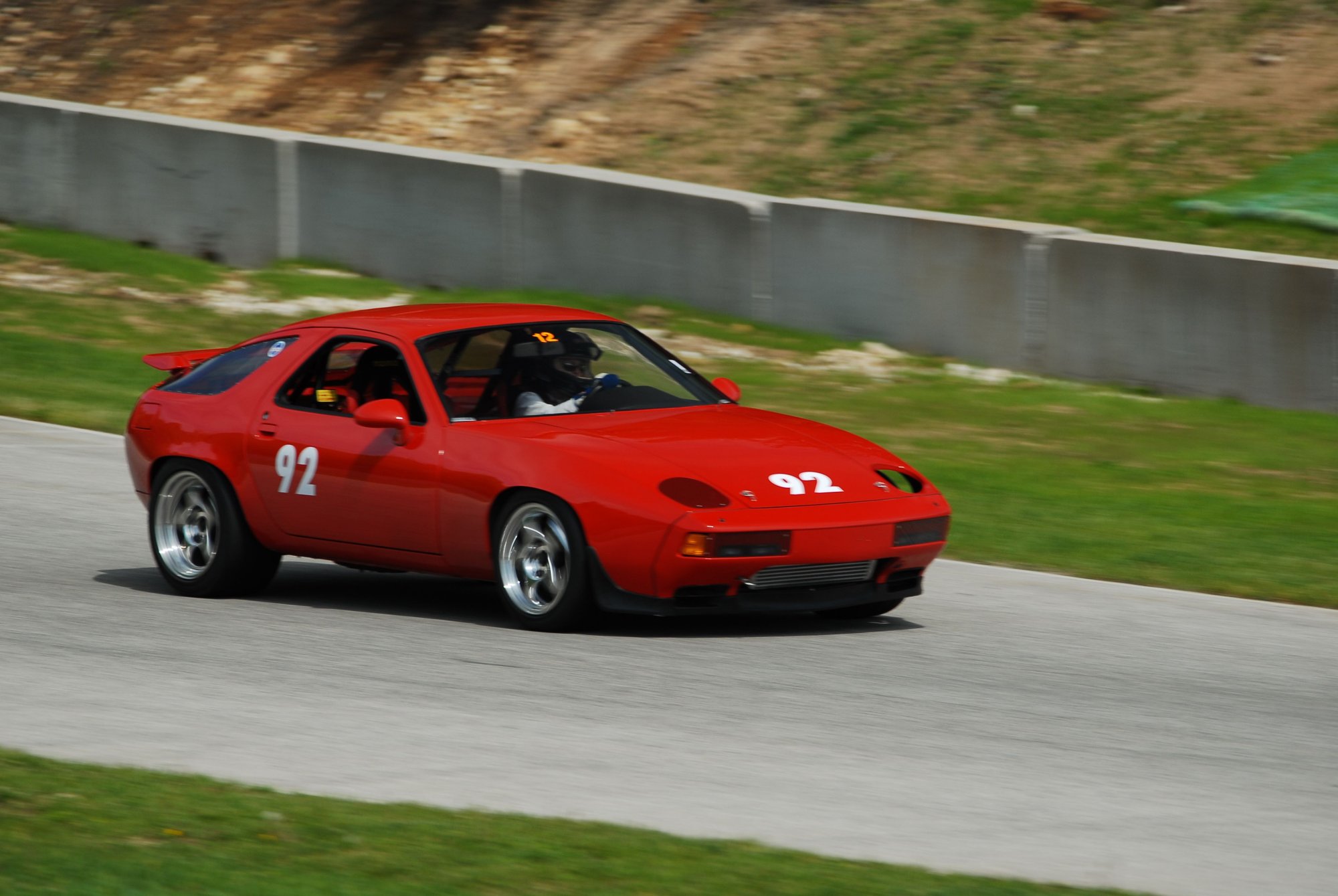

Originally Posted by Petza914
...and it's supercharged?
We know a thing or two about boosting 928's up here
Notice the date stamp on the photos, that's how long this combination has been running, still going strong.
