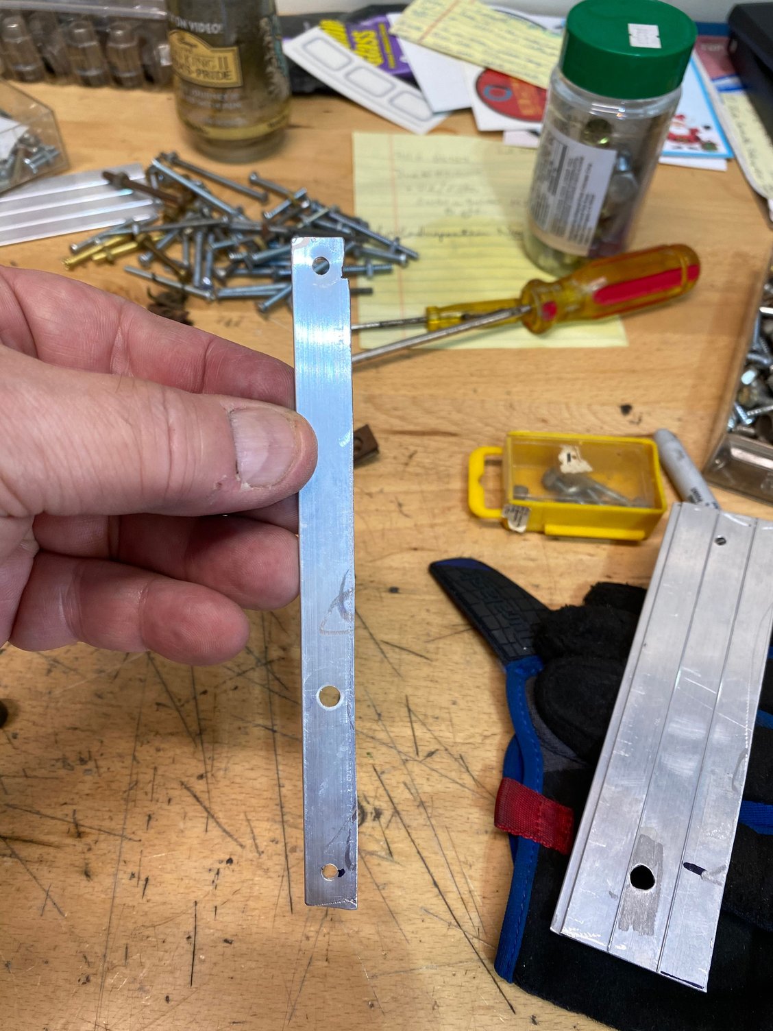

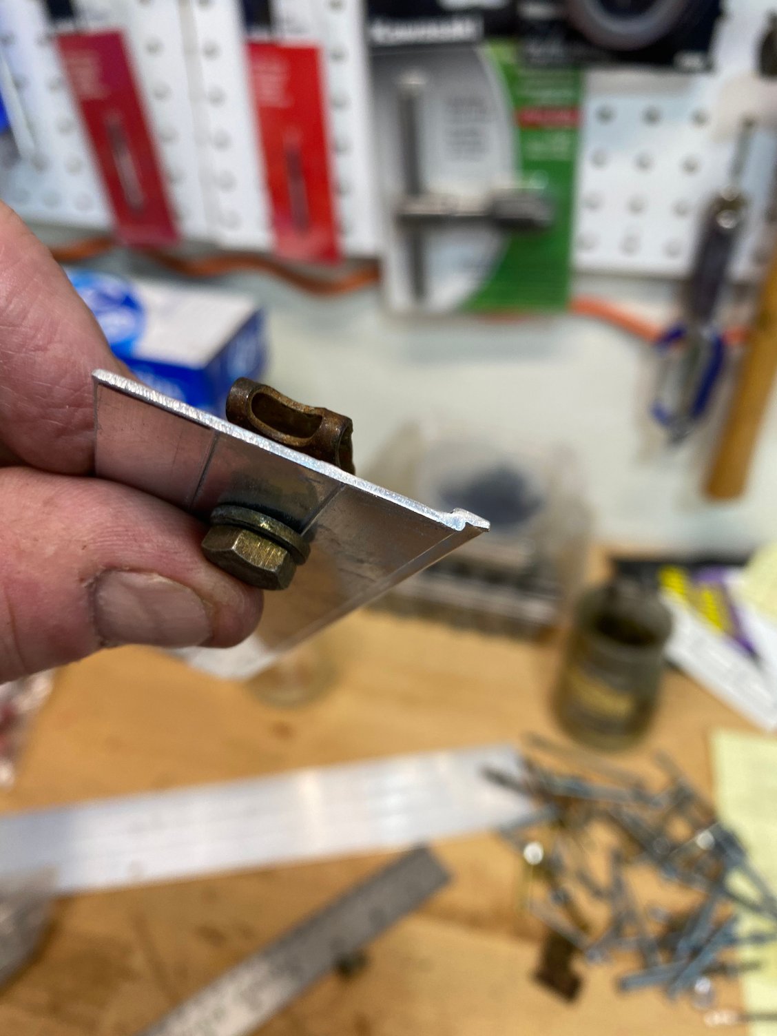

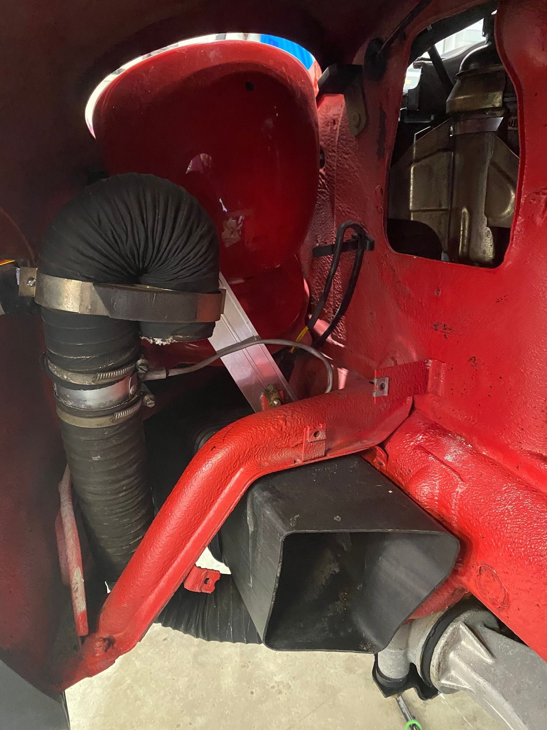

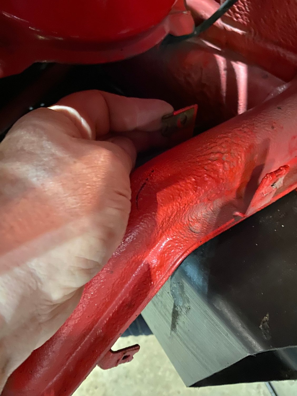

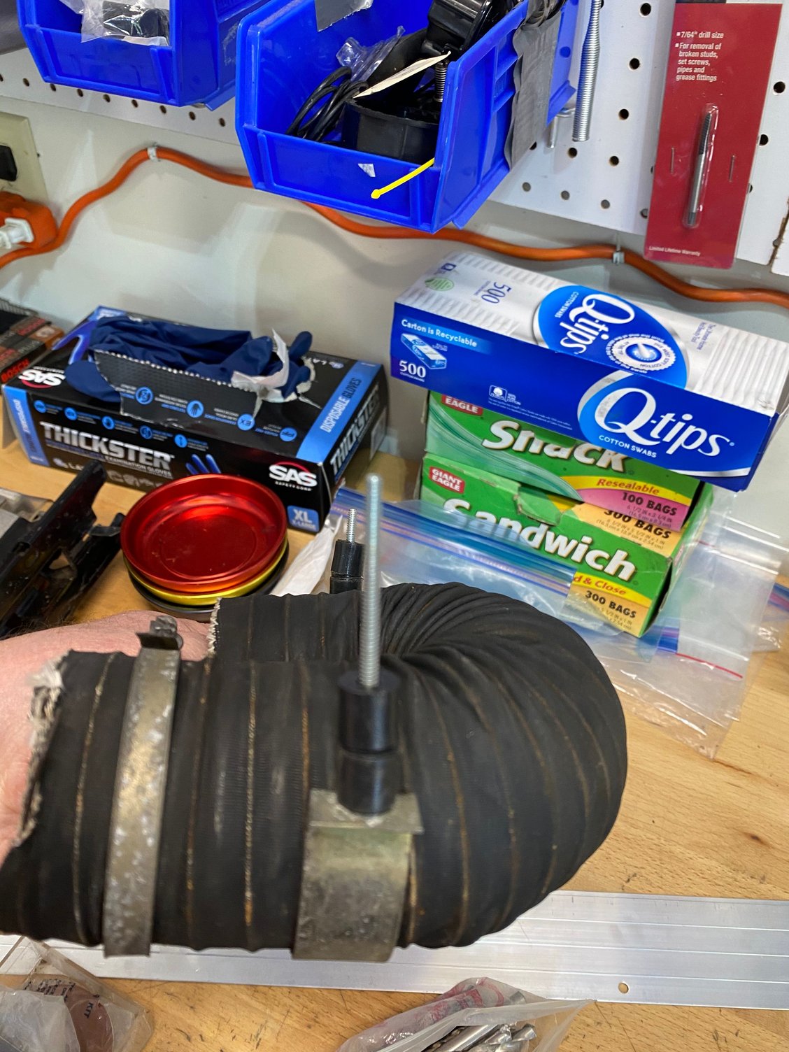

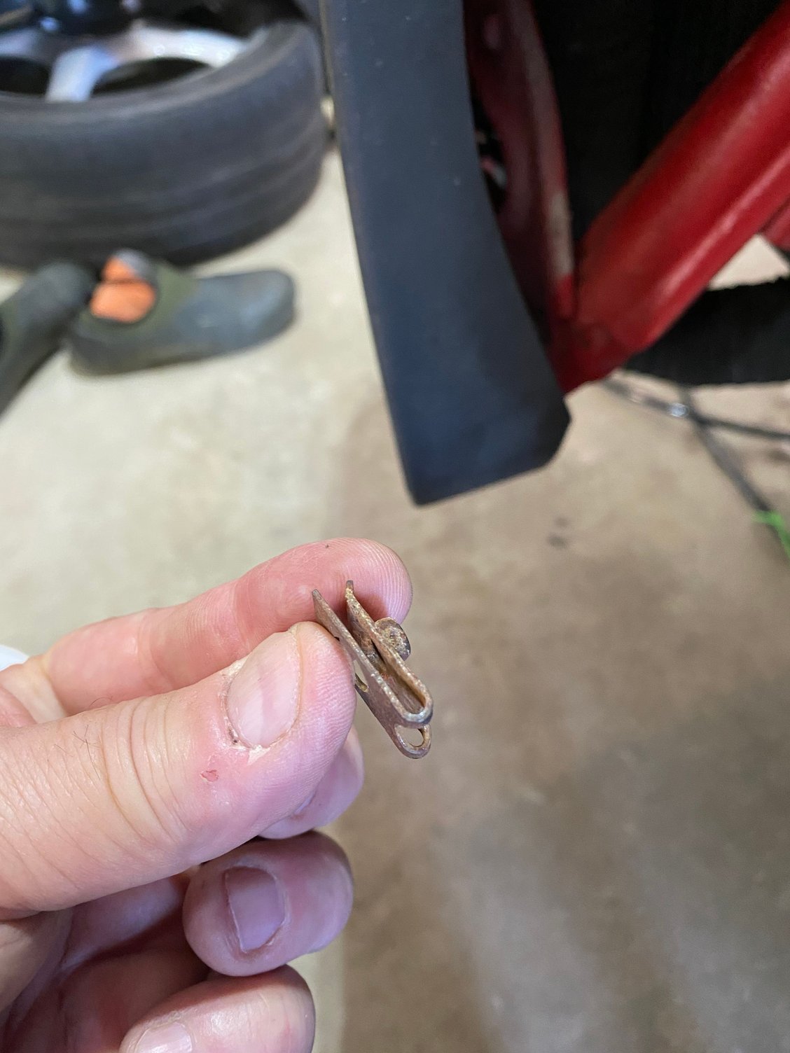

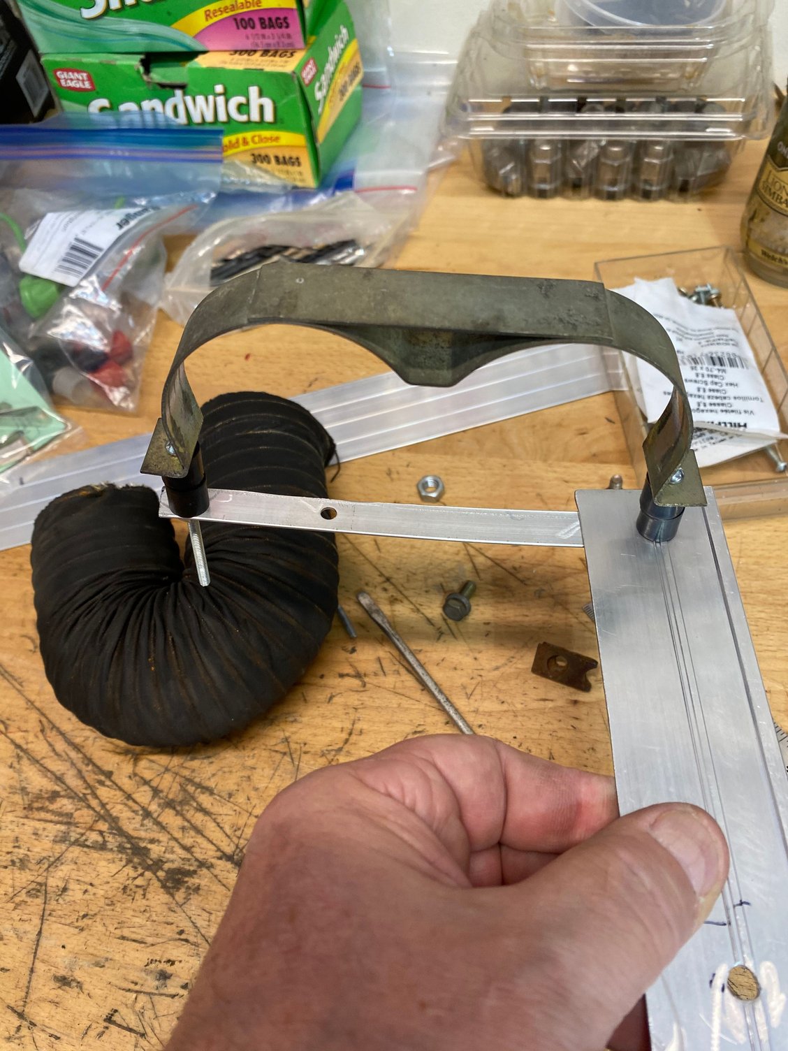

Here's how I resolved that terrible alternator duct hose design issue:
Old Jan 17, 2022 | 10:26 AM
linderpat's Avatar
linderpat
Joined: Nov 2006
Posts: 14,880
Likes: 2,801
From: Pittsburgh, PA
more
Note - added a piece of adhesive backed foam to where bracket will contact the plastic liner:
Old Jan 17, 2022 | 10:30 AM
linderpat's Avatar
linderpat
Joined: Nov 2006
Posts: 14,880
Likes: 2,801

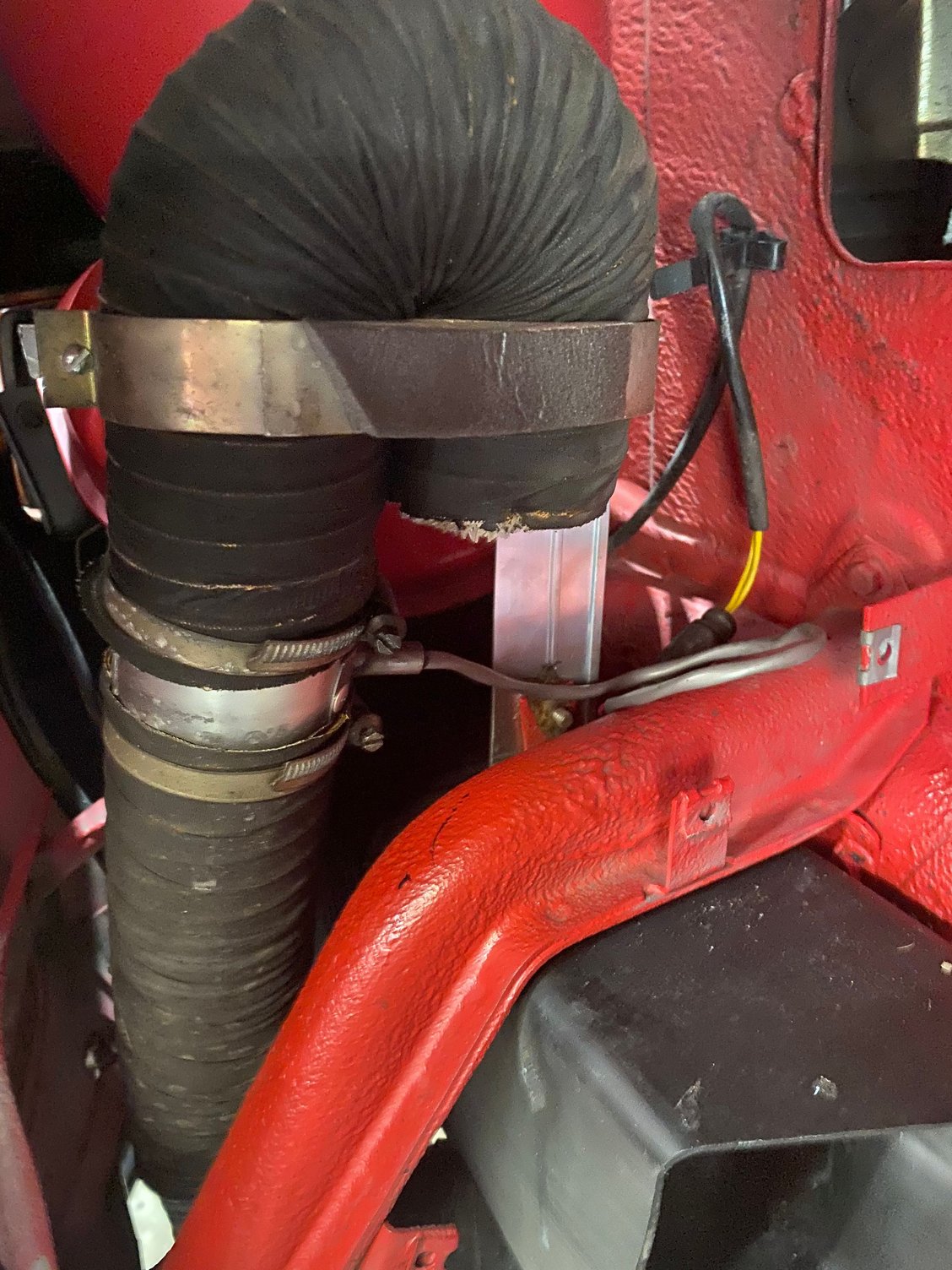

fini:
