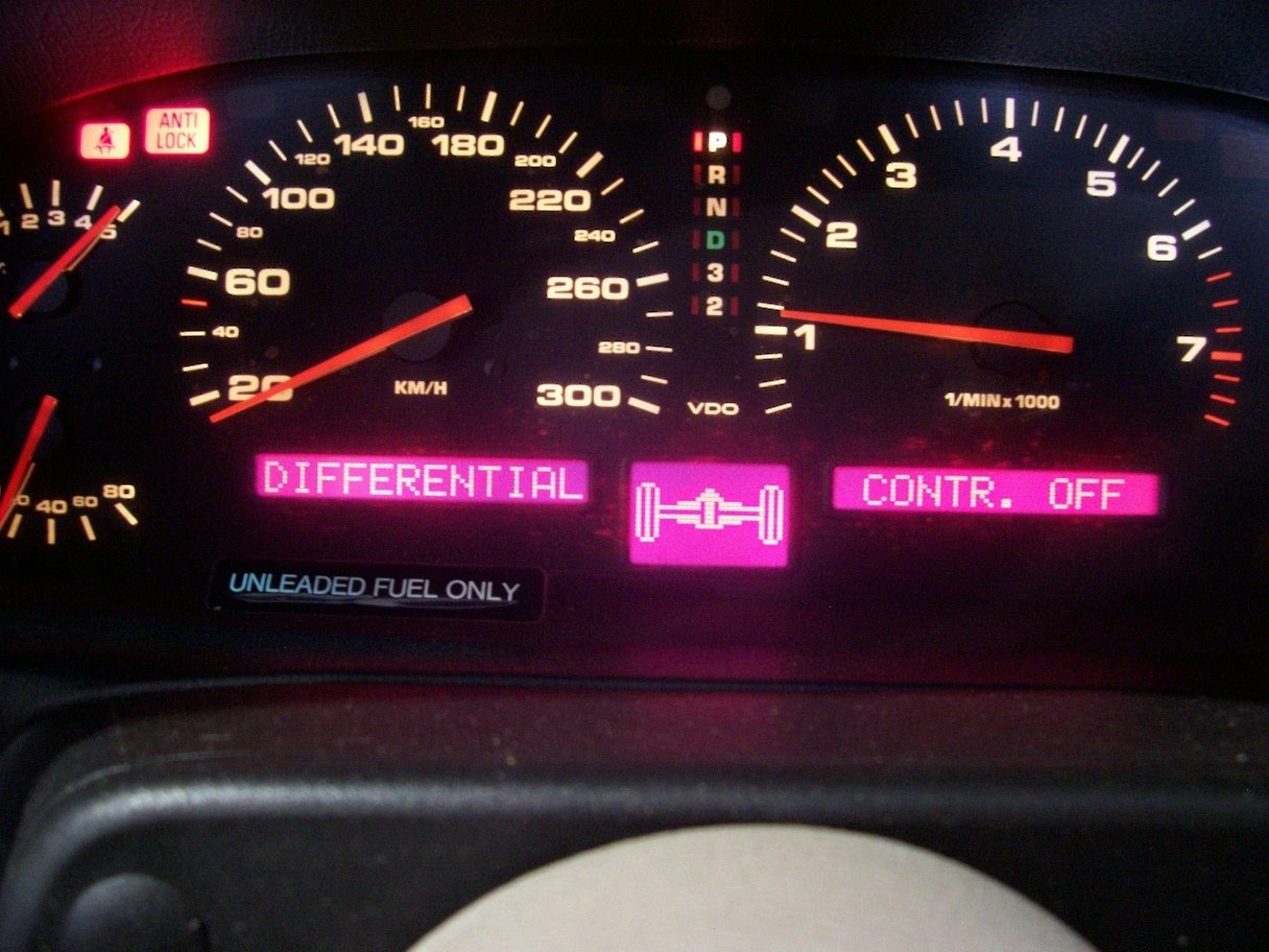

On engine start up we get, Antilock off. with a little bright red diagram of a brake disc with an exclamation mark in center.
Then it scrolls to, Differential Contr Off. little diagram of a diff in middle.

The ABS warning coming on immediately after start up indicates a 'control' problem. The control unit does a self check on start up. Something is causing that check to fail. Could be a power issue (relay), could be a 'brain box' issue, could be something else. If the light stays off until the car starts to move, and then lights up, it's usually a sensor issue.
The "Diff Control Off" is coming on because the PSD is tied into the ABS system. If the ABS isn't working, neither will the PSD.

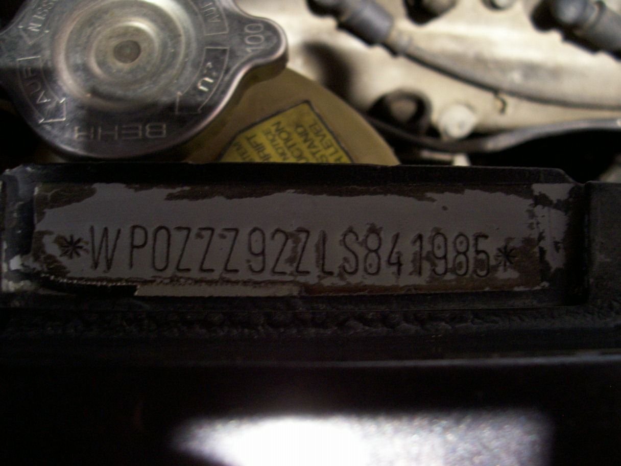

vin from plate on inner front guard/fender WPOZZZ92ZLS841985 pictures as requested. I'm not up to speed on posting these so I hope you the images are ok.

It's a 1990 S4.
Put the VIN into the decoding thread on top of they page and Rob will give you more infos about your car.

On a 1990 S4; if your PSD diff is throwing a fail (like in your pic); then you will also more than likely get an ABS fault. Just my two cents, but before you chase the ABS fault, go and get your PSD pump serviced. I also think an abs fault will disable the psd.
If you are mechanically inclined: search this forum for guidance on the PSD. I'm not sure if its in the DIY section, but start there for sure.
