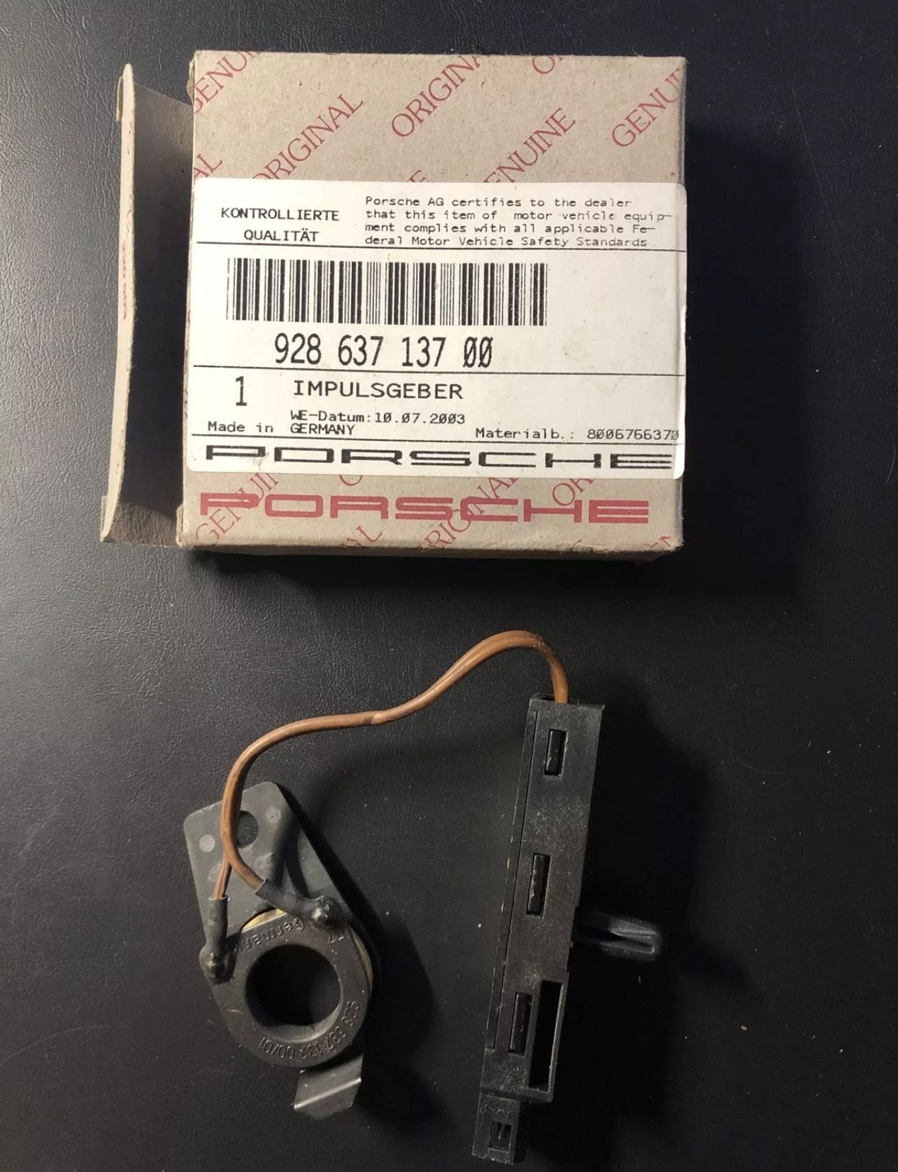

Default Alarm flasher
Does this unit have any other purpose than make the alarm diode flash?

Oki, Im chasing a ''double flash'' on the alarm diode. Only the diode on the passenger side door works.
Acc. to the owners manual the manual the ''double flash'' means central locking failure?

Correct. All is closed. I havent connected my diagnostics yet. I will check the what is bothering the system. One thing is for sure, the drivers door does not flash at all.
And, sometimes, only sometimes, when I lock the drivers door it locks and immediately unlocks. Then I have to lock it from the pax door.
