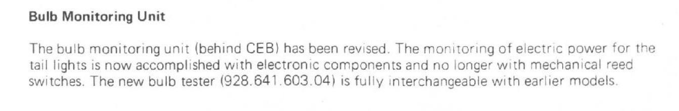

I had a similar problem with my '83. In 1984 Porsche introduced a new bulb tester that was all solid-state instead electro-mechanical. See excerpt below.
I changed mine out with a used new-style unit that I obtained from 928 International. Somewhat smaller, but works perfectly.
