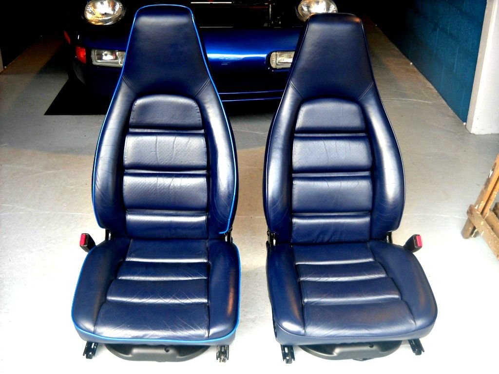

Like Dave said.
The most important thing is preparation.
If you take your time and carefully follow each step, you will get good result.
I did mine with ColorPlus products few years ago and had good result.
I used an air brush.
Here's a link from ColorPlus site about preparation steps:
https://colorplus.com/pages/color-pl...n-how-it-works
Going to black should not be a problem.
Here's what mine looked when I did them.
The piping was done (repainted by hand) only on one seat when I took the pictures.
Good luck.
