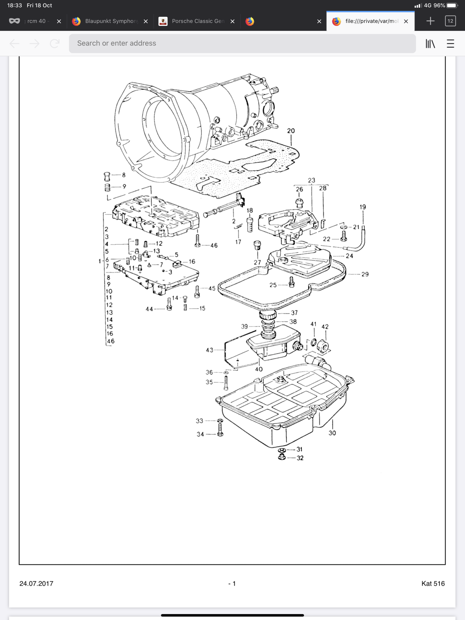

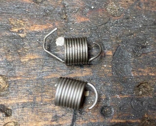

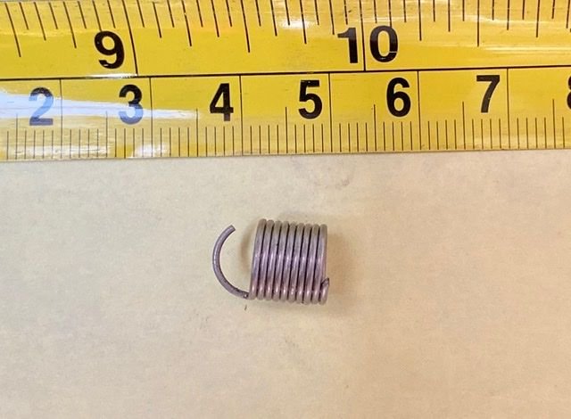

So, I was changing the ATF oil / filter on my 92’ GTS with the A28/18 30 automatic transmission, and found this spring, or part of a spring in the sump.
Where does this spring belong? I take it that its #17 in the parts drawing.

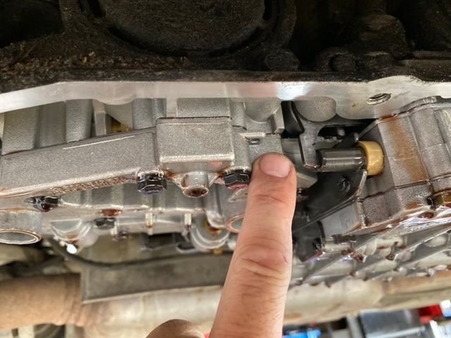

The most likely location I can find is here:
Any pointers?

That looks like the correct pointer

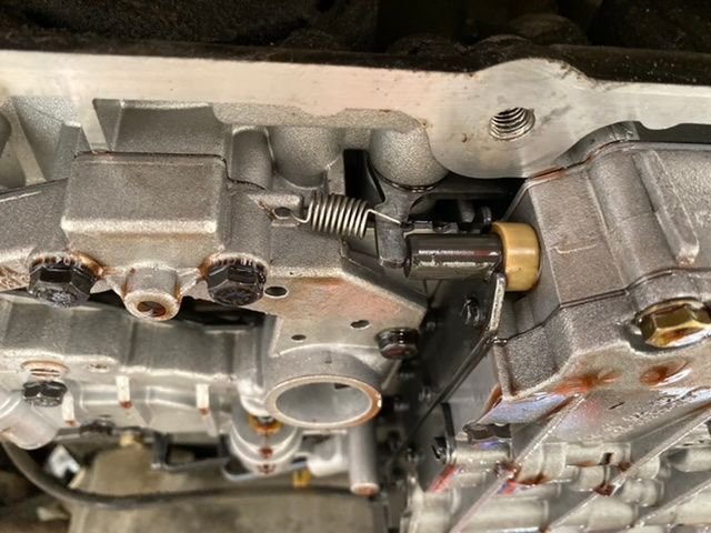

Sorted. Found a spring on the 88’ autobox I have in pieces in my workshop.
Cheers...
Installed. Happy days.
