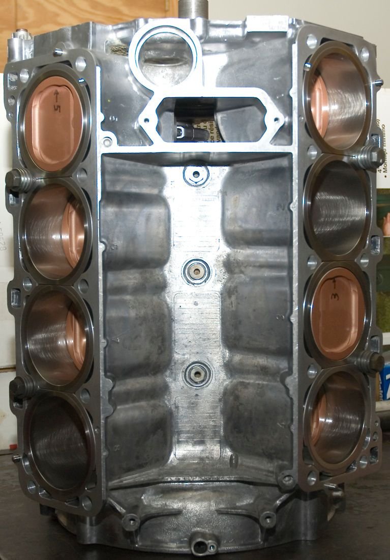

i actually did some math/measurements on how big you could go, a few years back:
Darton sleeves with .090 thick walls, triple o-ringed on the bottoms, flanged tops, half filled with Hard Block.
moldex custom billet crank
carillo titanium rods
pistons will be fun, as your pins will be way up in the ring grooves.....
454 cubic inches.
cant run Aluminum rods because of clearance issues. Too much cutting on the pan rails and girdle— remember, mail bearing oiling is via the galley in the black/girdle mating surface. You’ll have to prolly do external oil lines feeding each main bearing and dry sump. besides, you’ll be pulling the rods every 50 runs or so to check for stretching.
alloy is is great for absorbing the compression stroke shock, but they just wont fit in the crankcase with a large stroke crank.
S4 or later heads with big valves and huge CNC port job for sure.
sheetmetal intake with front entry throttle body- maybe 115mm.
then you get into Cams and buckets... and that damn mile long timing belt.
i know of only one guy who can make cam buckets for above 8500 rpm range... and he’s no guarantee. Your stepping into F1territory and a gazzillion bucks....
seriously... your BBC is much more reliable and certainly more cost effective

Car looks great. Glad to see another BBC 928. Girdle and oiling were a definite oversight on my part. I’ll have to look closely at it. As far as cost effectiveness, it’s all good money after bad 😀

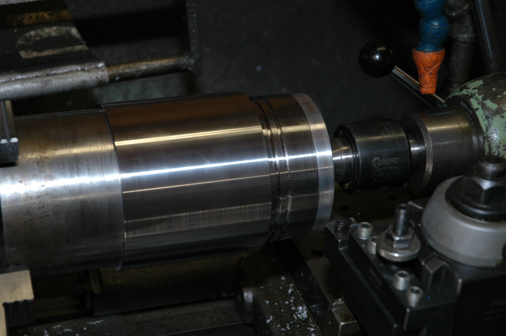

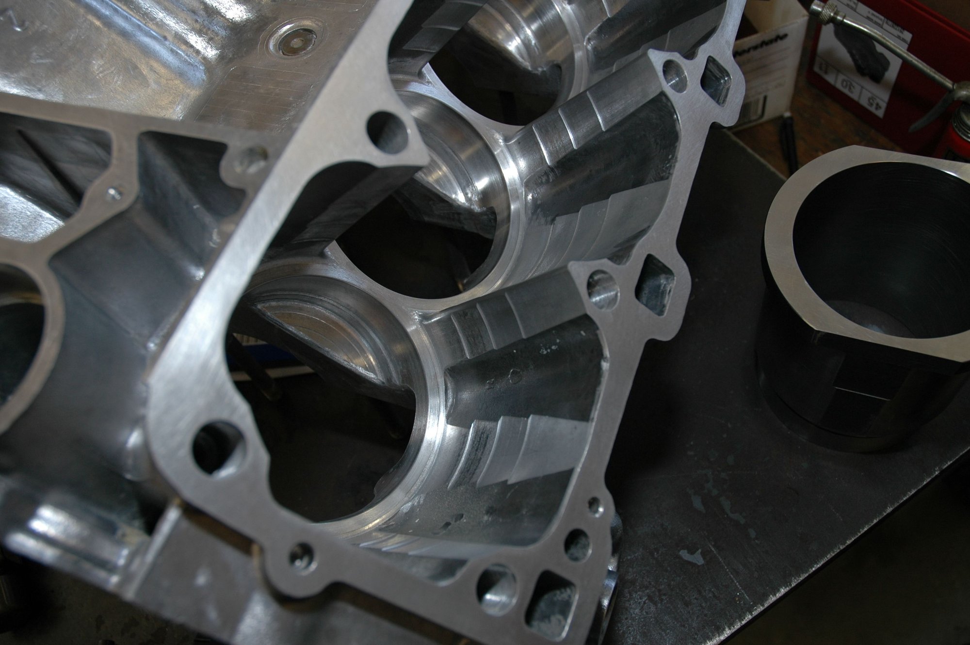

Dan,
Todd is very excited to see your new project progress (hell, he loved the BBC version too). He knows a thing or two about cutting out the stock cylinders and placing new ones.
He built this 427 shortblock for someone, Todd made his own cylinders.
If you would like to chat with him let me know, he has a very odd work schedule these days and I'm sure he would like to talk to you about your project.

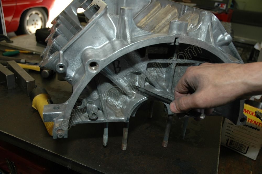

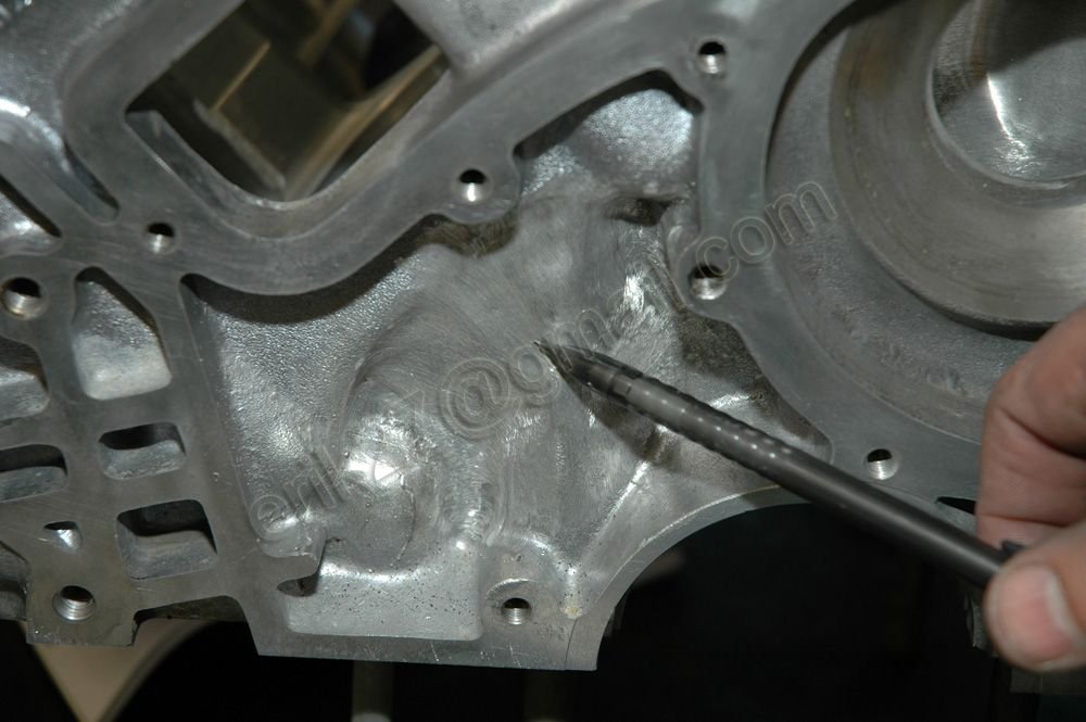

When boring out the 928 engine block for large 7L liners you will brake through at the left bank rear end and at the right bank front end which both Todd and myself have found out the hard way.
Åke

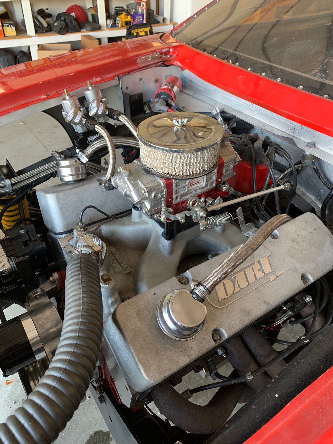

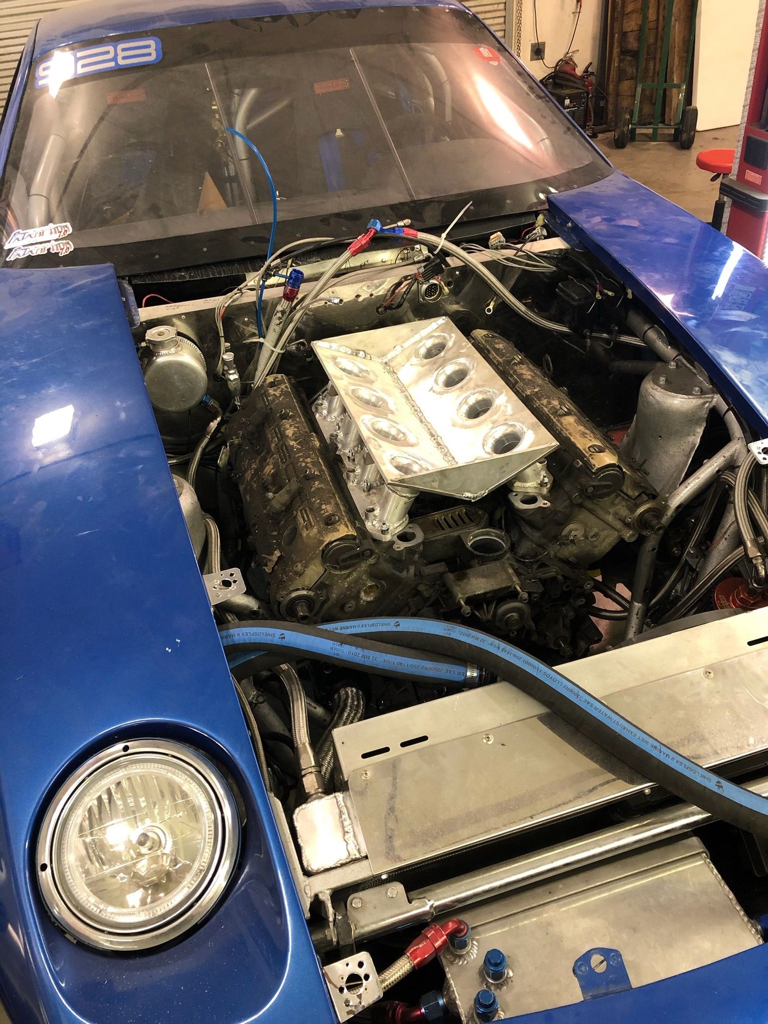

Update, Set motor in car for mockup. Motor mounts and midplate are done. I really wanted to do a front motor plate, but there just aren't any mounting point on the front of the engine. Picked up a pair of these 80mm bad boys. Fitment is gonna be fun. My plan at this point is to race the car with the big block in 2020 while building the engine. Gonna try to get started on the headers and turbo mounting but will have to put the big block back in by the end of January to be ready for next season. Depending on where I decide to mount the turbos, it may require some fairly major surgery, so it may have to wait until the end of next year.
