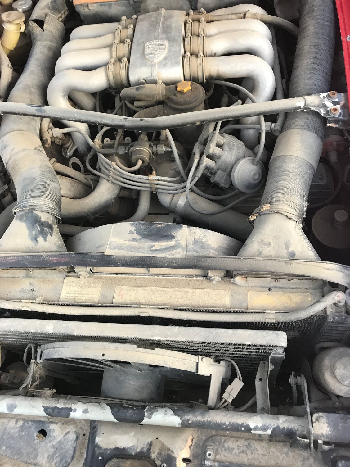

Alright so I gave my local Porsche dealership a call to see if the key was why my 928 won’t crank and the answer was no... so I tested the starter and it worked perfectly. I tested my battery and it worked perfectly. So I think there is a bad ground or bad wiring between the ignition barrel and the starter or power isn’t getting to the starter... any ideas anyone?

Good to see you took down the pic of the key, but you could have left the basics of the post up.
The car may or may not have an alarm. It was optional, but it's a very common option.
However, while the alarm will prevent the car from starting, it won't keep it from cranking.
First two things that come to mind if it won't crank from the key, but the starter spins when you put power to the S terminal are ignition switch and starter relay.
Relays are wear items in this car. Most of us carry a spare or two as a matter of routine.
The ignition switch will wear out over time.
The simplest check would be to get down to the CE panel (under the passenger seat floor at the front). Have someone turn the key. If several relays can be heard to click when the key goes to start, the switch is likely good. Part of what it does is shut off power to some circuits when it cranks. You should hear those relays click off when it goes to start.
Also, if your horn works, simply swap the horn & starter relays. See if the horn still works, see if the car cranks.
There are more detailed things, involving the 14 pin connector, but the above should give you some ideas where you need to go.

92s,
First, welcome to Rennlist.
Second, you need to identify the model year of your 928. I don't think it is a "92s". By the looks, I'd guess between an 81 and 84.
Either way, the horn and starter relay will be in the same location so it won't matter for this test. See attached for an '82.
Follow Wisconsin Joe's advice:
First, honk your horn. Why do this? Because you want to use a known good relay (horn) to replace the starter relay, which may be bad. And the horn relay and starter relay are the same replacement relay.
If it honks you know you can borrow the horn relay for this test.
If you turn the key and lights come on and other relays "click", then it may be the starter relay (at relay XIV).
So, take the horn relay "X" (which you confirmed is good) and replace the starter relay with it.
Test and report back.
And look for another engine bay brace. It is not supposed to look like that.
