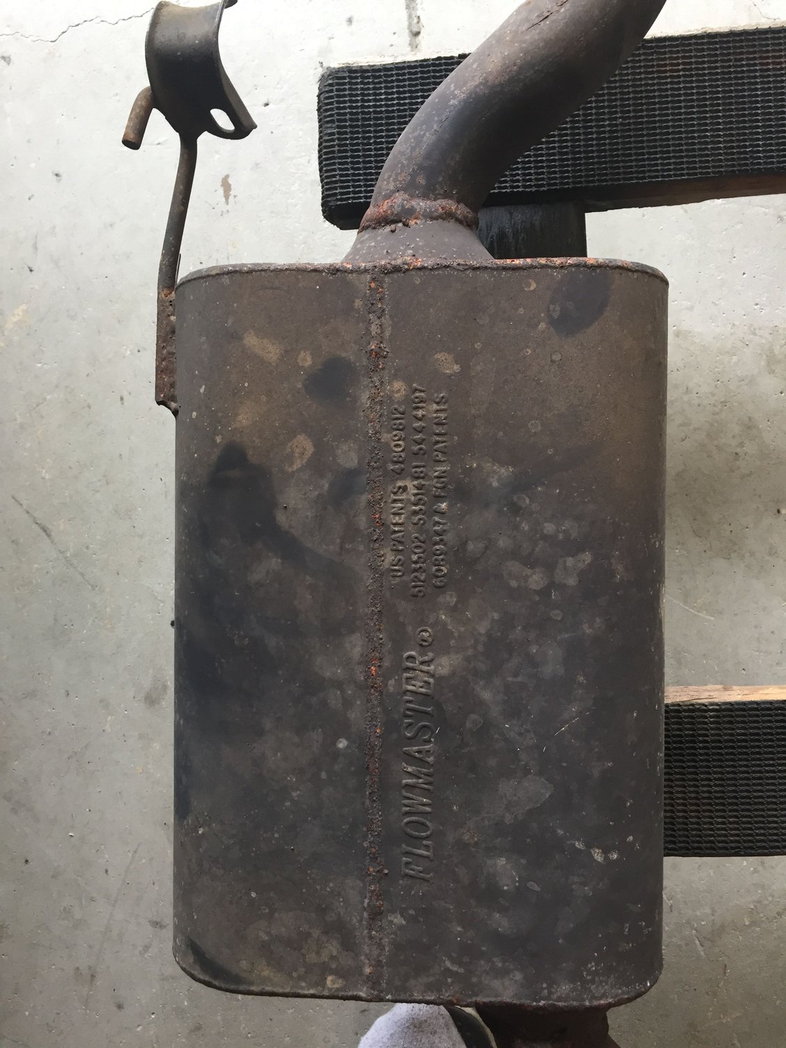

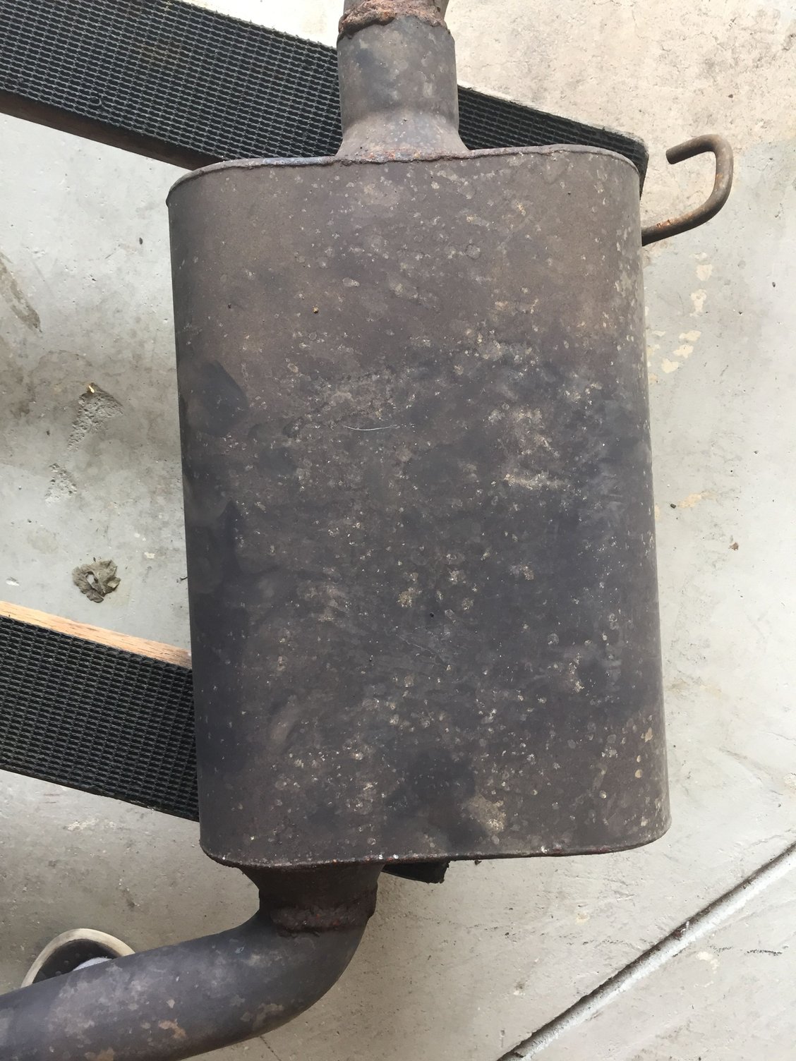

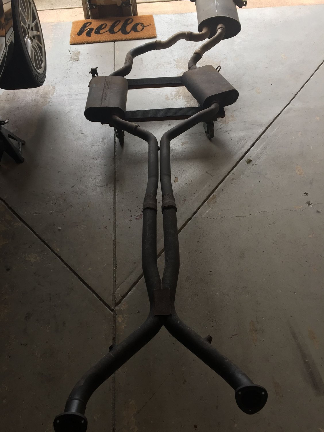

got the exhaust off. Rust looks like it will be an issue in the next 5 years. Is there anything I can do to slow the rusting process?

Ash are you talking about the exhaust rust?
If so you might consider getting the system ceramic coated at your local powder coater ,
or you can try Jet Hot coatings.
Or the easy way buy a few cans of hi temp spray paint and recoat the system then drive the car to cure it

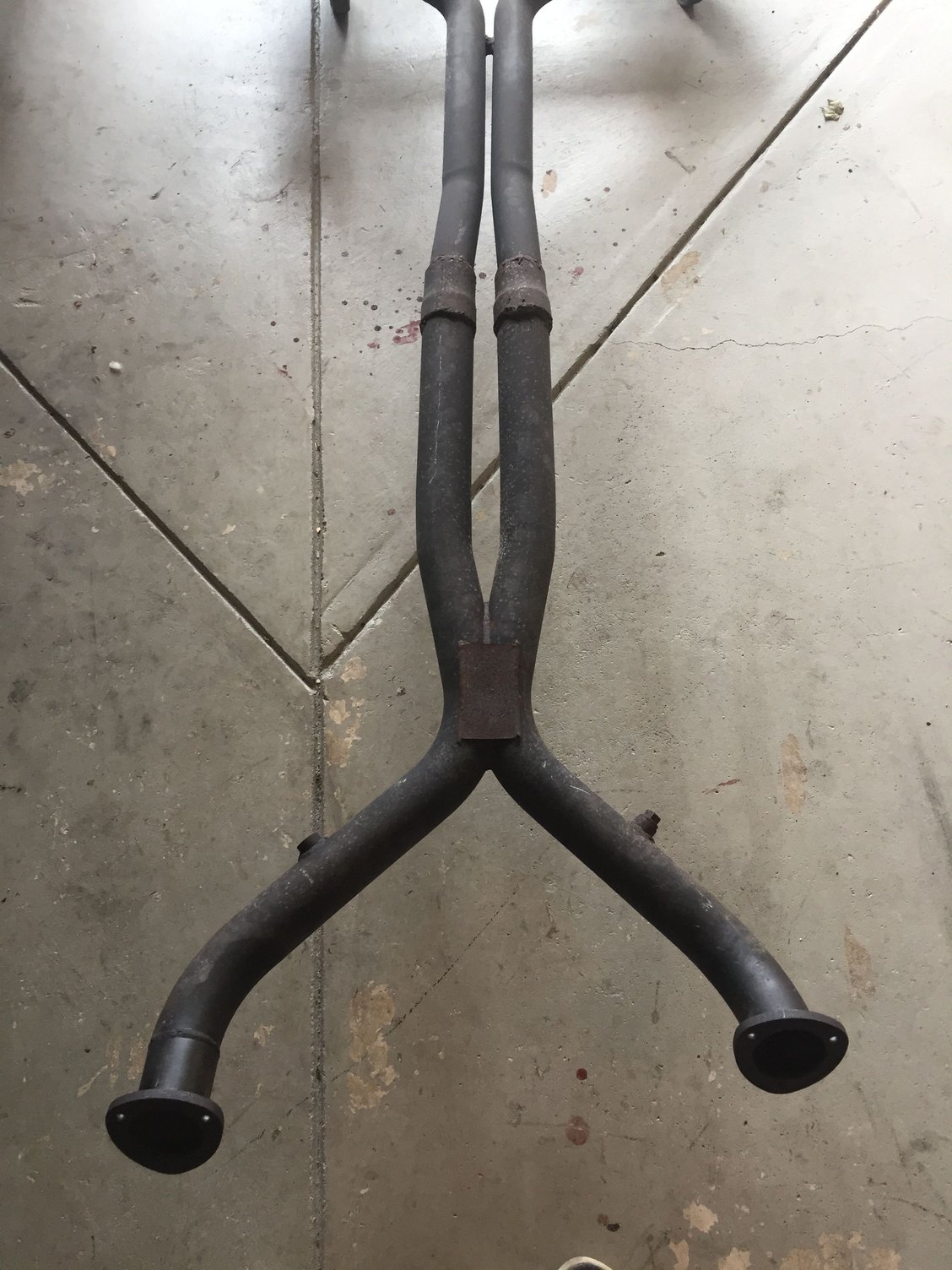

Thanks Stan. Do the pipes where the muffler is attached looked oddly shaped to you?

they are off a bit but it looks like a hand made system
