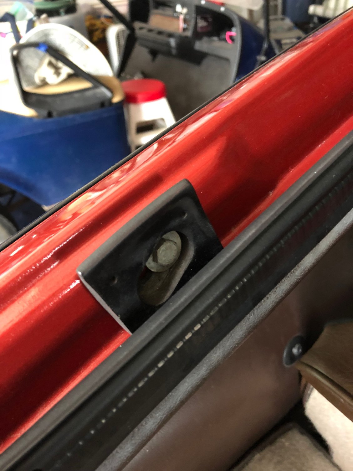

What is the proper adjustment/adjustment procedure for these bump stops on the hatch?
Can’t find in WSM.
thanks!

They float loose on all 3 of mine. Don’t think I have ever really messed with them tho

take a sheet of paper,
cut a strip off of it about 10 inches long lay the paper over the rubber ,
then close the hatch,
see if the rubber is contacting the hatch,
you will know this by how much drag the paper has as you pull it free,
adjust the rubber block upwards till both sides have even friction on the paper
Nice tip Stan, I like it!!

My hatch sat high like that for years until I replaced the white plastic upper hatch latch piece that had worn over the years. Once I replace the part the hatch pulled down securely into place eliminating the raised hatch line.

Mine rattled on rough roads until I replaced the cracked latch tongue in the hatch. Another help in removing noises is to fit the teflon patches - 928 512 531 02.

I was always told to adjust it using a dollar bill (wont tear as easily as paper) using the same method described above by Stan.
It got rid of a fair few pops and squeaks for me. Just be sure you have the teflon sheets that these rub against on the hatch.
