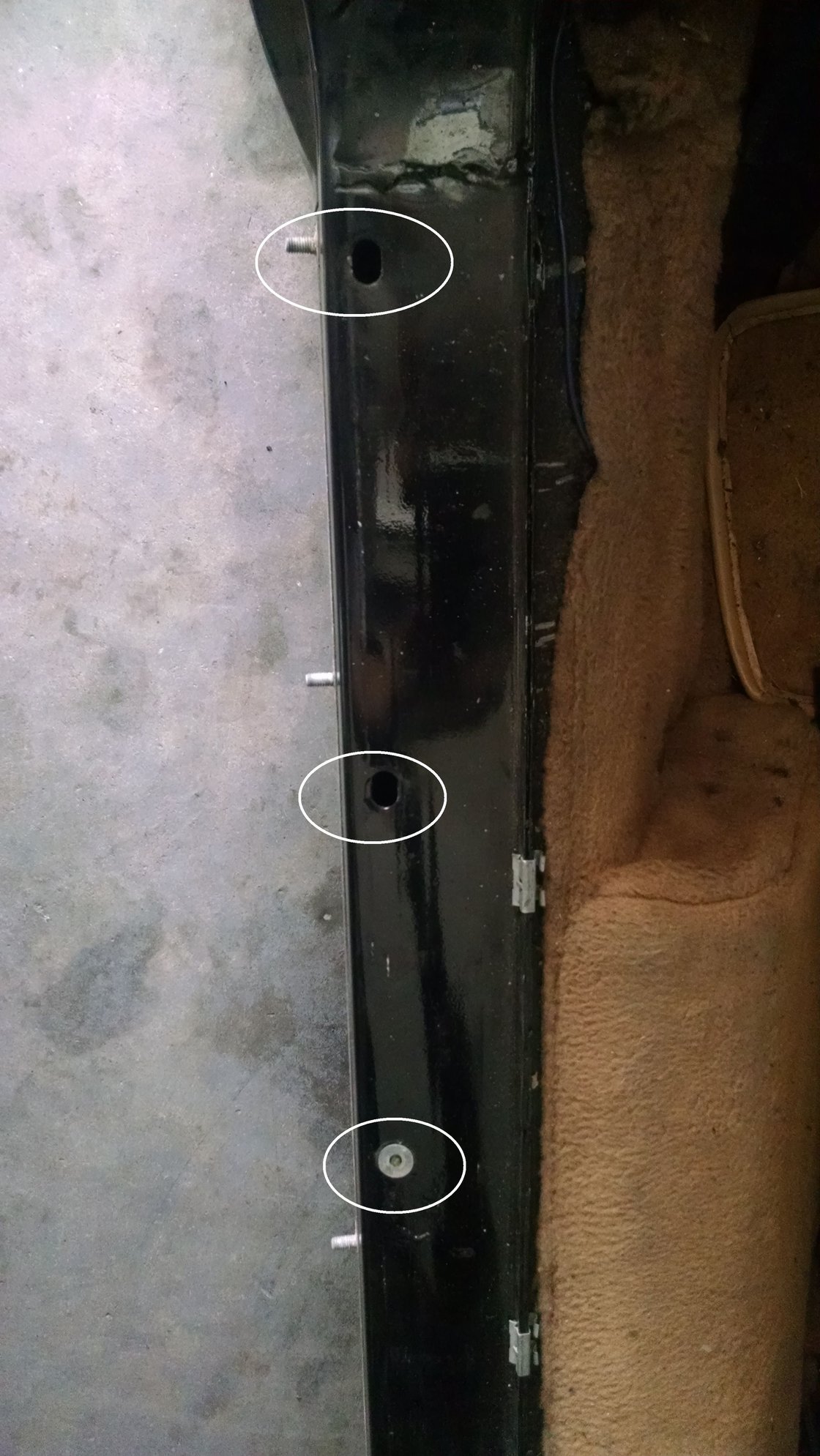

When I removed the door sill I was greeted with this:
I could not find the rubber grommets the white clips slip into in PET, Also, the white plastic bit is in need of replacement. And finally does white clip that secures the door sill aka protection plate in place come with the door sill or are available separately?
Thanks.

Black Door Sill Grommet 999 702 116 40
Cramp White - Sill - 12 needed 999 591 451 40
Clip Rivit - Sill 999 591 519 40
Plastic Grommet - Plastic 928 Nipple 999 702 115 40

Roger, can you get the 999 702 115 40 grommet? I'm seeing NLA everywhere.
Correct NLA.
We have 4 in stock

Cool, will get them from Mark and re-make them.

Originally Posted by Kevin in Atlanta
...And finally does white clip that secures the door sill aka protection plate in place come with the door sill or are available separately?
New door sills come with the white clips.

15 mm diameter, 13 mm high.

Got the grommet scanned, need to clean up the file and then will get some printed.

NOTE on the door sill the clear nipple is for the door sill number pin the other black nipples are bigger and hold the door sill clips.
For posterity i will add the removal instructions for the door sills.
Remove the center pin in the rivet at the rear of the door sill, pull out the rivet.
put a wedge under the # 2 of the 928 to lift the pin out of the nipple
Lift the inner edge of the door sill off the carpet about an inch .
Slide the door sill to the seat about 2 inches , this will let the outer pins come free of the door sill.
Turn the outer T clips 90 degrees,
they will pull free from the sill nipples
