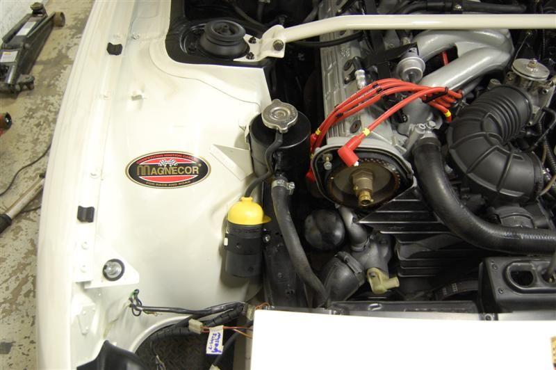

Yeah like this one I got cut welded and fitted where the Power steering reservoir normally goes...
R

that's the natural spot for it if you haven't got power steering...looks great.

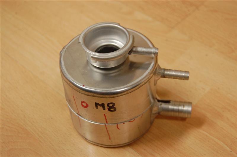

Wow thats gorgeous, can you get the same guy to make me one? How much did it cost you?
Are you in the UK?
It was originally a larger Header tank already made, which was cut to reduce the size, welded up then powdercoated.
R
Yeah I thought so !
That shot was the orig 2.5 Motor, here's the 2.7..
R
