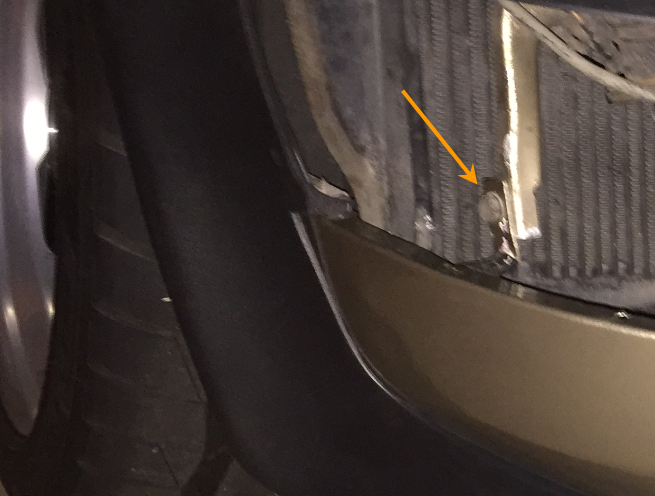

There are also two tabs with bolts on the far right and left. They would have been underneath the bumper bellows (accordion looking things). See pictures below.
When you put it back together, make sure to put the bumper on first. I go in this order - Bumper, bellows, lower valance. It helps to have the front wheels off too and the car up on jack stands. Much better access to everything - especially those two tabs.
