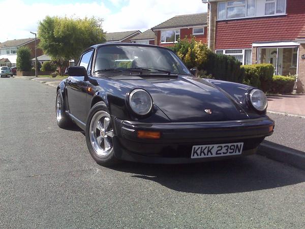

Pictures of the car would help. Do you have a chin spoiler on your car ? I imagine it is the Turbo tail is causing it on a narrow bodied car . it was not designed for that car at all , and if you have no chin spoiler it will make it even worse.

This was before the corner weighting and alignment, but otherwise she's the same.
I hadn't thought about the rear spoiler....

The turbo tail captures quite a bit more air than the Carrera tail which was designed for the narrow body cars but it does look like you have the chin spoiler so tha is good anyway.
You could always take the rear decklid right off and see what happnes for a run
