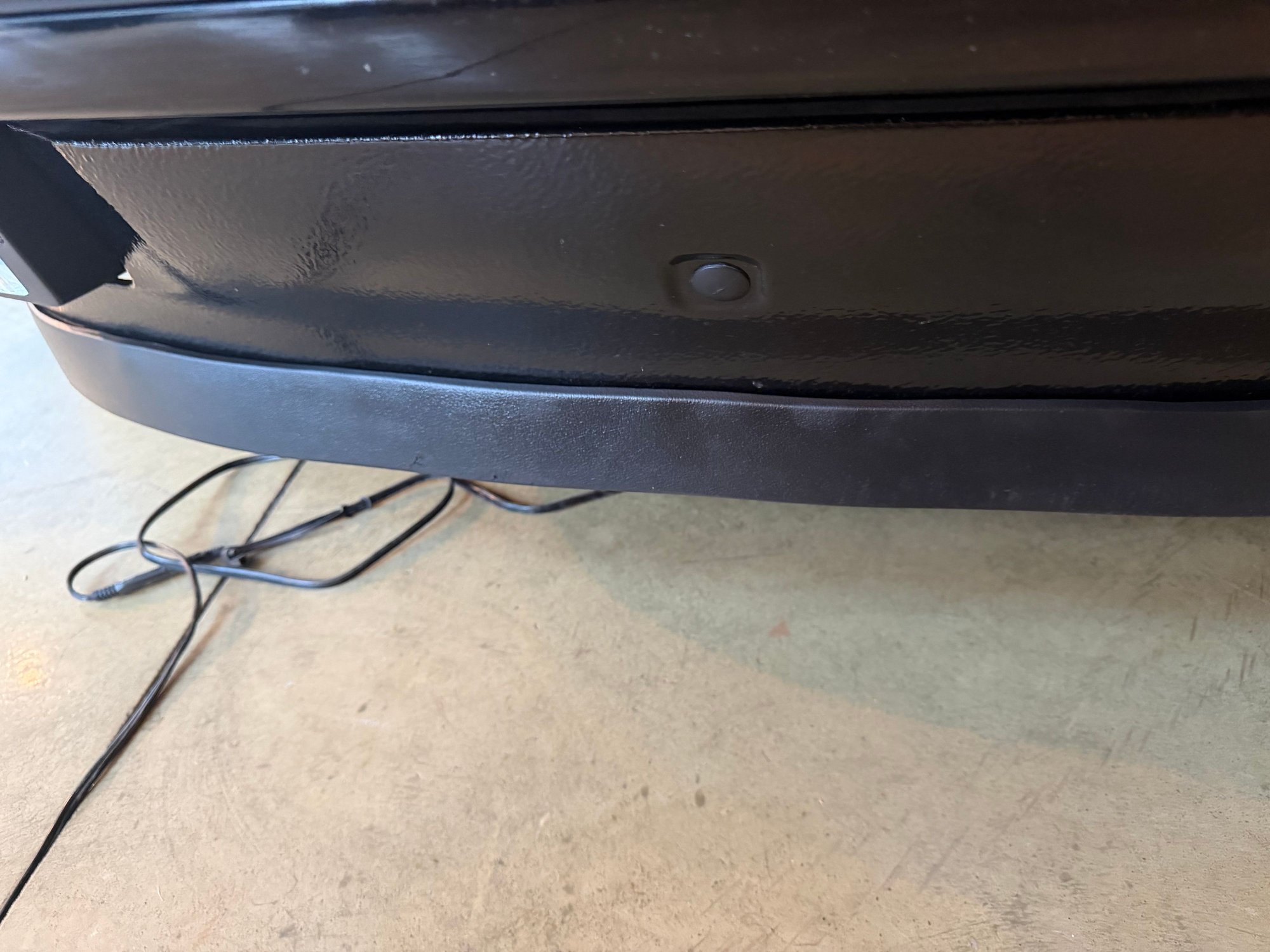

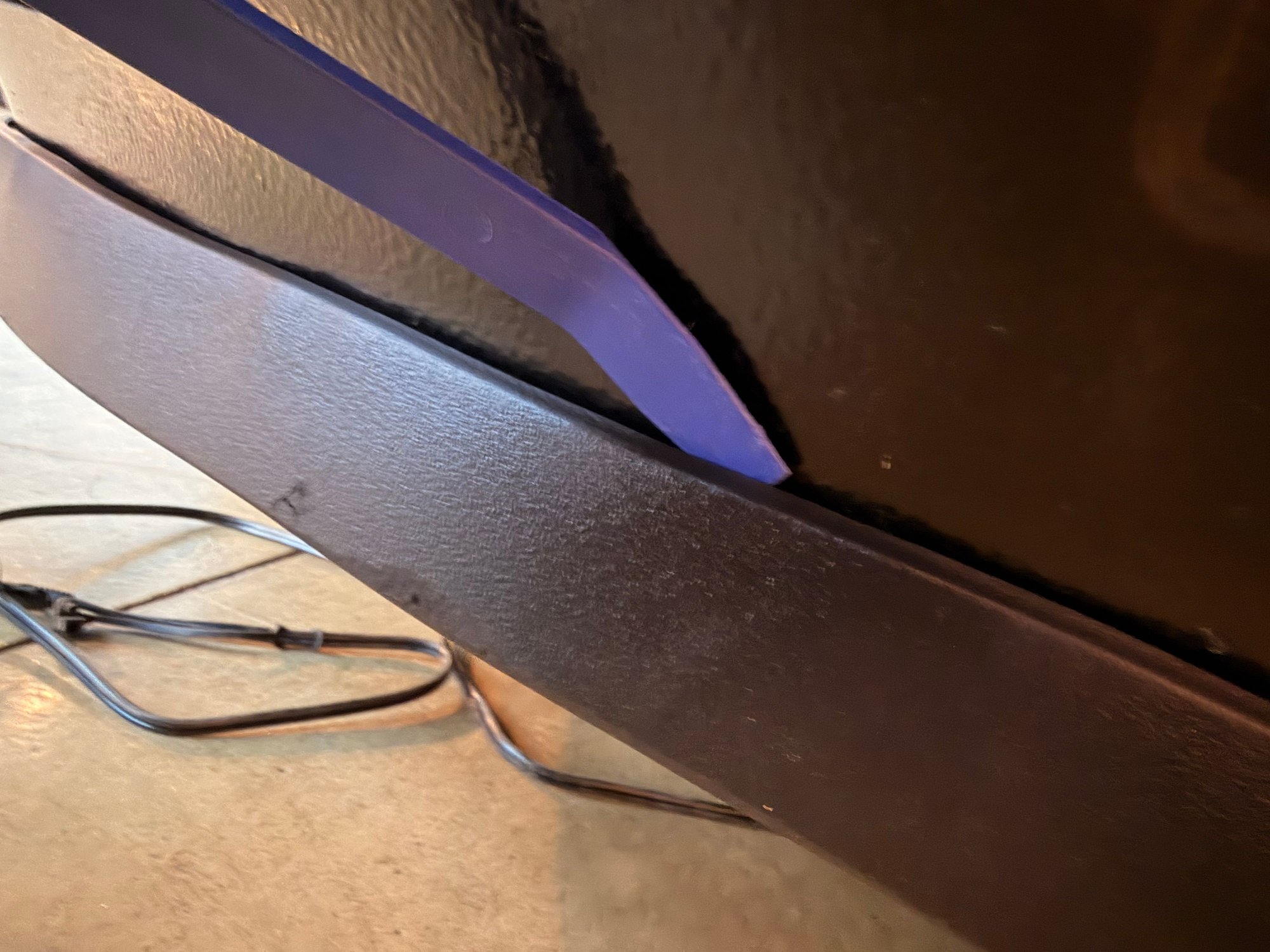

Ever since I've owned this (mostly original) 911, the chin spoiler has been a bit "wavy."
I finally decided to remove and inspect, fully expecting to see some sort of front valance damage as the root cause.
All OE fasteners were in place, and once I removed the spoiler, I could not find any sort of damage that could be causing the waviness.
There is also a couple mm gap between the spoiler and the valance. The fastener holes were tight and didn't allow any adjustment to pull it in closer.
Ideas?
Replacing on a whim is a bit expensive, just to find that a new one does the same thing.
Photos attached.

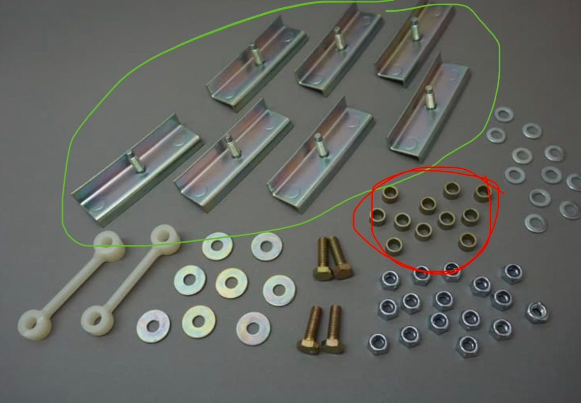

if I recall, the spoiler itself has oval holes to permit l/r adjustments, but once the OE metal “spacers” are used that slide over the threaded studs of the “plate bolts”, there’s not a lot of adjustment left over, even going left and right.
definitely no adjustment to pull it closer to valance.
Spacers circled in red in this photo, plate bolts in green.

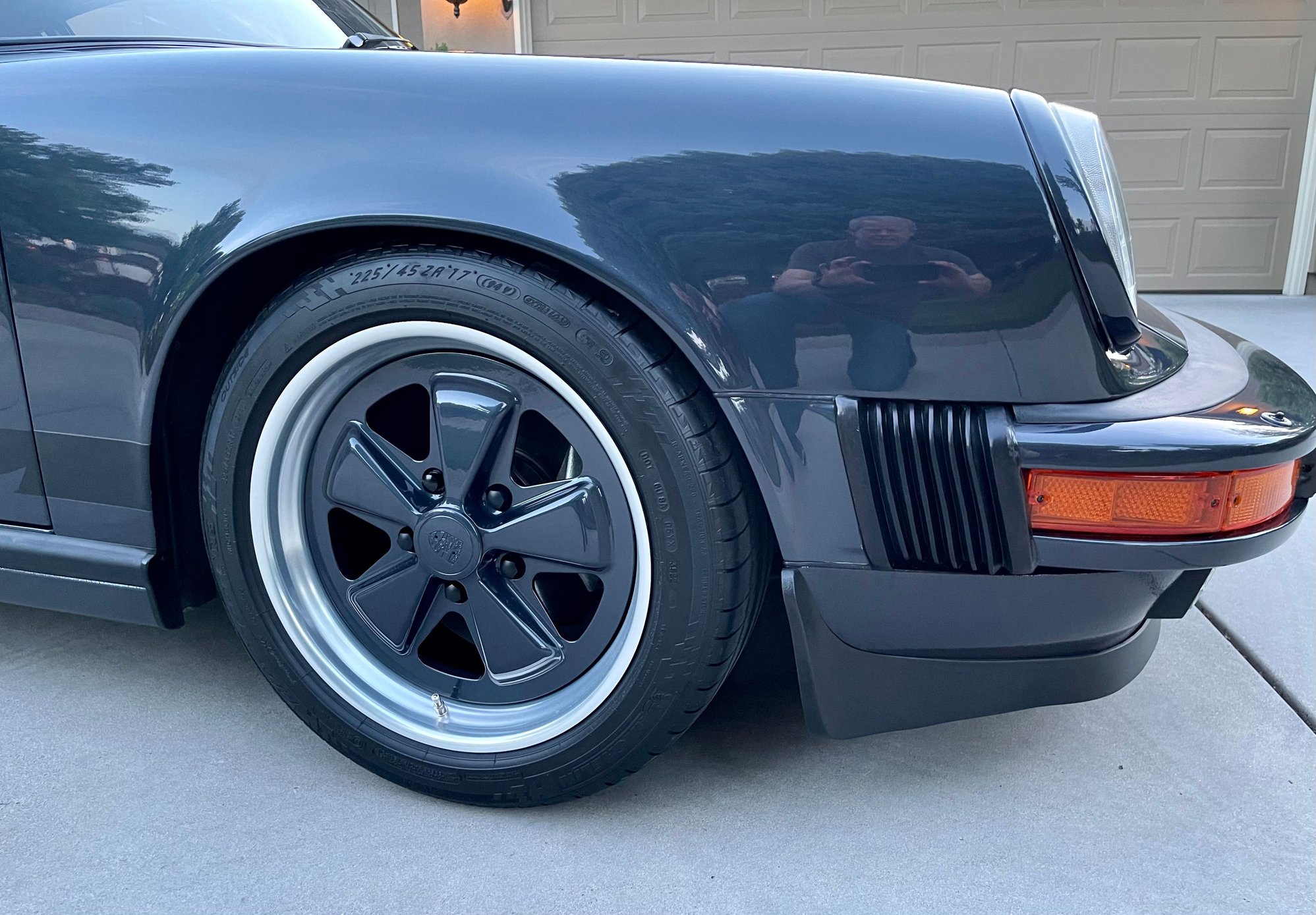

Fortunately this condition is not typical of these chin spoilers based on my experience seeing them. The one on my '88 Carrera has none of that. (Original to the car).

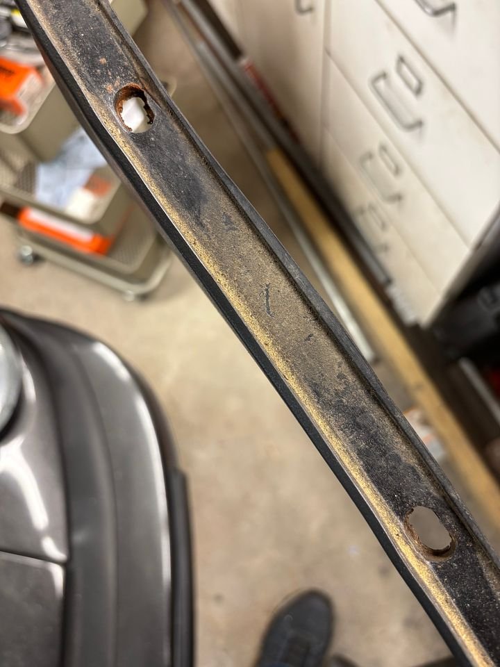

Here is a photo of my used chin spoiler awaiting installation. As TDS said, the oval holes only allow adjustment left/right. I had thought in/out was possible too. I haven't purchased the hardware kit yet, but I can see how those little cylindrical spacers cut down on how much you can adjust things as well.
Mark

Well, I may be getting closer to a solution here.
I decided to take another look-see at the spoiler today and discovered, lo and behold, that none of my stud plates actually have the spacers!
Only the 10mm bolts near the ends have the spacers. My memory ain’t so good these days, apparently.
So the stud plates aren’t holding the spoiler exactly where it should be with this extra gap around the studs, and they are “squishing” the spoiler more than they should be when tight.
91150334900 for the spacers. Ordering some tomorrow from my local dealer and will report back.
