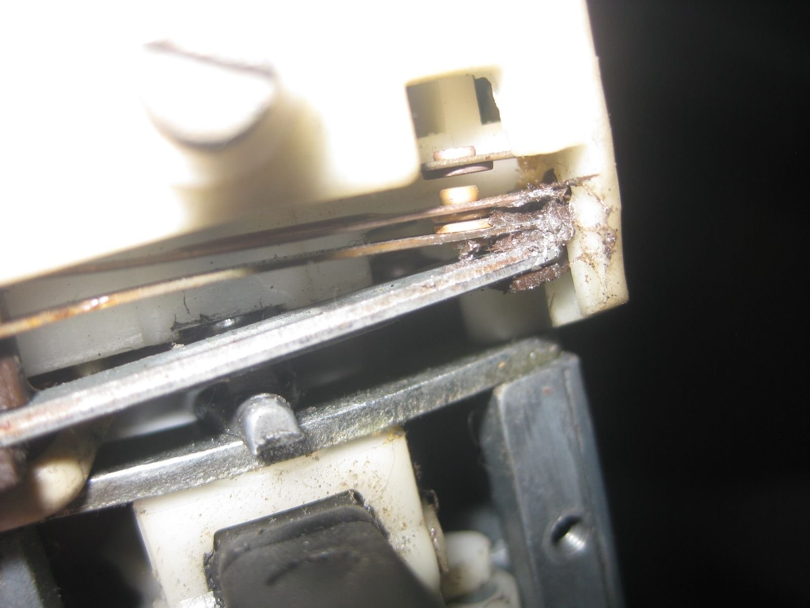

The relays are original to the car. I have not installed the after market fix.
See picture that I just discovered. Maybe this shouldn't be stuff together like this?
Also I have an electrical diagram and it shows the White/Black wire coming off a separate hot than the White/Red which is hot.
