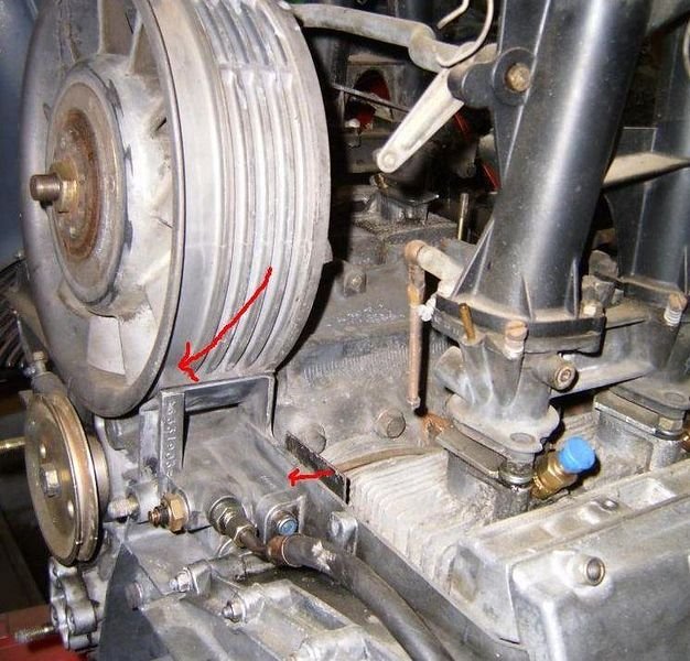

What is your engine number and type stamp.
It’s on the case, near the temp sensor near the fan. You see if from decklid open not under car.
those will tell you what is in the car

This image (borrowed from Pelican) will help you find the engine type and serial numbers. The type number is on the horizontal part of the case, the serial number on the vertical part of the case next to the fan.
To add a bit to the confusion, in 1975 Europe got a base 911 (150 hp) and the 911S (175 hp, engine 911/42). In 1976, Europe only had a single 911 model with engine 911/81 (165 hp). The US cars were all called 911S, but they were the same HP as the Euro cars (except California, which had more emissions gear added that cost some power).

Hi, thanks for this, even taking the time to include a photo of the locations where to find the numbers. Super. I did know my engine no and where to locate it, but never saw the type stamp (with its really tiny letters...
A bit wiser again...! The stamp says 911/81.
