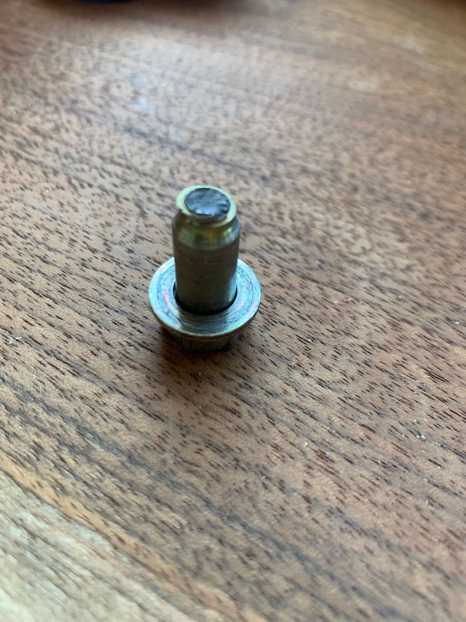

Hi folks,
I was trying to remove my Wevo G50 PSJ and unfortunately the bolt broke on me (see pictures).
One piece of the bolt is stuck in the shift tube - what's the best way to get it out without damaging the shift tube?

try a left hand drill bit first
Ya was going to suggest same... damn pita!

Wish me luck, thus far I still wasn't able to extract the bolt.
I have a couple follow-up questions for you all:
- what's the official part name where the bolt is currently stuck in? "gear shift rod"?
- if I were to damage this part, what would be involved to replace it? Would I need to drop the transmission?
