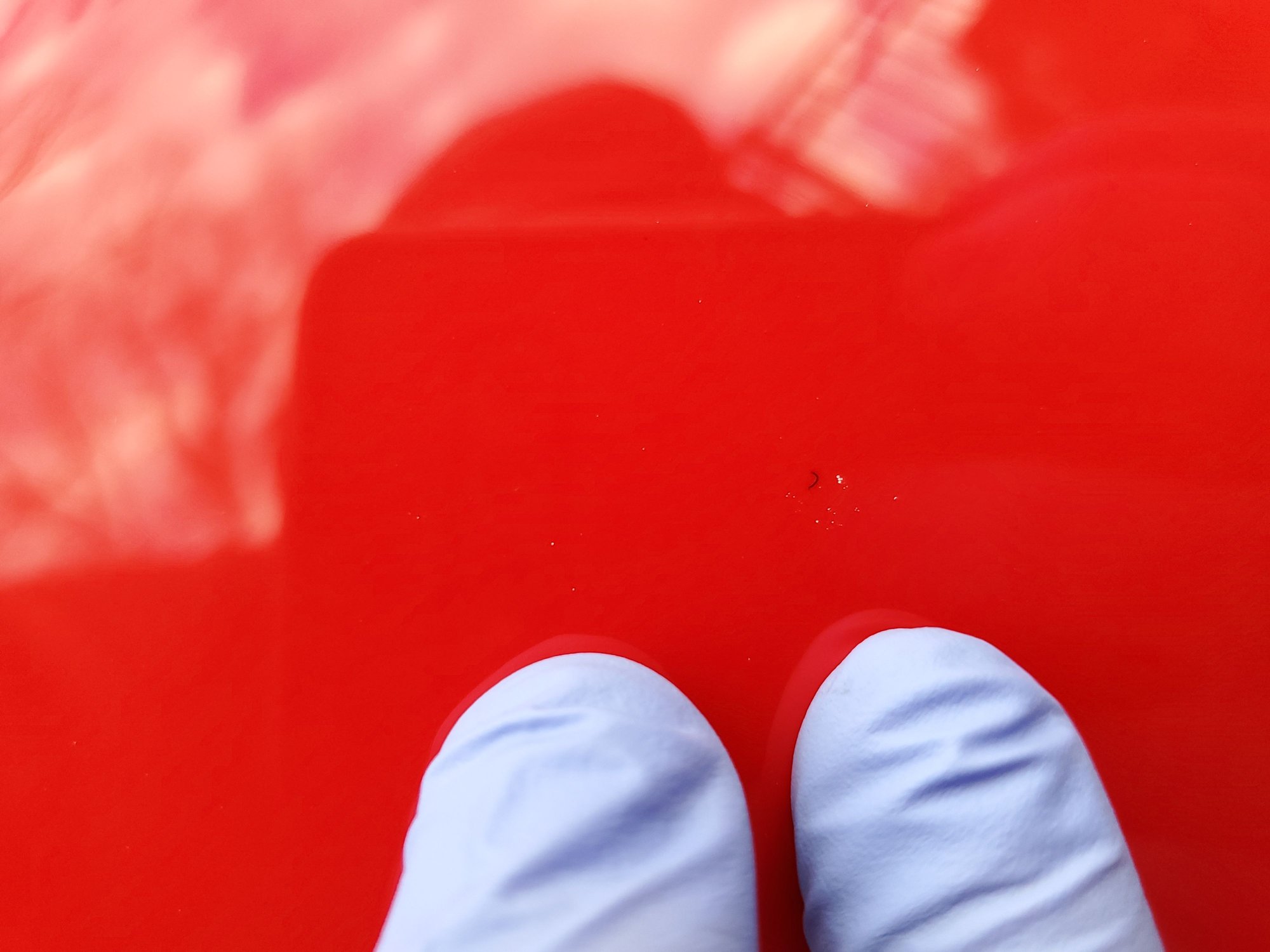

Insurance approved shops were not Porsche certified. The car is still under warranty, then has another 2 years CPO after that, so I didn't want to risk messing with that. The shops local owners recommended were also not on the insurance preferred list.
Went over the car while washing and found 30+ black/white flecks and divots in the resprayed areas. Plus hard white residue at the edges of the resprayed area, white residue in the gaps between parts, and likely overspray on the passenger side mirror housing and window trim. I had hoped that the paintwork would at least be exceptional, but the entire result looks like it's sloppy.

And this mob was Porsche certified? This is an absolute hack job. If the shop doesn't want to take any responsibility, I'd have my lawyer send a letter of demand. It might be enough to have them come to the party with some form of rectification or compensation. If they still don't want to come to the party, well you can take them to court, or cop it on the chin and move on.

All of these deficiencies can be repaired, go back to the shop and give them the opportunity to make it right with the understanding if they don't get it corrected you will take it to another shop for corrective repairs and will pursue them for the bill. Once you have given them the opportunity to make it right you will have reason and recourse to go after them for the bill.
