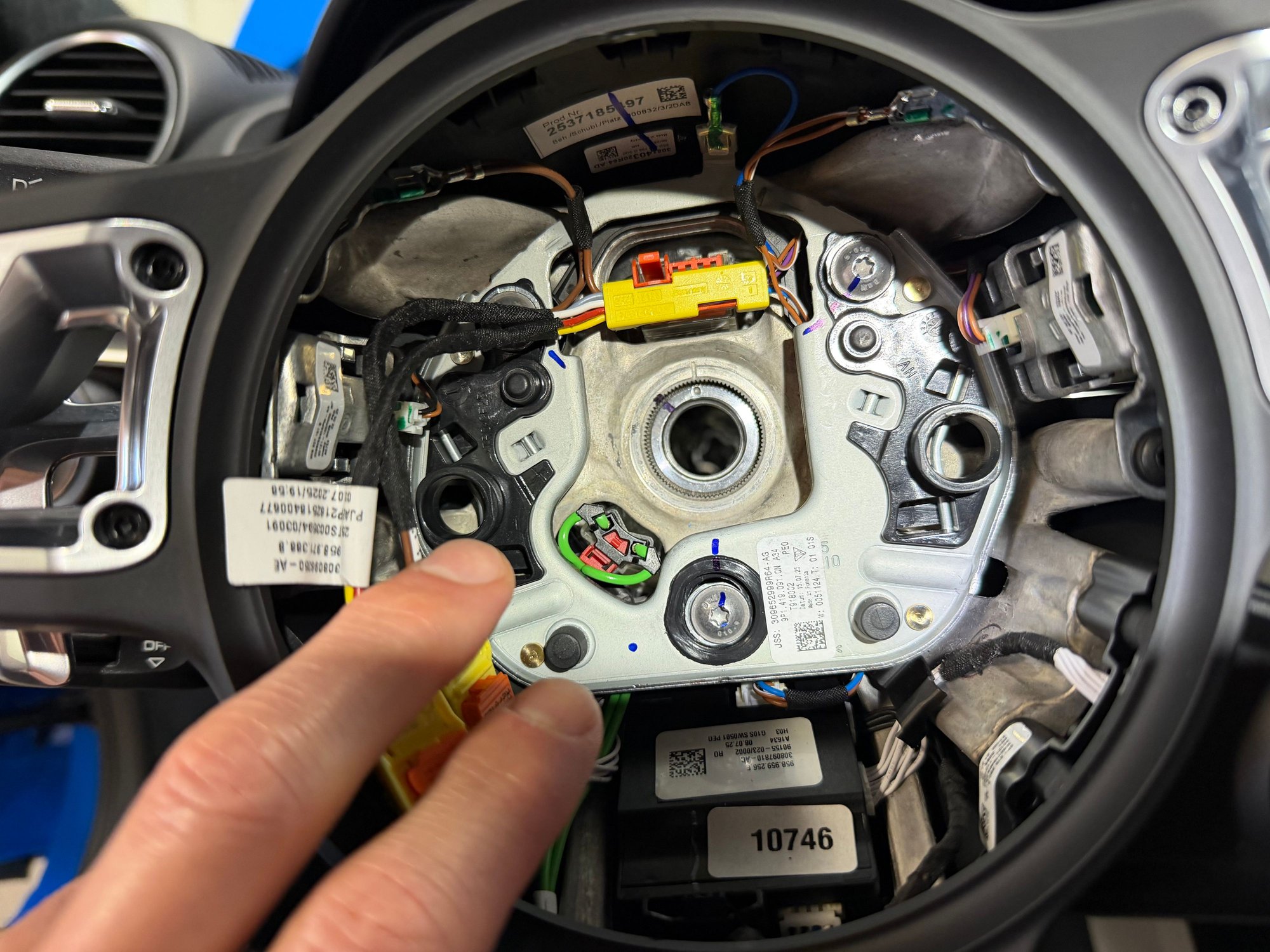

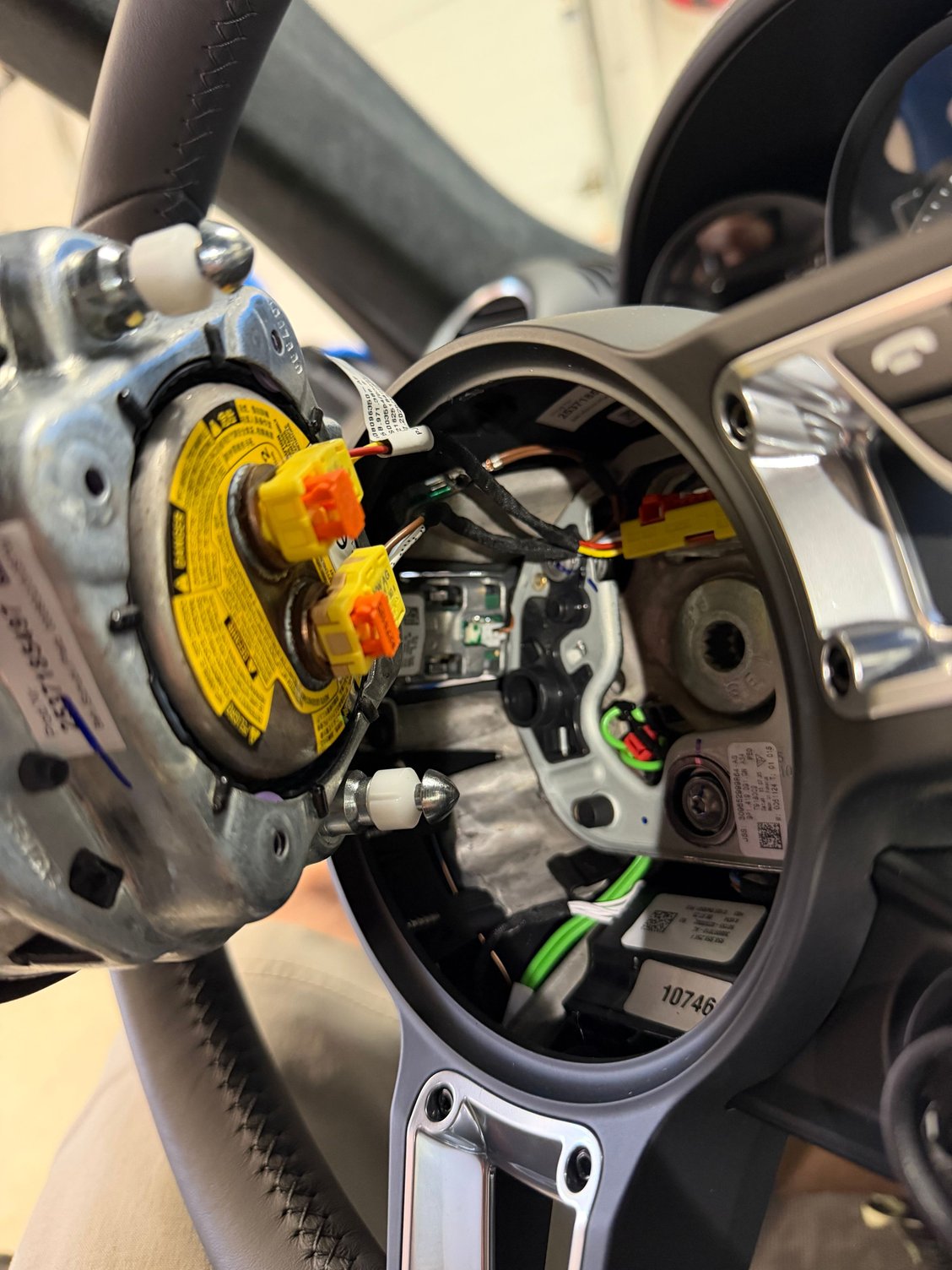

3. Stick T25 torx in 2 side holes of steering wheel and release mechanism holding in the airbag. Pull slightly on airbag while pushing with torx driver.
4. Pull the airbag out and disconnect the 2 connectors using the small screwdriver. Pay attention to where the airbag wires are routed so for install you can put them back in the same place.
4. Will need M12 bit to unscrew steering wheel nut.
5. Verify that there is a mark that says how to align the steering wheel. Maybe also use a sharpie. Take a picture.
6. Unplug plug on top of inside of wheel.
7. Take steering wheel off.

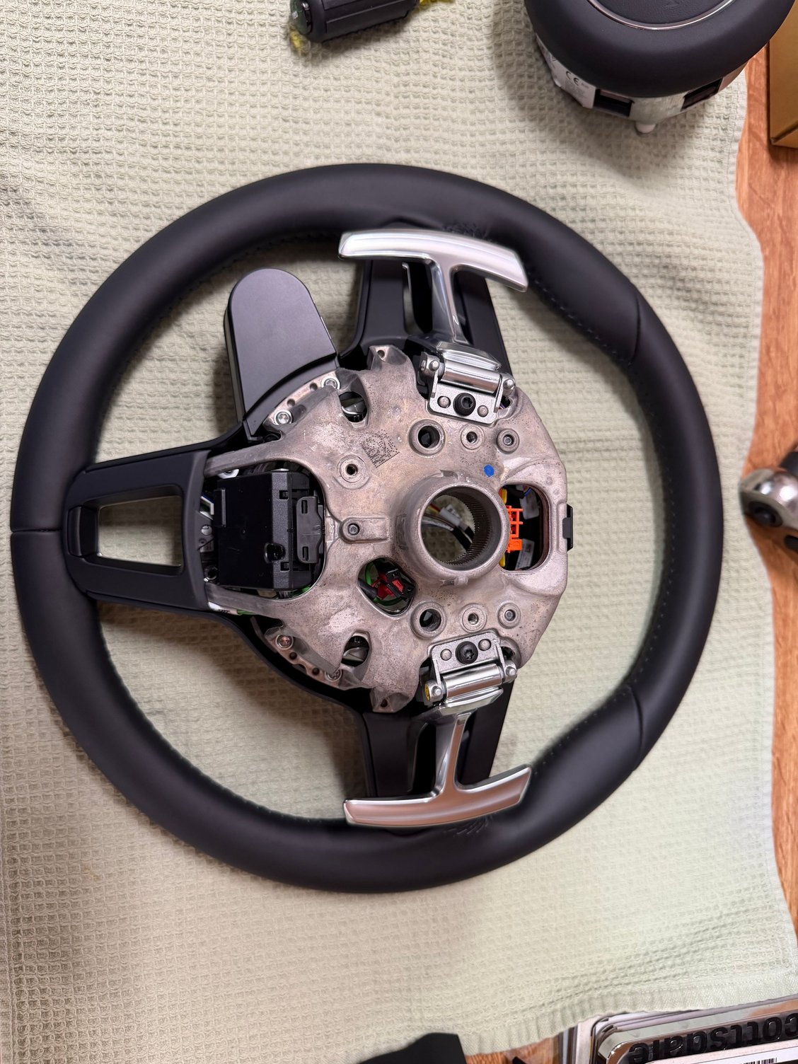

8 Remove back plastic cover (3 screws) of steering wheel using torx 20.
9. Disconnect plugs going to the paddles.
10. Unscrew the screw holding the paddles in using torx 20. There is 1 screw for each paddle.
11. Put madtrace paddle in. It helps to pop the plastic piece (behind the steering wheel buttons) up a bit and then push the mad trace in.
12. Adjust paddles to where you would like them and tighten the adjustment screws. I added a dab of blue loctite.
13. Screw in the 2 paddle screws.
14. Flip wheel over and plug in the paddles
15. Make sure paddles are where you want them one more time.
