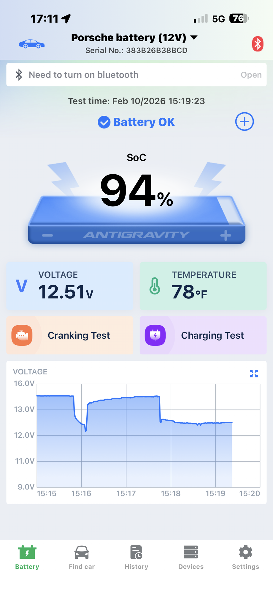

I have a TrackerPlus battery monitor on my ‘25CS and one reason I got it was to measure any voltage drop due to a wireless CarPlay adapter that “seems” to be active…a lot….all the time….unsure.
anywho I left my car at the airport last week and voltage dropped from 12.64 to 12.36. It was pretty cool…around 40-45
Normal?
daily driver so it seldom sits for a week.

It's not too big a drop. Lots of electronics on these cars and a slight drop should be expected. If your carplay adapter is potentially a concern then just unplug it if you plan on leaving the car for long periods.

yep...that's the next step in the test...unplug the adapter when i'm out for a week

Very useful. here’s this home screen on my app for today. I got home a couple hours ago. And the number seemed to line up with what your table shows.

Don't go by the State of Charge % as your main data point. Voltage is the most accurate because state of charge is based on an equation and voltage is the true accuracy because it is a hard data point. We put the state of charge in as a way to give a "relative" level of charge because most people (understandably) don't know what voltage is considered a good state of charge. So always go by the voltage reading. Also reviewing the Historical data is a super good way to review how your car is charging the battery and how fast you battery is discharging over a period of time which will indicate if you have a fast parastic draw. Another good data point is you Voltage drop during starting, that can indicate if you battery is still providing a solid voltage during the high amp discharge of starting.
For BobCooper , you didn't say how long you lefft you Car at the airport, but if it was for a week with a .3 tenths discharge that is actually OK for a week with a Car Play adapter connected that might be active.

Thanks for the feedback and really like the product. The car was at the airport for pretty much one week. So good to know that voltage drop was not “out of the norm”.
