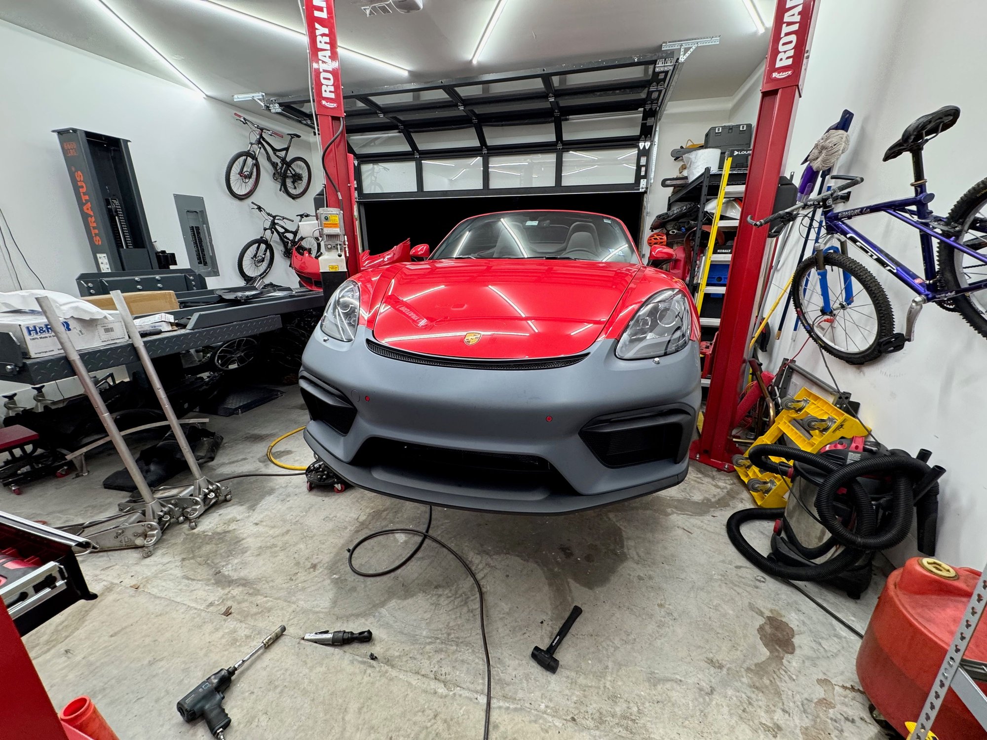

The GT4 bumper (from Flat 6) got painted and mounted OK. However, there are no holes nor brackets for the front parking sensors on the gt4 bumper.
This is causing all kinds of problems such as the rear bumper sensor showing an error on reverse and the roof parking sensor light keeps flashing.

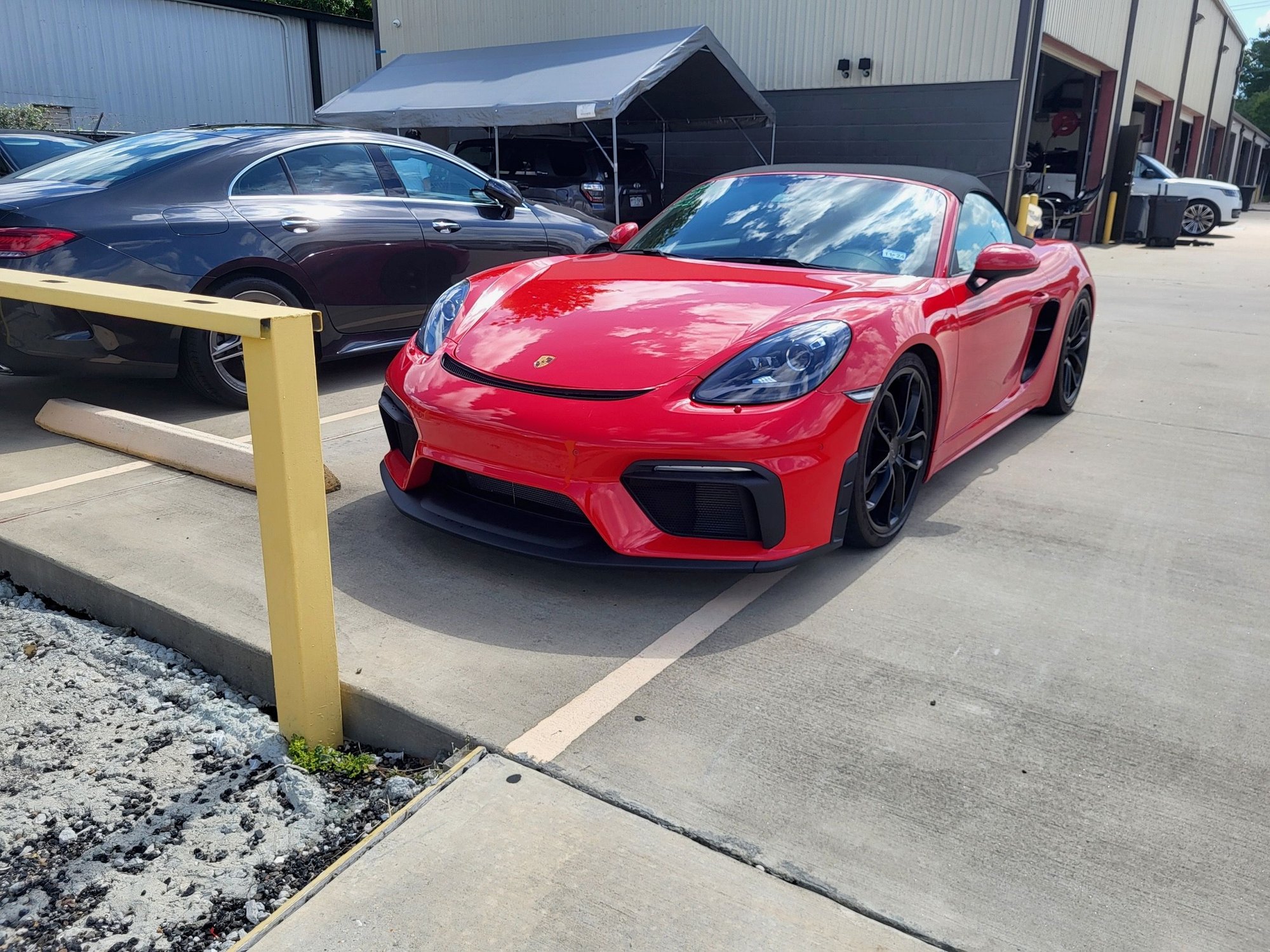

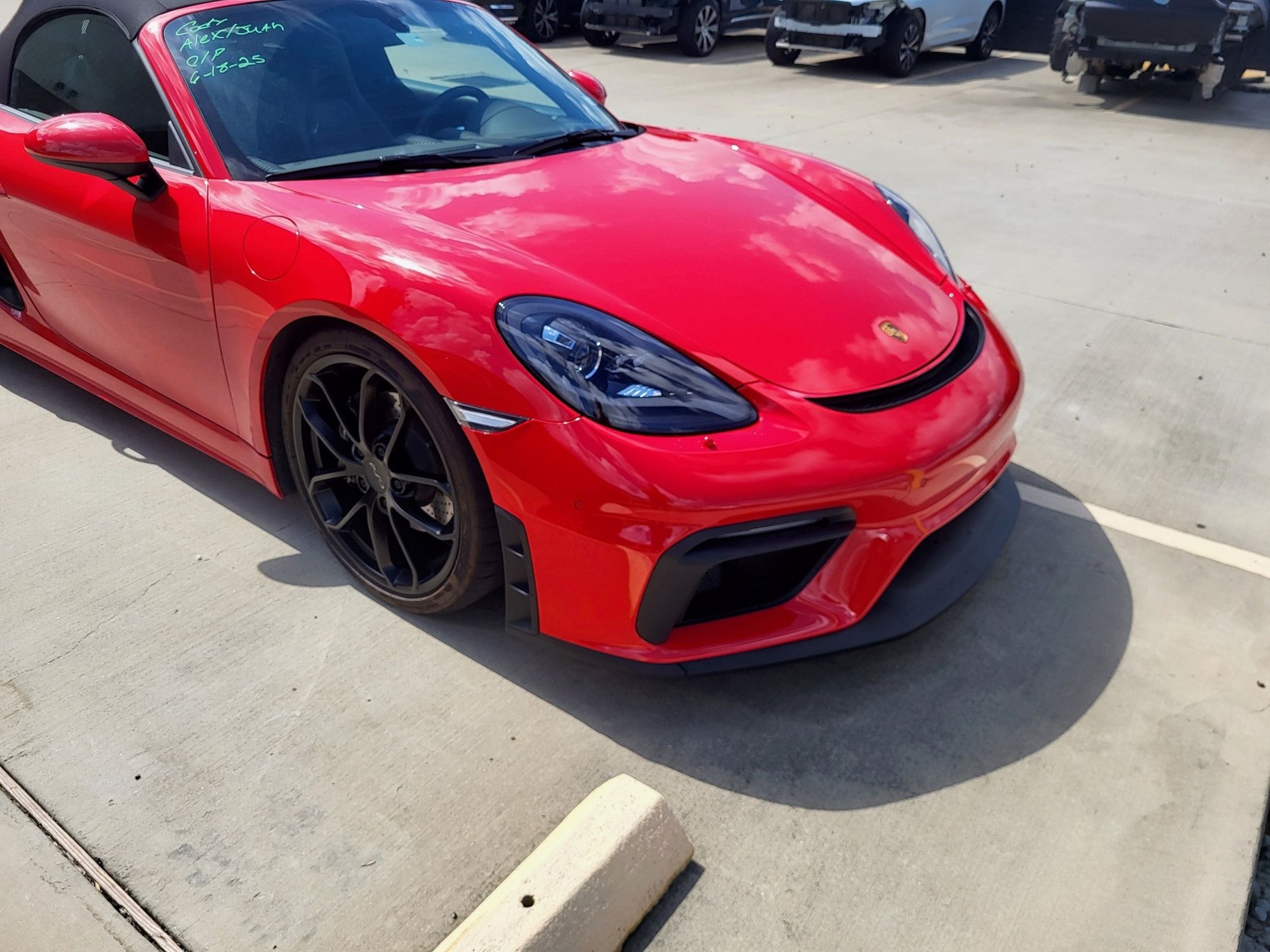

You probably can code it out with a PIWIS or Launch X431. My bumper kit came from Bayson and included front sensor brackets. I swapped over the sensors from the factory bumper

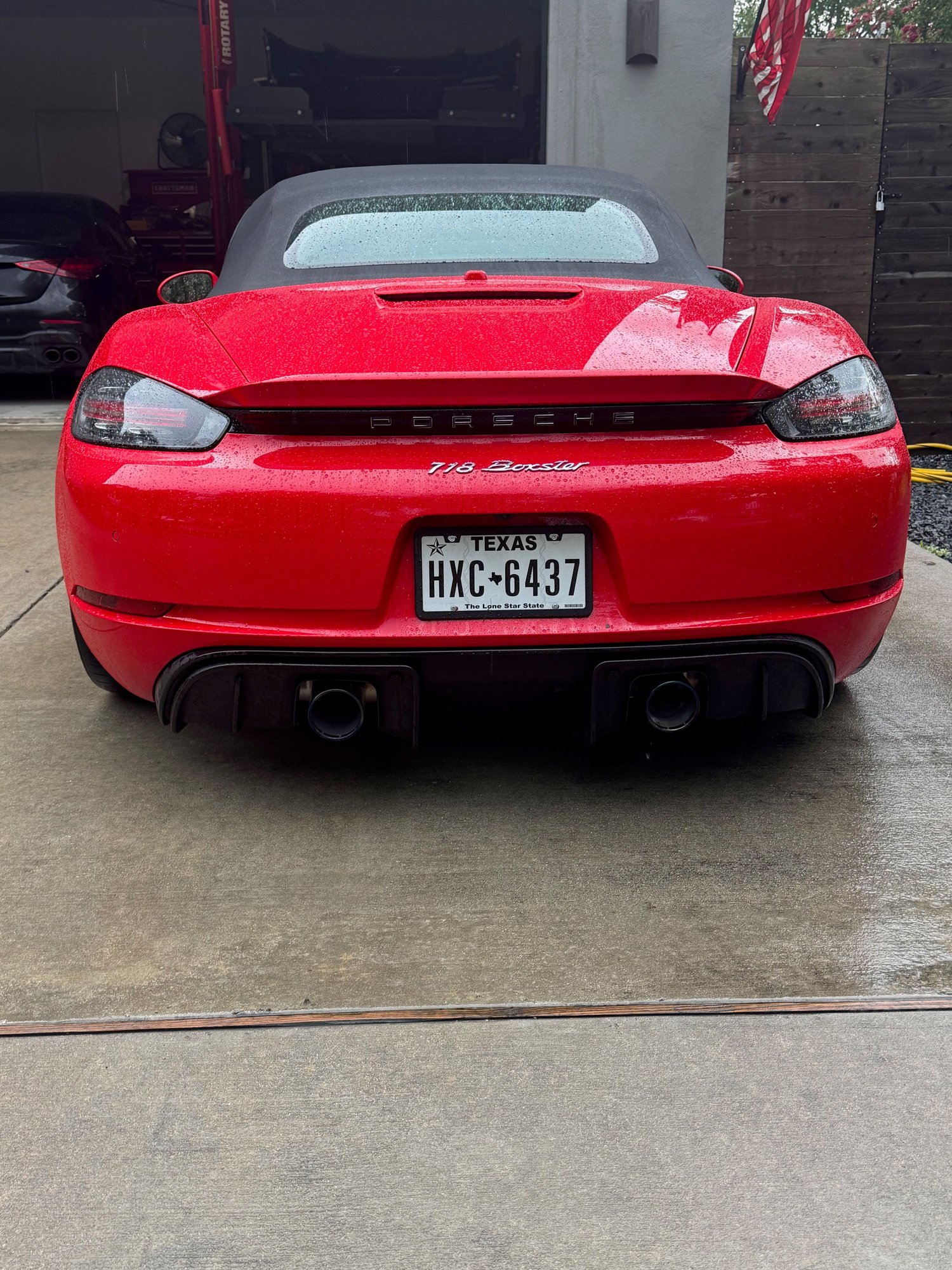

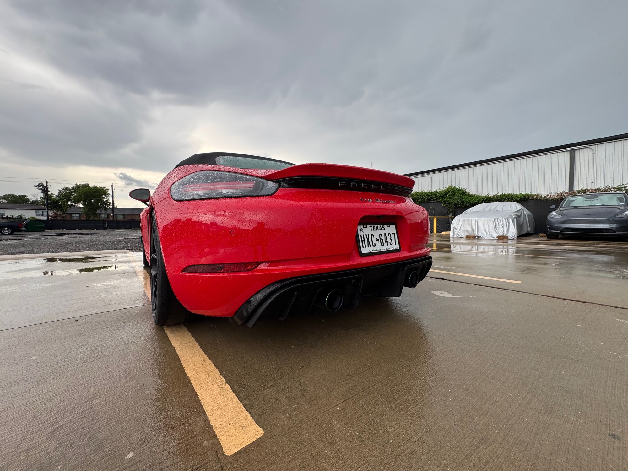

Originally Posted by 718Mick
Wait what? You put a what where? Pics?
Old Nov 19, 2025 | 02:09 PM

Its the Spyder/GT4 front end and I added the Spyder ducktail
