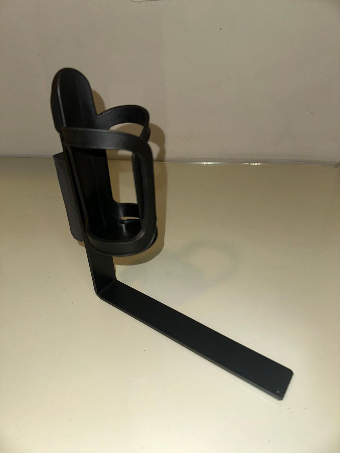

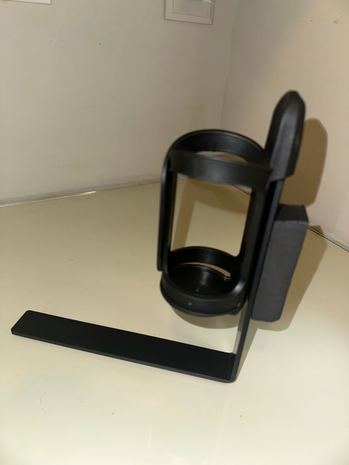

After researching the current options and finding nothing that met my needs (except the unattainable ultimate cup holder), I decided to make my own for my MY2025 718 Cayman. It took some trial and error, but it’s finally a finished product. 🙌
It consists of a bicycle bottle holder & an aluminum bracket only a few millimeters thick that is placed under the floor mat. I attached foam weatherstripping on the vertical part of the bracket in order to stabilize it against the center console carpet. So far I’m really liking it.
Let me know your thoughts.

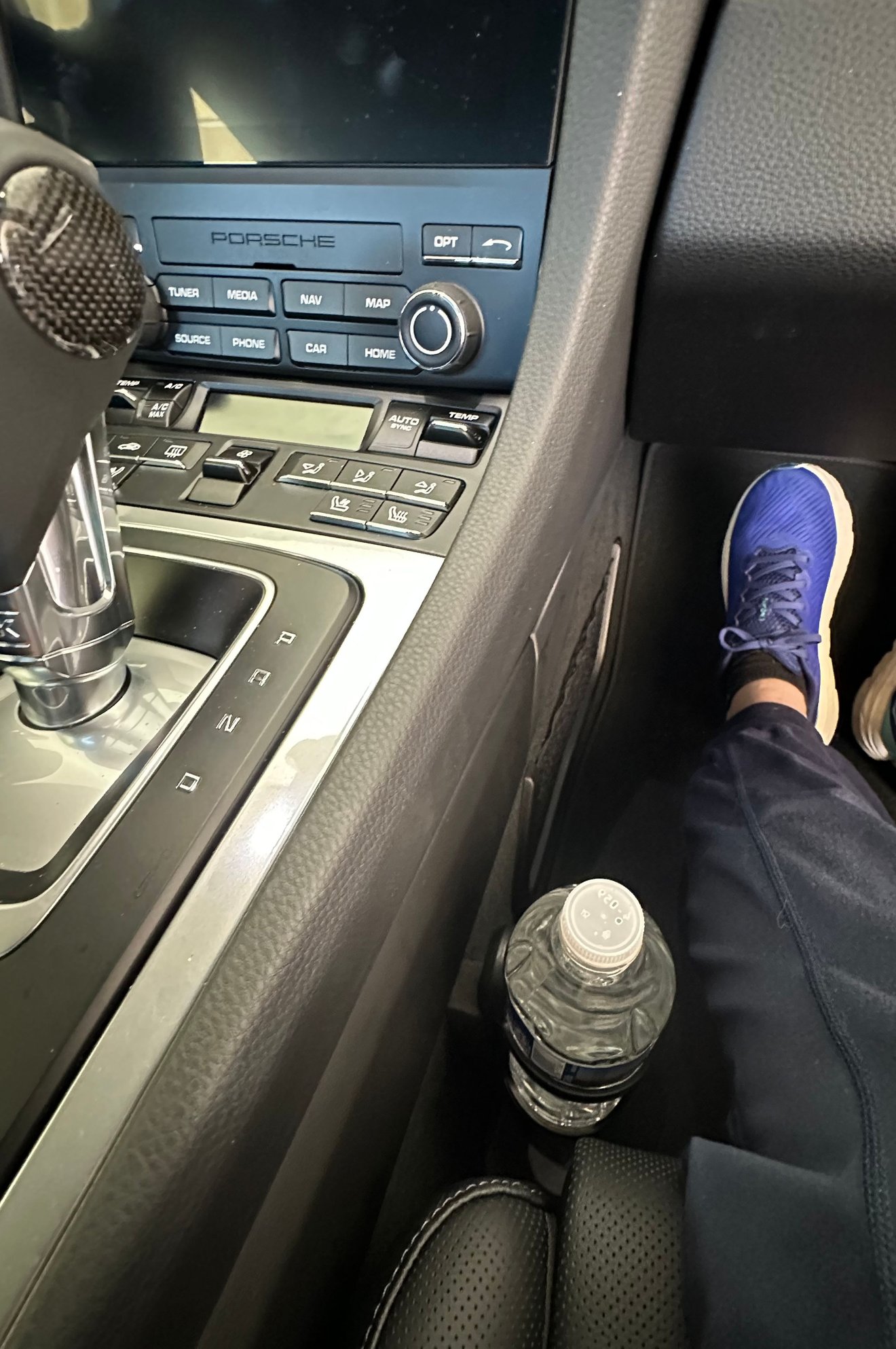

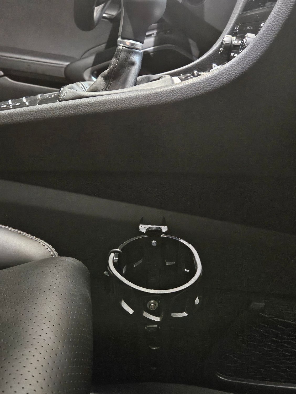

These are the only pictures I have right now but did something similar using this
bracket bracket
and
bottle holder bottle holder
. Very simple to make yourself. It is still crude looking with the duct tape and zip tie but I also added a small piece of metal I had on hand that is perpendicular to the shelf bracket under the floor mat to lend a bit of braking /acceleration stability.
The adjustable bottle holder gives some flexibility for size and conveniently came with the little piece KariAnn added (that is intended to go on the bicycle down tube) to brace it against the side.
